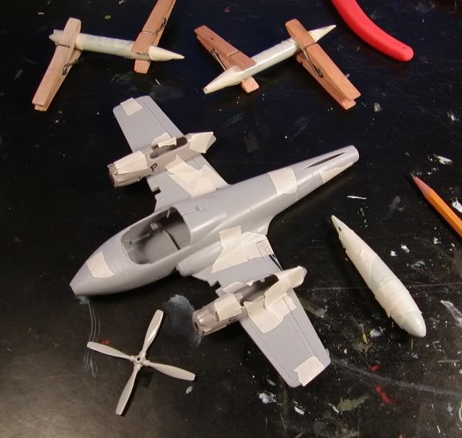

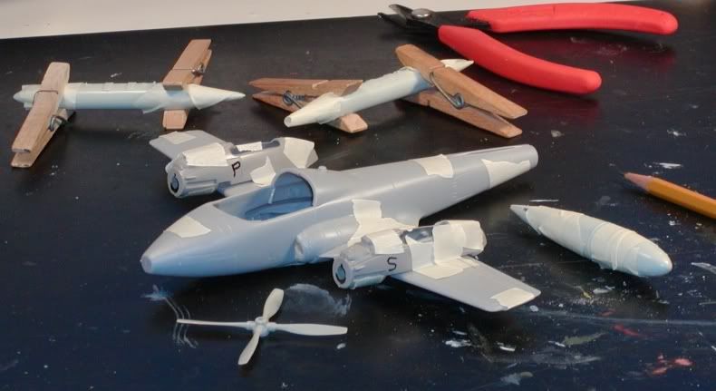

Initial mock-up, while needing a lot of work, shows some promise.  Tailfins have been cut off.  They will be replaced with scratchbuilt (longer chord/taller) version.
Inverted engine nacelles from a 1:72 Matchbox Mossie.
Trying to elongate the tail with a cut-off from ordnance.  Prop blades will be modified from couple of Tamiya Raiden kits (which will in turn be turned into jets). Prop-spinner-cones will come from F-84F fueltank cut-offs.
The wings will be altered quite a bit yet: wider chord, longer wingspan, and will have the distinctive dihedral bend that the Pucara has.
Need to put something suitable under the wings/engine nacelles to form the wheel wells like on the Pucara.
Lots of work ahead.  But I have a paint scheme in mind and that will keep me going.

Looking good Barry, I'd lengthen the fuselage, but that's just me!

QuoteLooking good Barry, I'd lengthen the fuselage, but that's just me!
Thanks, fellas.
Yes, Ollie hit the nail on the head.  As noted, I plan to lengthen the tail by about 4 scale feet but it would look more believable if I could lengthen the entire fuselage.
Unfortunately, there is no way to insert a simple plug to extend a tapered shape (unless you're willing to suddenly have an inappropriate "flat/parallel" part) and I do not know how to otherwise extend a tapered shape unless one completely rebuilds an entirely new fuselage.
Ideas???  Tips???
