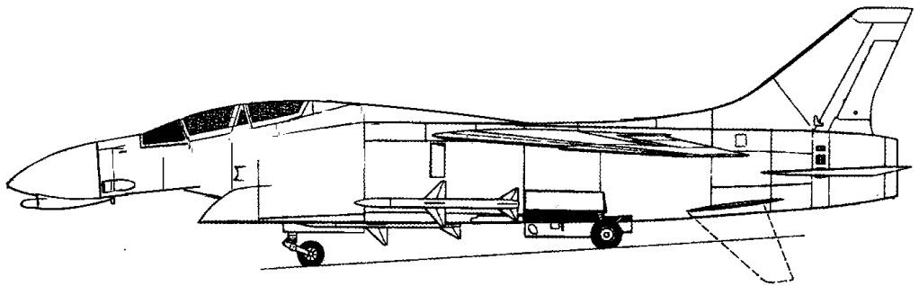

What if Vought offered a 2 seat version of the Super Crusader with bigger radar?
Yep, it's crude, but you get the idea.
I didn't think the Super-Crusader could be made any more ugly.   I was wrong!   :o :o

I was thinking in regards to something posted on ElectrikBlue's "Blue-Sky Oddities" thread.  It was based on an actual A-7 concept (a supersonic A-7 variant) that had a lot of characteristics in common with the F8U-3
Link URL:  http://www.whatifmodelers.com/index.php/topic,22165.975.html
Image URL:  http://i703.photobucket.com/albums/ww37/jmsfbip/A-7U-3-variants.png
Regardless, the uppermost image lengthened back up to the F8U-3's size looks like it would make a great "Super-Twosader".  When Chance Vought proposed a twin-seated F8U-3; they found that it would require an increase in wing-area of 27-square feet, a gross-weight increase of 1,157 pounds, around 1,820 pounds when at gross-weight, an 9 square-foot increase in vertical fin area, 6-square feet on the ventrals, and an addition of 59 gallons of fuel.  Regardless, that design didn't have a cockpit configuration than this concept and there may have been some fuselage differences which I'm not sure what effect it would have; additionally if the plane was designed from the get-go as a twin-seater; it's possible that they would have been able to save weight this way than modifying an already extant design.  The projected length increase was 50 inches, I don't know what difference there would be in this particular case, but it's possible it might be a little more because of the raised canopy; the F-4 ended up growing two feet when the canopy was raised.
As for the radar, the APQ-74 could have been fitted with a 34-inch antenna over a 24-inch antenna; with the radar antenna mounted further aft in the nose, and the electronics moved further aft in the fuselage in order to avoid excess equipment in the nose (It did cause a reduction in fuel to do it however)
