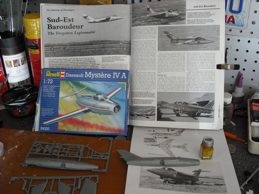

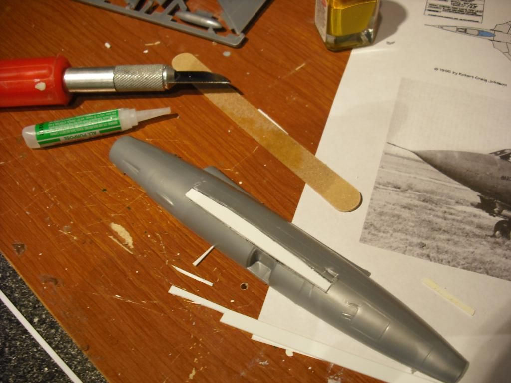

The concept- build a better Baroudeur.  I believe there is a very old limited run kit of the Baroudeur out there somewhere, but I am taking a different approach.
The victim, 1/72 Revell Mystere IV, close in overall shape and has the right French 1950's look. Will take some surgery.
Overall shot of the kit and references, and shows that the Baroudeur 5000 was indeed a real aircraft.  My main reference is Wings of Fame, Volume II, Aerospace Publishing 1996.

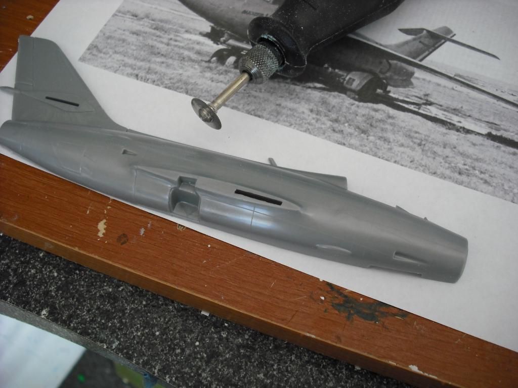

Low wing on the Mystere IV.  Will have to cut out the wing/fuselage root, cover it up and move the wing to a higher shoulder position.
Roots cut out.  Backed with styrene.  Putty next.
Belly shot.  Cut wells for the skis.  Skis retract for high speed flight and lay flush. Previous root locations blanked off and filled with putty.

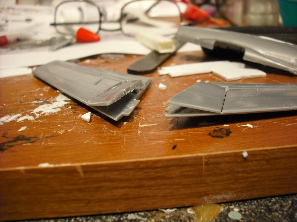

Need to open up the wings to create root mounted intakes.  Tried vampire intakes, but too small. Temped to sacrifice a hunter, but decided to use styrene.
Intakes shaping up.

Interesting project. And the step-by-step photos are useful too, thanks.

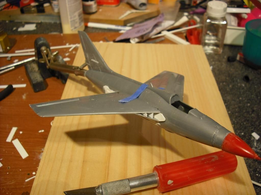

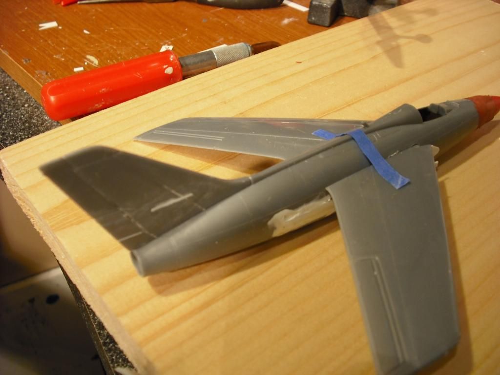

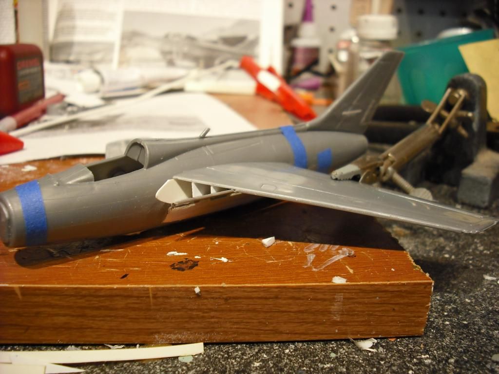

Thank you all.  Wings about done, still need some intake work.
Some nose work, with A Red Arrows Hawk providing the pointy end.  Needs some sculpting to get the shape down a bit.
Moving the horizontal stab up the on the tail.  Blanked off the original mounting slot, had to scribe off heavy hinge plates.
