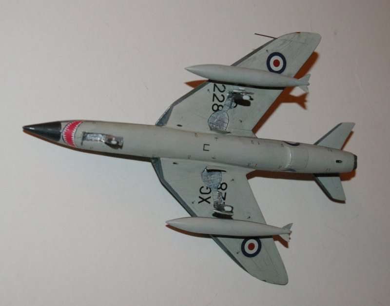

Whoever it was at the Air Ministry who decided that Hunters would have their underwing serial nos. painted ACROSS the landing gear doors should be SHOT!
a] It must have been darn near impossible to paint the nos. with the gear extended in service and
b] It makes applying the decals on a model a right pain!
I'm painting up the wheels, gear and the tanks now and that should see it done, hopefully before the end of the year.
I suspect, Kit that on the real aircraft they put it up on jacks and raised the under carriage to make the painting easier.
On models, I use a tiny bit of blu-tac and hold the undercarriage doors closed, apply the decals, future them and then carefully cut the decals and remove the doors and attach the undercarriage.  It's a paid in the bum but it's the only way I can think of doing it.    :banghead:
Revell kindly print dotted lines on the serials where you're meant to cut it into various bits, and I think you end up with SIX of them for every decal! But some of the bits end up with just a fraction of a letter or number on them, and I'm darned if they'll be visible on the finished model.
1) No, on real aircraft, they put the aircraft upright to make the painter's job easier.  ;D
2) Thanks for a very good tip.

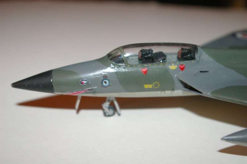

I've gone through my vast decal collection looking for sharkmouths and I've come up with five to work with. The Heller 112 Sqdn. Vampire looks a good start as the T12's nose is quite small in diameter where the decal will fit and I've done some graphics work on a scan of the decal.

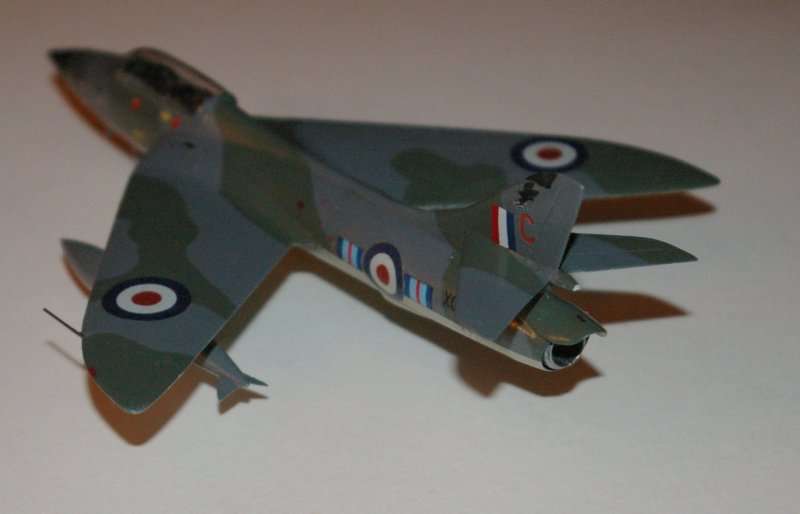

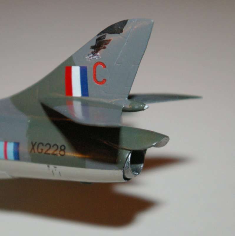

The T12 is actually finished now, the very complex landing gear is all installed (8 pieces per side, for goodness sake!) the tanks are painted, decaled and loaded under the wings, I've added a pitot to the port wing, RE-done one of decals that got damaged  :angry: added some fin and nosewheel door codes that I found on a spare Vampire sheet and I've varnished it all over.

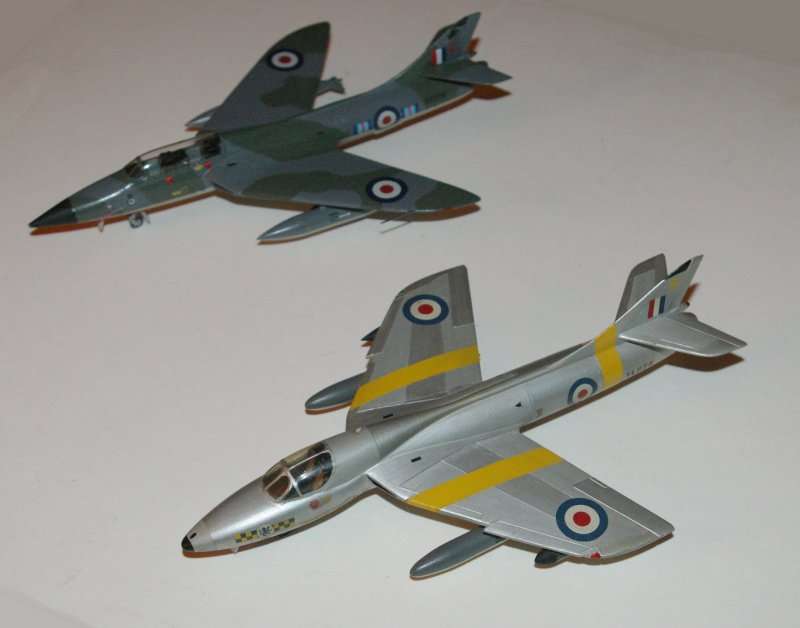

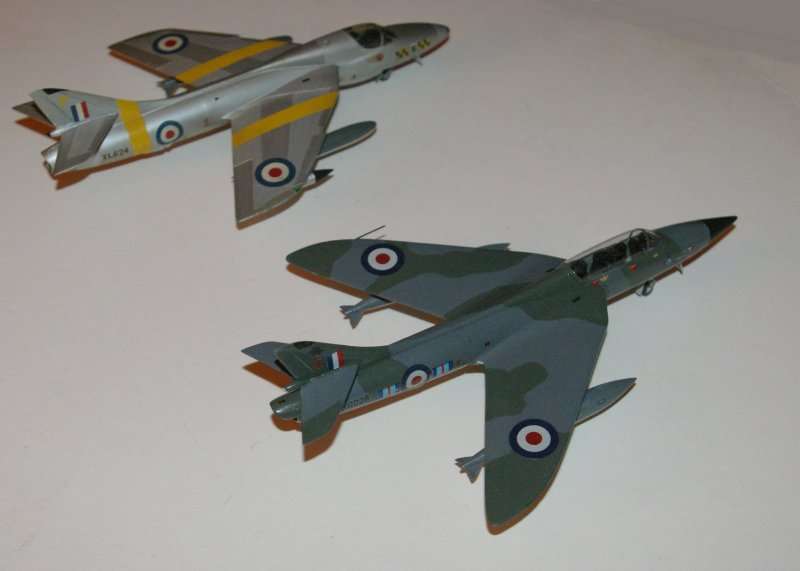

Having sorted that I sized and printed off the sharksmouth and the eyes and applied them, and that's the job done. The last pair of pics show the T12 together with my refurbished RW T7, which shows how much of a change it really is.
