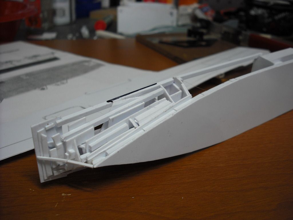

Work has begun.
With my prior Melbourne I used more traditional framing, but getting the height consistent was difficult, so I have places several large pieces of square evergreen tubing along the hull.  This will give a nice flat, consistent surface to lay the flight deck.
The bow is a complex shape, so lots of cutting and gluing.  Will all be hidden by the hull plating.
Now you can see some of the sides of the hull.  Thinner .020 inch, bends better around the hull.  Cut out areas for boat davits. etc.

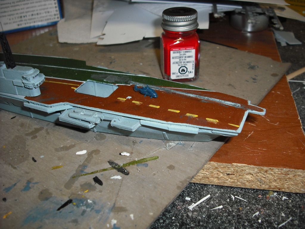

Thanks guys!  Her yard period has run into some unexpected delays- but a few teaser photos have been snuck out via secret agents, in typical gaudy Soviet deck colors:
