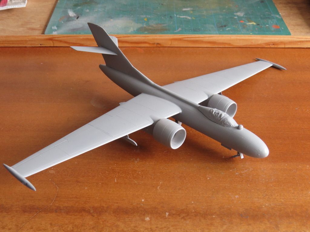

Anyway, they are now gone so here is the Firedrake in overall Tamiya Grey Primer.
Now though I have a problem. Should I leave it in the grey scheme or go for NM which is my original plan.
Decisions, decisions.   :banghead: :banghead: :banghead:
Ay high altitudes the grey would maybe stand out more than NMF, and the Soviets were much more attached to their NMF schemes back in that time frame too, so I'd go without paint.

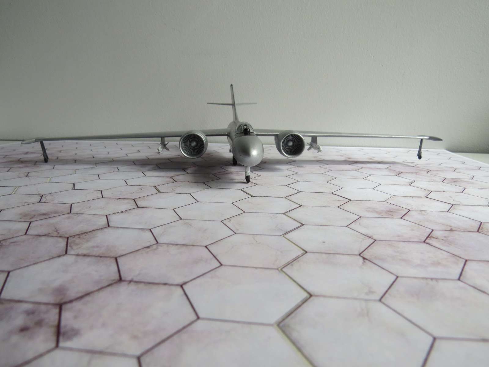

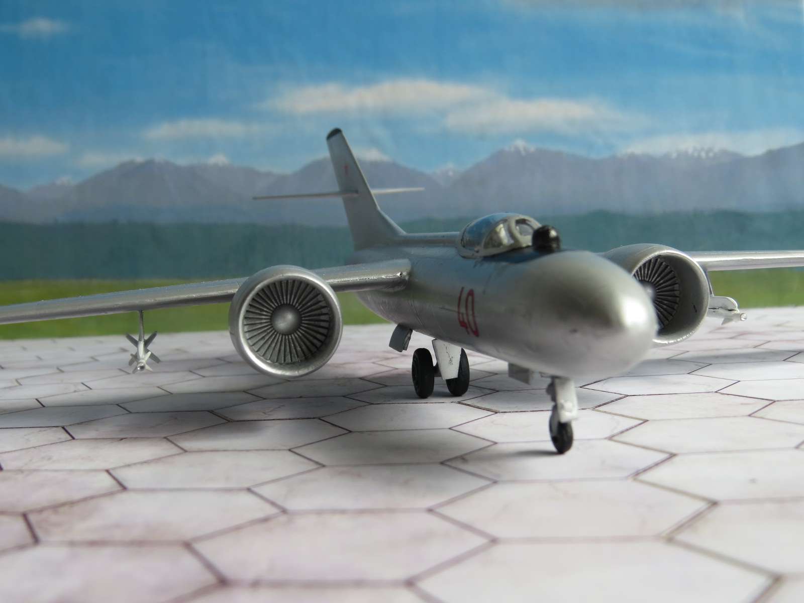

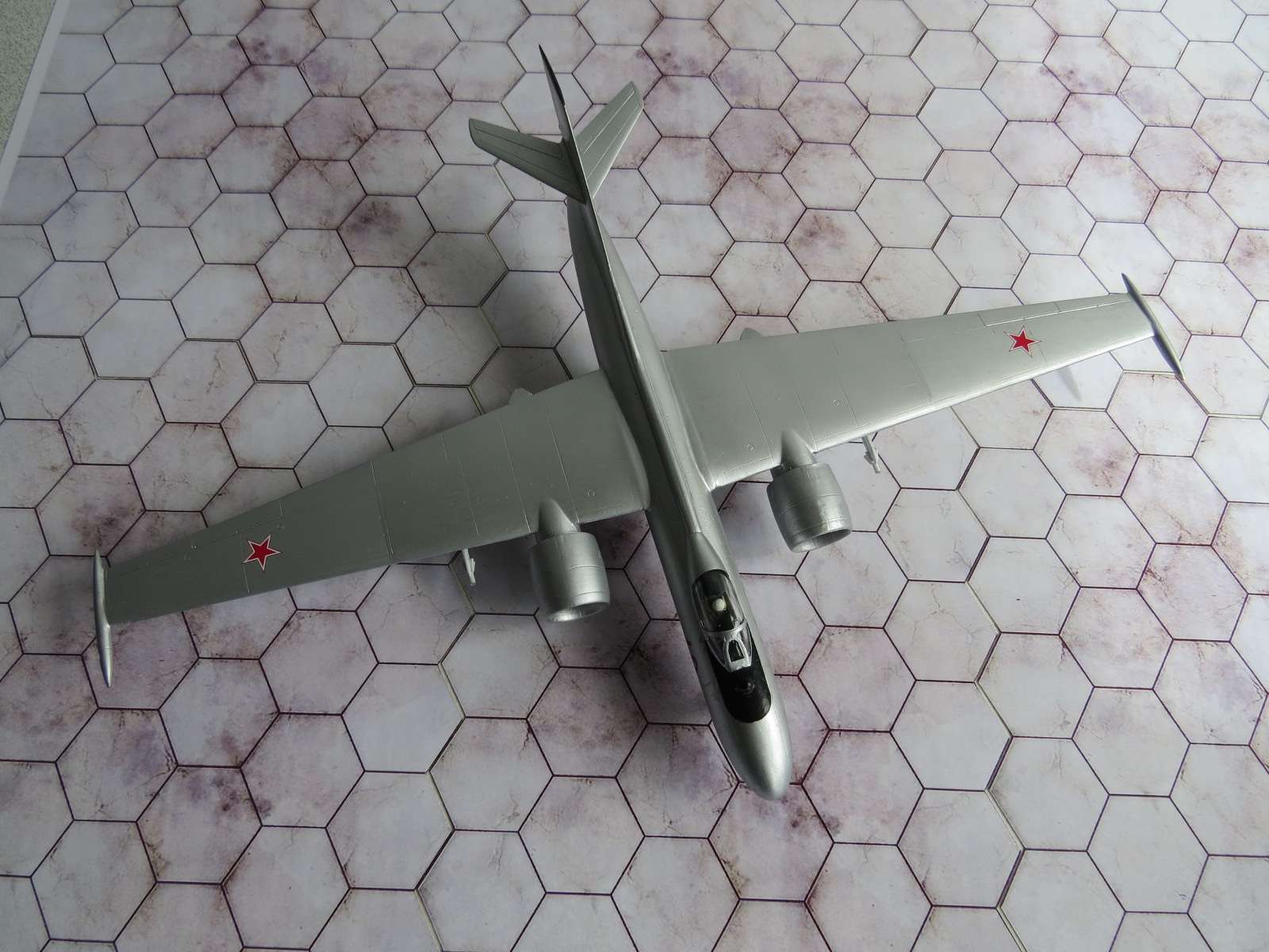

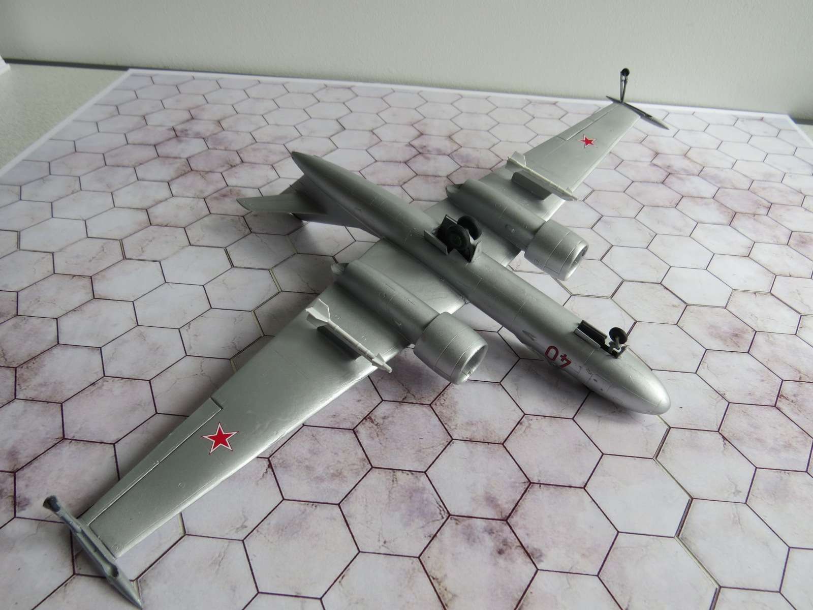

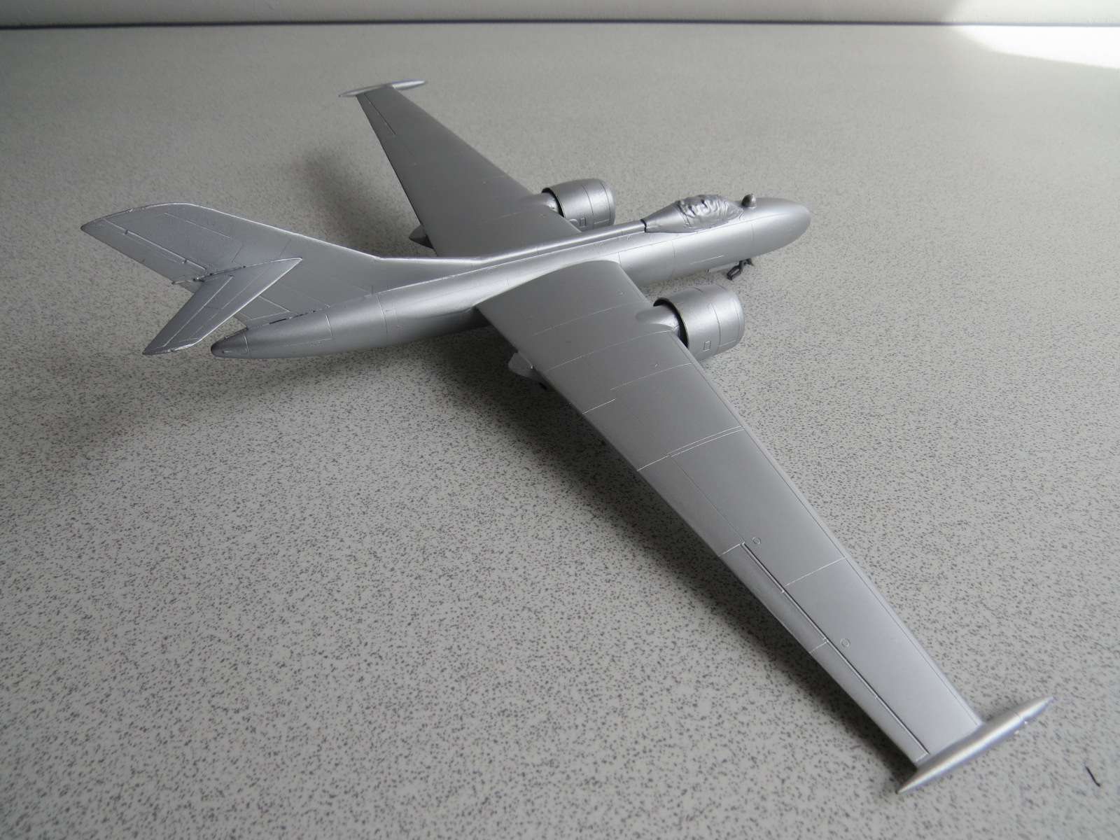

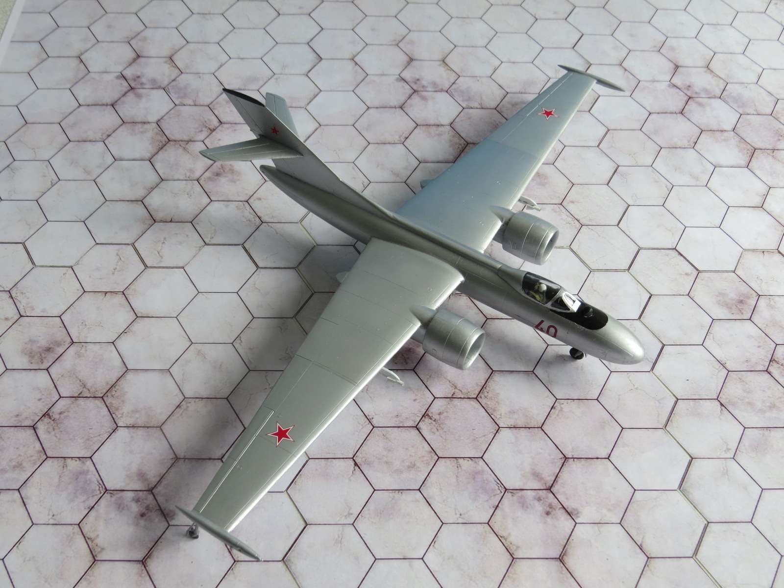

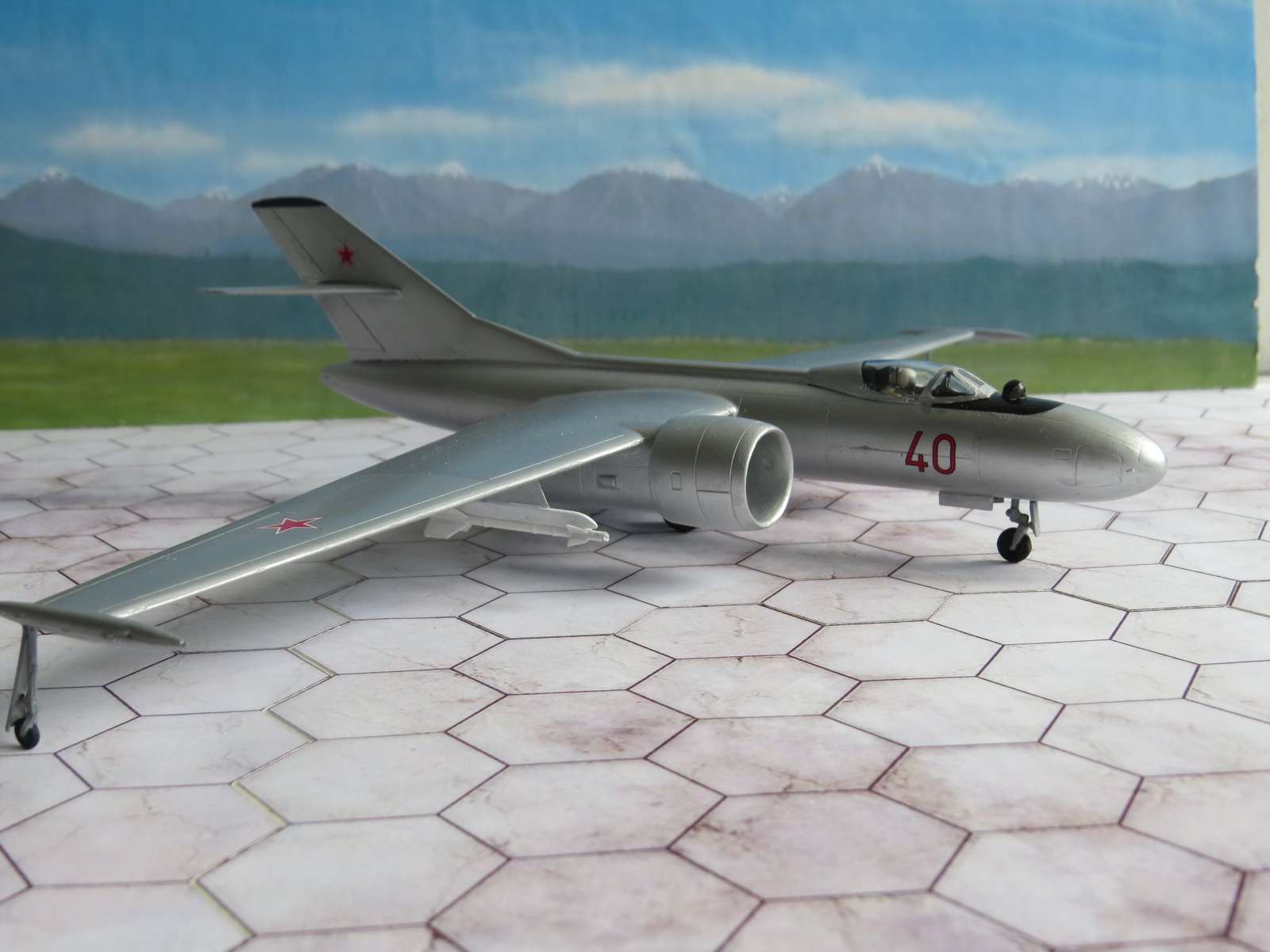

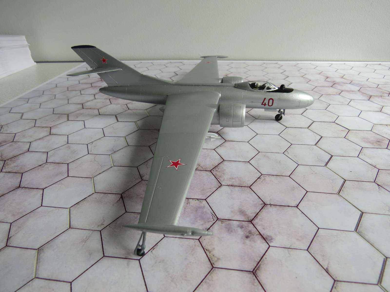

As it has been rather cold and wet around here of late, I have had to wait for a day when the relative humidity has gone down and the temp. has gone up a bit ( I do my airbrushing out in the garage. However at last the Firedrake is done in NMF. Colour used is Vallejo Model Air metallic Aluminium 71.062. This is from the original airbrushing range and not the new range that they have released.
Having looked at photos of the Yak-25 "Mandrake" they have an overall NMF with no apparent differences in any panels, and is also very pale in colour.
This paint does it perfectly.
