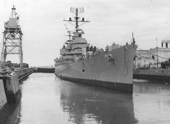

Does anyone have a picture of Sea Cat installation on the General Belgrano? Looking for info for a future project.

I'm having trouble locating clear photos, but the launchers appear to have been fitted alongside the second funnel.

I think I have a picture that shows how high those Seacats are: I'll have a look when I get home.
Edit: found the same picture on the internet:
Here's a blow up of the left side of the superstructure (as you look at it). The Seacat launcher can be seen pointing straight up, with no missiles on it, on the deep "balcony" level with the lower set of bridge windows:
Good grief. And here was me expecting them to be in place of a pair of the secondaries or something. Thanks for that!
Any ideas about what the directors looked like? I can fudge something, but it'd be helpful to know roughly what to aim for...

Re the directors, Seacat ws integrated with an extraordinary numb er of different fire-control systems during it's life, and I can't find which one was fitted to the Belgrano. On the model pics above, there's a pedestal-mounted device above and slightly forward of the launchers (either side of the dish-shaped f/c radar) wich looks like it might be an optical director of some sort, but it doesn't correspond to any Seacat director that I'm familiar with.
