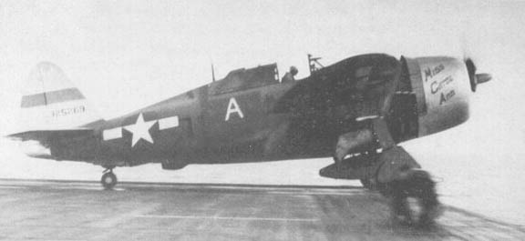

Some real world inspiration:
A question:  Do you intend on folding the wings?  If so, how will you deal with the ammunition (which takes up a large portion of the outer wings - see below)?

To Greg : Thanks for the pics. Yes, I wish to fold up wings and I had not really thought of the problems of installation :huh:, especially with the armament which I plan to install. But I hope to find inspiration with the Sea Fury

Use a P-47N wing and add a further constant chord section, while moving the landing gear inboard, to handle the wing-fold mechanism.

I don't think it'd be even That difficult... if you installed a couple of small rollers to keep the rounds flat in the continuous mags like that, the gun bays are just outboard of the landing gears, you could in theory double that sectional wall and put the fold right there.

Hmmmm that wasn't Quite what I meant... as with that method you'd need to have tensioners or something to keep the belt feed from dropping out of the magazines when you fold the wings.  The way the Jug's magazine is set up for the wing guns is a concept that was started in Germany if I recall, known as the continuous mag - as opposed to being fed out of a box which can catch the belt and cause problems, the belt is run down the length of the wing in a flat open space, which prevents snags and kinks in the belt.
What I was meaning was the other side of the guns, right along the spacer between them and the landing gear bay area, so that the guns are in the fold, and the gears remain in place.  Something like the B7A had - the guns were in the folded part of the wing on that one too.

I was thinking about something like that : Hispano MkV installation in the Sea Fury wings. Infact in this configuration, ammunitions are stocked behind the main landing gear, in the fixed wing part. It seems to be a very good start no?

You'd have to make considerations to have enough space for the belt feeds down the inside of the wing without running into any other parts like control surface mechanisms or such.  All else fails, you could say there's a feed guard cover that's set up on a small track as well that slides along the wing and moves with the fold without dropping it, and the belt, out of the wing when folded.  I don't know how else you could do it, but yeah, that's one way you could feed the Jug... though I think she's got tanks in her wings, which might make things a little problematic.
