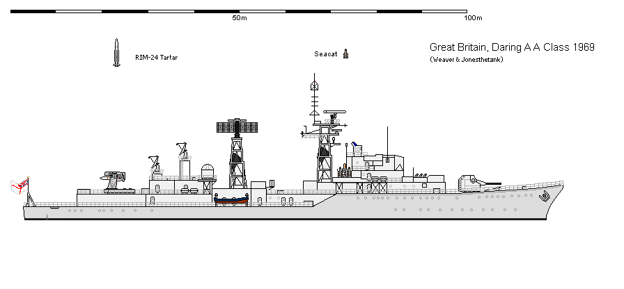

The Royal Navy built eight Daring class destroyers just after the war, and a further three were built in Australia. The Royal Navy took the view that they were too small to be worth modernising and discarded them at the end of the 1960s. However the RAN used them into the 1980s and Peru bought two of the RN ones and used one into the '90s and the other into the 21st century, having given them significant refits.
I've never bought the argument that they were too small to refit, primarily due to the example of the French T-47 class. This early '50s design was an almost perfect "French Daring" of very similar size, armament and character. Where the two diverge, however, is that the French Navy extensively refitted nine of their ships, four as AAW escorts with Tartar and five as ASW ships with Malafon. Given that Tartar was originally developed partly at the request of the RN, it's not a very big stretch to imagine them actually buying it and refitting it into the Darings in similar fashion.
Here's my take on what such a conversion might have looked like:
A position: Twin 4.5" Mk.6 turret replaced by twin 3" Mk.6
B position: Twin 4.5" Mk.6 turret replaced by Squid (displaced from stern) in sliding weather shield
P+S behind bridge: Twin 40mm Bofors replaced by quad Seacat
Forward mast: Type 992 TI radar added on revised platform
Aft funnel: converted to mack like foremast with AKE-1 aerial for Type 965 air search radar
X position: CRBFD and twin 40mm replaced by P+S GWS-20 directors (Seacat) and tandem SPG-51s (Tartar)
Y position: Twin 4.5" Mk.6 replaced by Mk.13 launcher for Tartar SAM

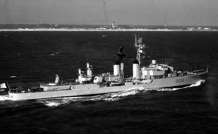

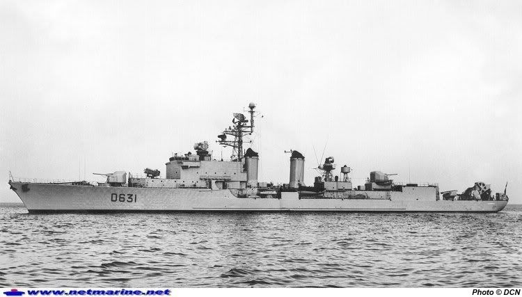

This shows how the T-47s were converted.
1. Original configuration. There are twin 5" guns in A, X and Y positions and twin 57mm in B position and port and starboard amidships. twelve 21" torpedoes (6 long, 6 short) are carried in sided triple banks, and there's a sextuple 375mm ASW rocket launcher in between X turret and the midship 57s:
2. AAW conversion. All the 5" turrets have been landed and the rocket launcher moved to A position. The Mk.13 launcher for Tartar is in X position with the targeting and search radars forward of it:

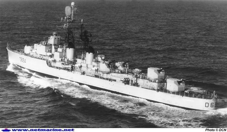

3. ASW conversion. All the original turrets have been removed and replaced by two 100 Mod.1968 guns in A and X position. The rocket launcher is now in B position, a hanger for Malafon occupies the aft part of the superstructure, and the launcher itselfis on the quarter deck with a VDS on the stern:

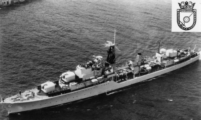

Now here's a standard Daring. Note the similarities to the T-47: three medium calibre guns (4.5" Mk.6), three AAA mounts (twin 40mm), eight torpedoes (centreline) and an ASW mortar (Squid - right aft):

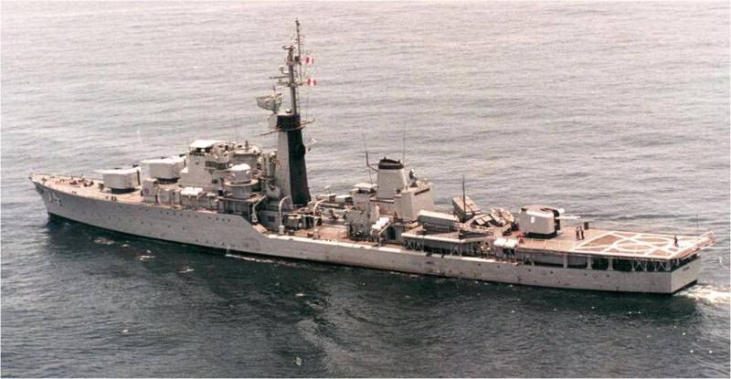

Here's what Peru did with theirs. Ferre (ex HMS Decoy) had a helo pad and eight MM-38 Exocets added aft, and her AAA replaced by two Breda-Bofors Fast Forty turrets. She remained in service until 2007!
Palacios (ex HMS Diana) had the same mods, plus her X turret was replaced with a small helo hangar:
Must have been scary landing a chopper on the Ferre with those twin 5" pointing straight at you! I'd have wanted FIRM assurances that the gun crew were elsewhere......... :o
Quote from: PR19_Kit on April 02, 2010, 03:35:58 PM
Probably rotated the guns 180 deg to face forward for extra clearance. Mind you, the gun crew would want the Exocet circuit breakers in their pockets before doing it....;)
Fulcrum
Quote from: Weaver on April 02, 2010, 04:46:30 PM
At least it is a perfect way of repeling heliborne boarders ;D :o :lol:!!!

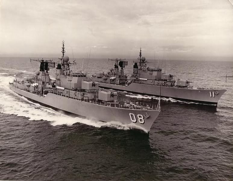

The Aussie Darings also got modded superstructures, with enclosed bridges and other modifications to accommodate the new radars etc. I went on Vampire at the Maritime Museum in Sydney a few years ago - pretty ship.
#9
Quote from: pyro-manic on April 03, 2010, 11:08:52 AM
Indeed. Actually, I was wrong about the armament: the Aussie Darings had two twin and two single 40mm and Limdo aft rather than Squid.

Ooooo, you wouldn't happen to have a high-res version of that photo would you?
