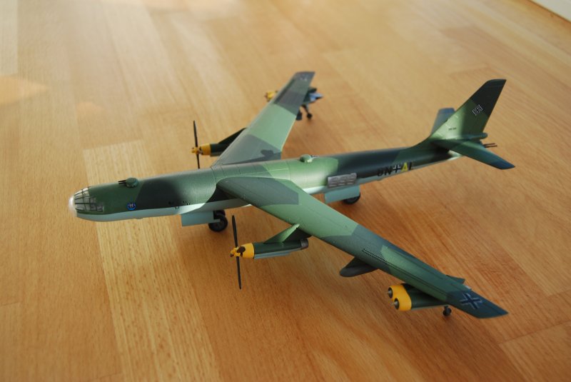

The model shows the Me-247 during its roll-out on 02.02.1944 in Augsburg.

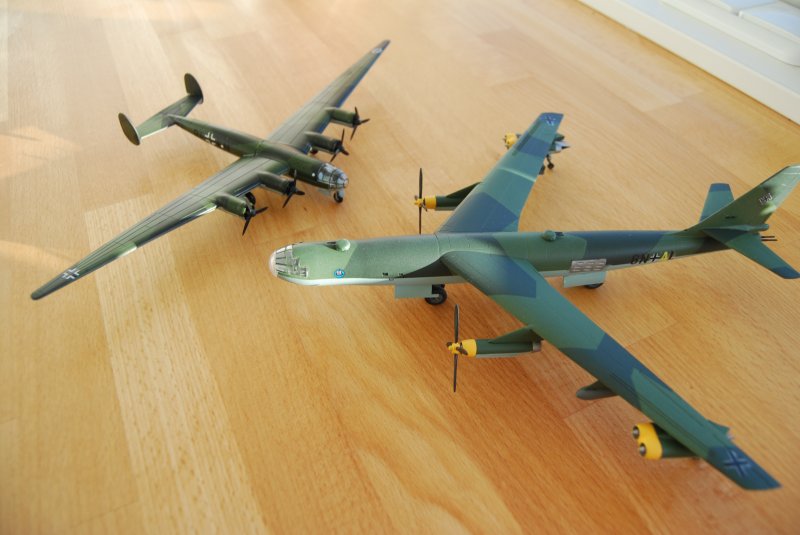

The Me 247 together with the Me 264 V1
The Model:

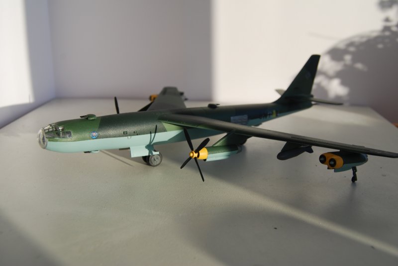

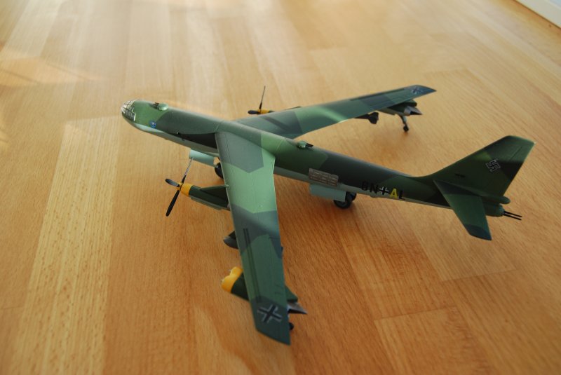

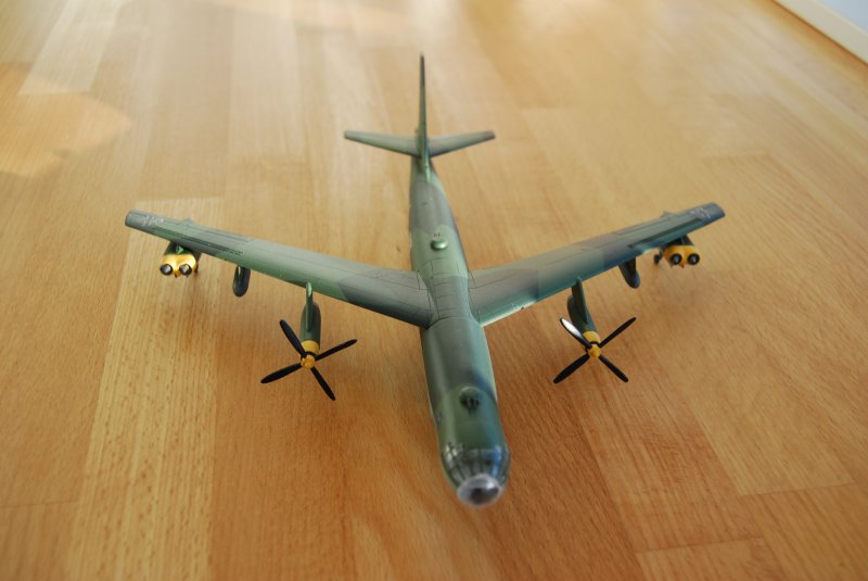

The model was build using two kits, a 1:144 Acedemy B-47 and a Minicraft B-29 of the same scale. The idea was to take the hull and wings of the B-47 and add the cockpit of the B-29 to it to give it a more "classic" bomber style. Both aircraft have about the same diameter of the hull ,therefore the cockpit fits quite good to the hull. However, the hull had to be made a bit longer, to give the plane some better looking proportions.
The position of the twin and single engines were swapped as I wanted to made some turboprops from the single engines. Additionally the landing gear had to be modified a bit, otherwise, the props would cut into the ground. The bombs under the wings were from the spare parts box.
The aircraft was air brushed with Revell Aqua color, with a standard German bomber camo, decals are made by Paddinghaus.

That Me 264 looks good too, which kit, or kits, is that built from?
nönöbär
Quote from: PR19_Kit on February 03, 2014, 12:35:45 AM
Brilliant piece of work there.   :thumbsup: :bow:
Thanks!
The Me264 is nto a kit, its a ready made model either by Atlas / Altaya / IXO (don't know which one, don't have the box anymore), but as it is also in 1:144, it fits quite good to the Me-247
