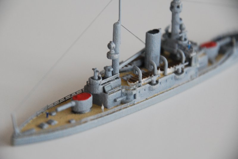

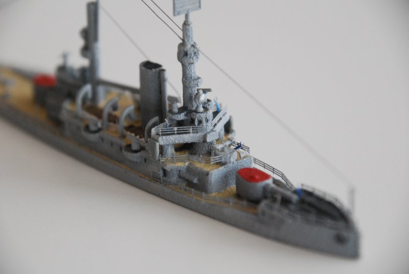

The rough surface structure can be seen on the detail photos:

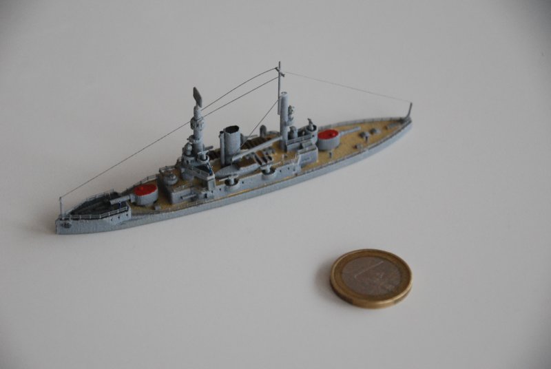

Size compared to a 1€ coin:

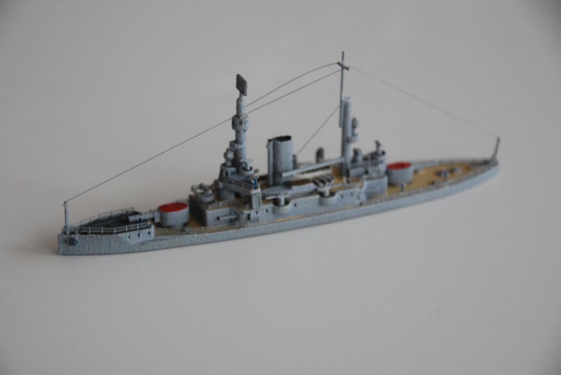

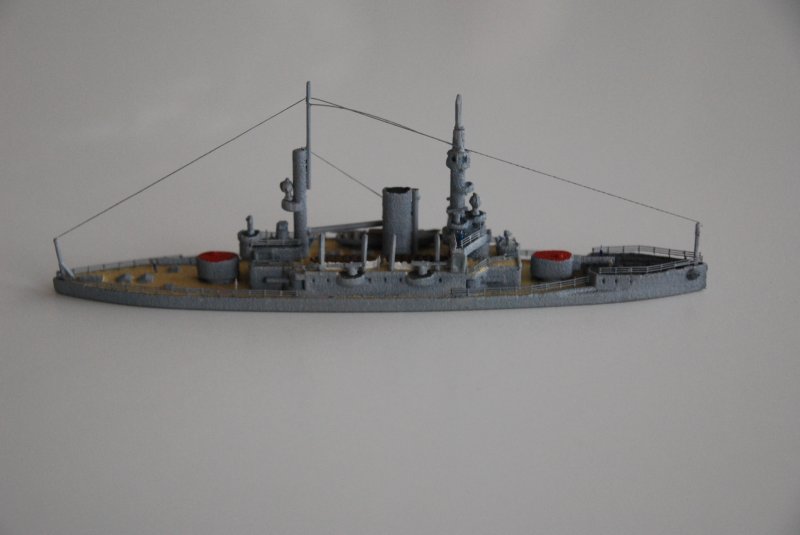

This is a 3D-printed model in 1/700 scale made by Shapeways. It my first attempts to work with 3D printed stuff. The material chosen was "White Natural Versatile Plastic" (3D printed in white nylon plastic with a matte finish and slight grainy feel) which is the cheapest choice to make. Price is about 15€. As seen, this gives the model a slightly rough surface which I kept as it is.  I want to try other materials on other 3D printed models in the future.
The ship was enhanced by several parts of the spare parts box: The 7,5cm guns, AA guns, boat davits, searchlights, masts, radar, antennas and additional PE parts. It is painted with Revel Aqua colour.
