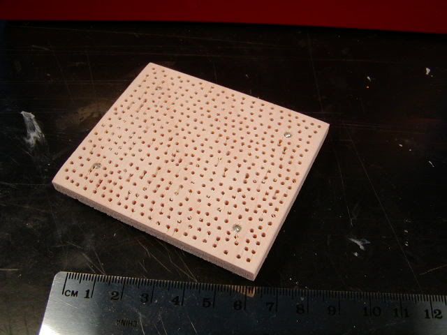

Then I cut a piece of 1/4" plywood to replace the perforated forming tray that was missing from this used Vacuform Machine:
Believe me, that's a lot of freakin' holes to drill!  Could've used perforated screen but I just wanted to get this thing going tonight.

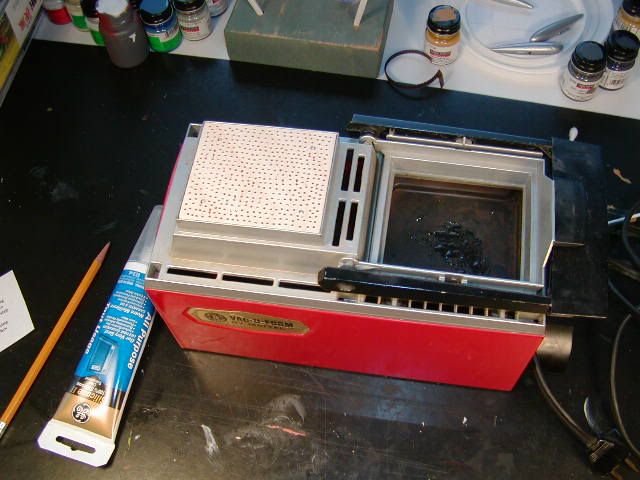

And this is how it looks in the machine:
Once the silicone sealant on the new valve sets up, first subject to get formed will be the male pattern for my Morsair canopy.  Wish me luck, I know I'll need it!

Do you have the perforated vacforming tray "table" insert on your machine?  I found out the hard way that, without the table insert, nothing will form/seal properly.
QuoteDo you have the perforated vacforming tray "table" insert on your machine?  I found out the hard way that, without the table insert, nothing will form/seal properly.
Yep. I figured out as soon as I saw it that it would be asking too much for the plastic to stretch that much. Mine doesn't have as many holes as yours, but I'm sure it will do the job.  ;)
