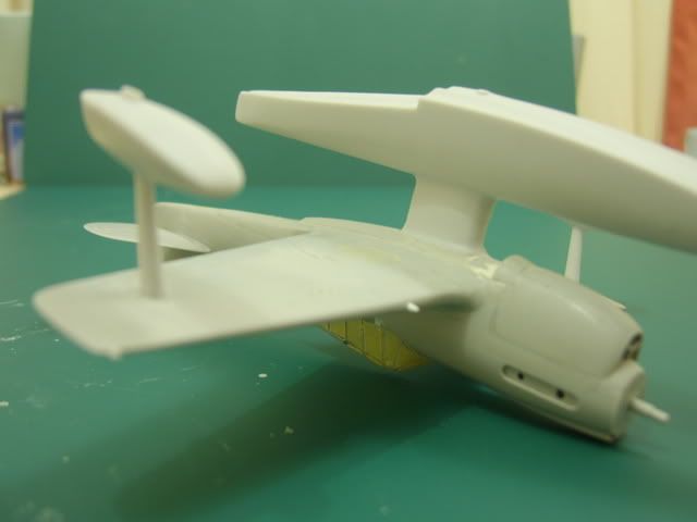

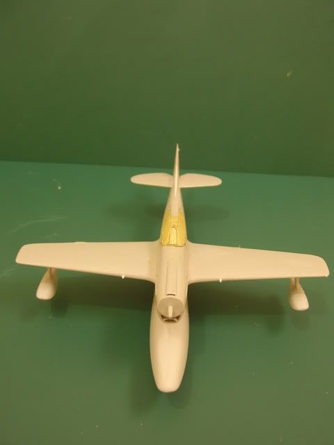

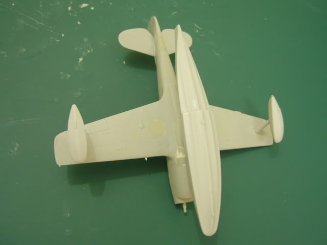

I've moved the pulse-jet version to a separate thread. The P-40 rocket interceptor had two main inspirations.
The first was that, beginning in the late Thirties, the USSR probably did more work on rocket propelled aircraft than any other wartime nation. Although they designed their share of small, Komet-sized rocket aircraft, some of the Soviet designs were relatively large - the I-302 and the La-162 were the same size as contemporary fighters and they also produced rocket boosted versions of the La-5, La7, Yak-3, Yak-7, Pe-2 and Il-10.
The second was that the USSR received about 2,000 P-40s but, while they appreciated its comfort, build standard and ruggedness, they considered it a less effective fighter than the P-39 and their own Yak-1/3/9 and La-5/7 designs and many of the P-40s served with second line air defence units, defending cities in the rear. At the end of the War, they still had 27 P-40Cs and 844 P-40E/K/M/Ns, so it would have been easily available. (And they often used foreign aircraft for test work - Spitfires on catapults, jet engines test flown on B-25s, Ju-252 engine testbed - so a rocket powered P-40 is a distinct possibility).
I've taken the three-engine layout proposed for the La-5VI, I-302, and Yak-7R and assumed that a P-40C has been chosen as a test vehicle because of its availability, size, rugged construction, and second line fighter status. The piston engine has been removed and replaced by ballast and the armament has been retained.
McGreig
The kit is the 1/72 Hobby Boss P-40B/C. It's not a bad kit but I have to say that I'm slightly underwhelmed by the Hobby Boss P-40s. The layout of the B/C is slightly different from the E/M/N versions but they all work the same way, with a one piece fuselage and a one piece wing and lower fuselage. They're relatively cheap, sharply moulded and appear relatively accurate but the fit of the parts isn't too good and filler is definitely requires for such joints as there are. I've not found them any quicker or easier to build than the Hasegawa or Academy P-40s.
As well as the removal of the engine, the kit has been modified by raising the height of the fin to compensate for the cutting away of the rudder to make way for the rear fuselage rocket. This started life as a missile in the (old, inaccurate) Revell MiG-31 kit while the wing mounted rocket motors were MiG-15 drop tanks in a previous existence.
