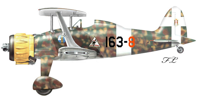

This lil' whif was tinkered together as a kitbashing in about a week - orginally it was inspired through fellow member NARSES2 who wondered in his blog what to do with an Airfix Gladiator. Several nations were discussed, and I proposed an Austrian Air Force whif, based on a drawing of a Ju 86K bomber from 1938.
That reminded me of some biplane spare parts in the scarpyard, and so I got myself caught by the spontaneous idea to build a biplane whif. And here it is, the Macchi C.170 "Brezza":
Macchi C.170 Brezza by Franclab, on Flickr
(Many thanks to fellow FlickR user Franclab from Canada for creating this wonderful profile in less than 24 hours!)   :bow: :thumbsup:

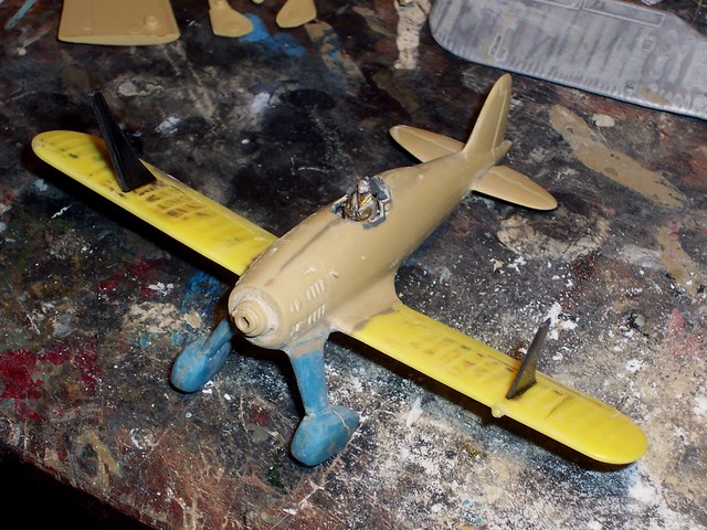

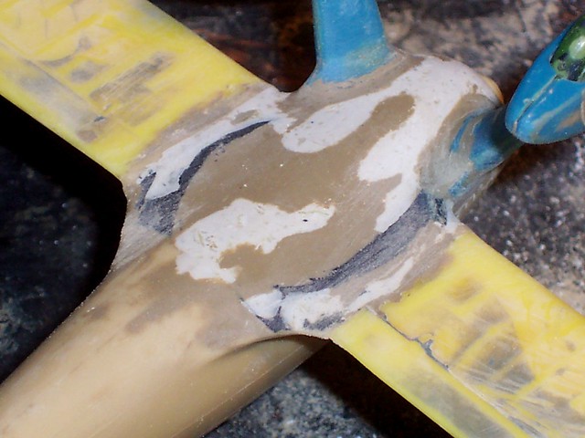

Pretty straightforward, but even though it would be a small aircraft model, it would come with two big challenges: mounting the lower wings and shaping the resulting, gaping belly, and the custom-made struts and wirings for the upper wing.
Work started with the Macchi C.200's fuselage, which was built OOB - just without the wing, which is a single part, different pilot (the included one is a pygmy!) and with a free spinning metal axis for the propeller.

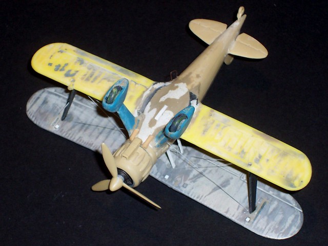

The wing installation started with the lower wings. I glued the Helldiver wings onto the C.200 fuselage, so that the wings' trailing edge would match the C.200's wing root ends. From that, a floor plate was fitted under the fuselage and any excessive material removed, the gaps filled with lumps of 2C putty. That moved the lower wing's roots backwards, creating space at the lower forward fuselage for the new landing gear.

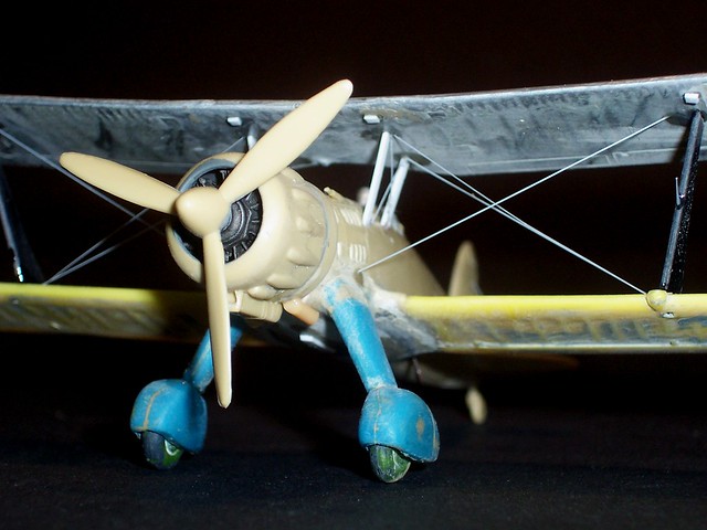

The latter was taken from a vintage Matchbox Hs 126 reconnaissance aircraft - probably 25, if 30 years old... Size was O.K., but the struts had to shortened by about 5mm, as thge HS 126 is a much bigger/longer aircraft than the C.200. A cut was made just above the wheel spats, material taken out, and the separate parts were glued back together again.

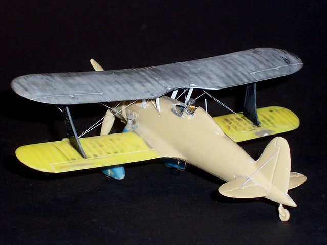

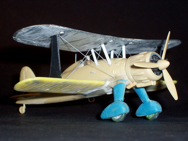

With the lower wings in place I started building strut supports for the upper wing from styrene strips - tricky and needs patience, but effective. I started with the outer supports, carving something SBC-style from styrene. These were glued into place, slightly canted outwards, and their length/height adapted to the upper wing's position.
When this was settled, the upper Gladiator wing was glued into place. After a thorough drying period the short fuselage supports in front of the cockpit – again, styrene strips – were inserted into the gap. This allowed an individual lengthening, and was easier than expected, with a stable result.
1:72 Macchi C.170 "Brezza" (Whif/kit-bashing) - WiP by dizzyfugu, on Flickr
After having the upper wing glued in place I added some wiring, made from heated and pulled-out styrene sprues. This not only enhances the kit's look, it also (just like in real life) improves rigidity of the model. Also a tedious task, but IMHO worth the effort. I tried thin wire, nylon strings and sewing yarn for this job, but finally the styrene solution is what worked best for me.
The exhaust installation had also to be modified: the new Hs 126 struts with spats would have been where the original C.200's hot exhaust gases would have gone, so I added new exhaust pipes that would go between the new legs.
Other small added details included, among others, a pitot on a wing strut, a visor in front of the cockpit, a radio antenna, a ladder made from wire.

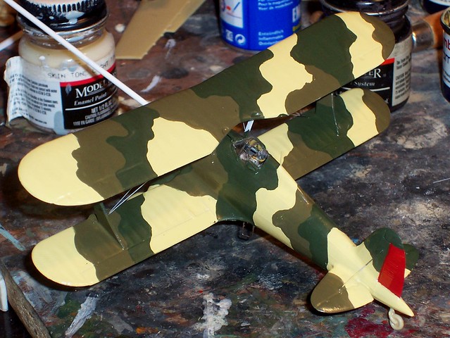

Painting and markings
I would not call the Austrian 3+1-tone pre-WWII-scheme spectacular, but the colors are unique. My scheme is based on an Austrian Ju 86 bomber from 1938, so it fits into the intended time frame.
The colors were puzzled together from various sources and are subjective guesstimates:
● A pale, yellow-ish beige (Humbrol 74, 'Linen', out of production)
● A rather brownish green (Testors 1711, 'Olive Drab', FS 34087)
● A dark green with a yellow-ish hue (Humbrol 116, 'US Dark Green' FS 34079)
● Light blue for the undersides (Humbrol 65, 'Aircraft Blue', RLM 65)

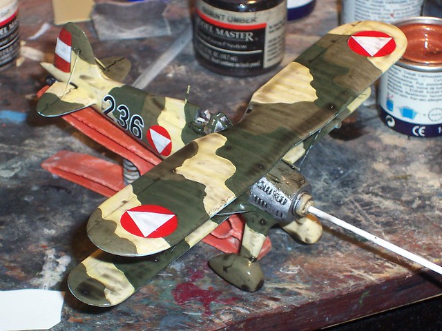

In order to add some details I painted the area behind the engine cowling in aluminum. The respective part under the fuselage, where the exhaust gases would pass, was painted in Steel – both Testors Metallizers.
The interior surfaces were painted in a neutral Grey – but with the engine and the pilot in place you cannot see anything of that at all.
Markings are minimal: the Austrian roundels come from a TL Decals aftermarket sheet, the flag on the rudder was laid out with red paint (a mix of Humbrol 19 and 60), the white bar is a decal. The tactical code is fictional, puzzled together from single digits in various sizes (also from TL Modellbau sheets). The original documents how purely black fuselage codes, but I found these hard to read. So I chose digits with a white rim (actually, these belong to modern German Luftwaffe tactical codes in 1:32), which improve contrast a little.
The kit received a thin black ink wash and some shading/dry-painting with lighter basic tones (Humbrol 103, 155, Model Master 2138,'Israeli Armor Sand Grey', and Humbrol 122). After decal application, another turn with overall Hemp and Light Grey was done in order to fade contrast and to emphasize the surface structure. The wires were also painted, but only with thinned black ink and a VERY soft brush.
Finally, everything was sealed under a spray coat of matt acrylic varnish.

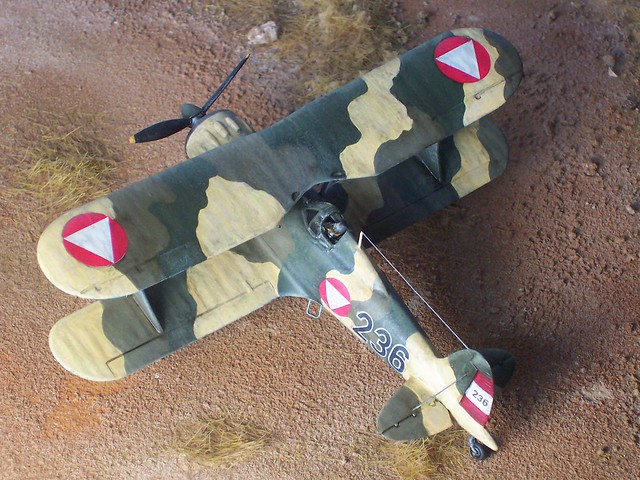

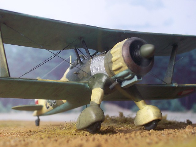

1:72 Macchi C.170 "Brezza"; aircraft "236" of Jagdgeschwader II, Fliegerregiment Nr. I, Österreichische Luftwaffe (Austrian Air Force); Wiener Neustadt, summer 1937 (Whif/kit-bashing). by dizzyfugu, on Flickr
