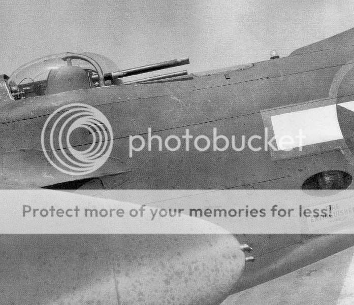

Just recently I was completing a 1/72 A-20G, and spotted that the turret guns of the example in the Squadron book do NOT have perforations... they are a solid tube.
Thinking about it, I realised I have seen examples of planes such as the A-26 and B-25H where the nose gun jackets are also solid.
Does anyone know of the reasons for this? Was it to do with the altitude/theatre they were serving in? Or the position of the gun on the aircraft in question?

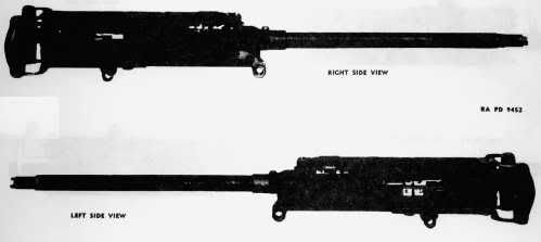

Hi, I found this pic on the net and haven't been able to find out anymore yet but I do have a couple of old Gun books and I'll have a look through them at the weekend for you.
Steve

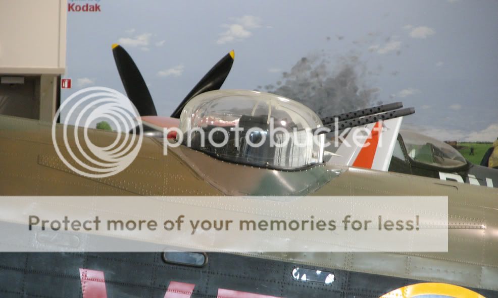

Yeah, the actual ones used had the perforated jackets.  Here's a shot from my trip this year.
Logan

Quote from: Rick Lowe on September 13, 2012, 12:27:50 AMJust recently I was completing a 1/72 A-20G, and spotted that the turret guns of the example in the Squadron book do NOT have perforations...
Is this the photo you mentioned above?
It obviously shows the national insignia with the red border, used for a brief period (June-August/September 1943). The a/c has no visible code letters (usually placed on both sides of the insignia). Could this be some test/experimental a/c?
It's interesting, but the barrels appear to me rather thick - compare with the same Martin-turret (on a Canadian Lanc), having guns with cooling jackets.
Rick Lowe
Yeah, I think that's what it is - a mockup gun in a prototype turret... d'oh!
So I'm not going (that) crazy after all... some consolation at least.
