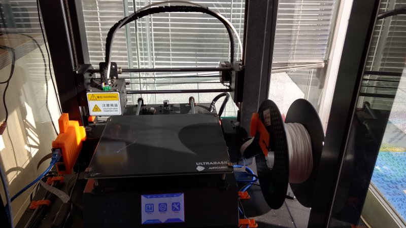

This is a FDM printer:
On the right, you see the filament, the middle you have the print head (with the warning sign on it) that moves sideways and up&down. The ground plate can move forward and backward. The little orange box on the lift contains a raspberry pi running octopi to control the printer. But the printer can also be operated without one. On little orange box at the filament right is a camera, so that I can check the pritner from remote. Of course, all the orange stuff is printed with a printer. Hint: Once you have a 3d printer, one of the first things you print are parts for the printer :)

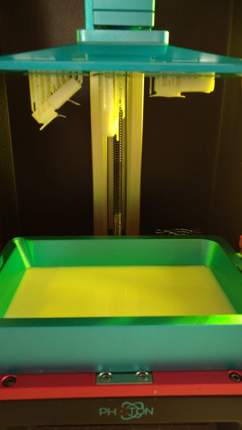

This is a SLA printer:
On the bottom, you have the tank with the liquid resin in it. Below it is a lcd 2k display with a uv light behind it. By making pixed transparent, the uv light can then harden the resin. On top, you se a green plate. This one moved down into the tank, 0.03mm above the bottom. Then the first layer is hardend and sticks at the plate. It htem moves uo, so that new resin can float belo and then moves exactly 0.03m higher than before. So the next layer is processed. Layer by layer it them moved the printed objects out of the tank.
When finished (like on the photo), you have to get the object off the plate, clean them with isopropanol and then harden them under a uv lamp (or sunlight). The tank has to be emptyed  - his is when it getts messy....

I'm familiar with the FDM printer, my mate Pete has 2-3 of them in various sizes, but I've never heard of the SLA type. That stuff looks like it's GROWN out of the tank!  :o

This is exactly what is happening - it grows out of the tank. With about 20mm/hour.
