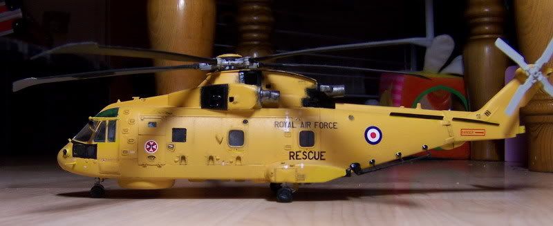

This started out as an OOB build that stalled since I didn't really want to work on the cockpit - to me, that's usually the most boring bit of the model, lots and lots of tiny parts to clean up and paint and probably lose before they're installed. So it sat in my window for six months, until I saw a photo of an armed example... so out came the kit, since I was going to put some guns in.
Problem was, the interior of the kit is basically just a shell, and when looking for images of how the guns are mounted inside the cabin, I couldn't help but notice that the interior walls on the real thing are pretty thick, and clad in soundproofing that's pretty obvious.
I had a big package of Green Stuff left over from my very brief Warhammer phase, and decided that this might do for an interior material. So I beefed up the walls and tried impressing a pattern. Big mistake - it looked awful, and filling the pattern with putty and trying to sand it down looked worse. Just when I'd decided the kit was botched beyond repair, I spotted one of those thermoformed packages you get electronic gizmoes in that don't warrant a cardboard box - in this case, it was a desktop mike, I think. It had a big, flat, clear front, and a big, flat, clear back, and it was thick enough to be stiff but not enough to be unwieldy.
So I cut a big rectangle out, trimmed it a little, and superglued it to the inside of the helicopter... The corrections kind of kept coming after that, with a new full-cabin roof, then a further lowered roof, and then the overhead paneling along the sides, until thw whole thing looked like this:
That's as far as I've gotten, and the project is again stalled while I figure out whether I want to remove the windows I've already installed and replace them with pieces of OH film applied from the outside to represent the flush windows of the real thing, and while I work on a tool to make the cabin lights.
