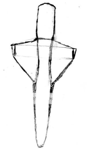

#57
Honestly I think some kind of hybrid of the A2 and a waverider would be a cool idea...
Flattening the fuselage turning the nose and tail into a blade shape (from the overhead view), moving the engines under the fuselage, reshaping the tips a little bit, forming the inboard leading edge into a LERX as it could provide some extra lifting area up front supersonic, some area ruling and blending and such.
I do have drawing if you need a visual description:
I like the wing design as it offers hypersonic performance and subsonic cruise capability, the engines mounted under the wider fuselage could exploit the wave-riding for inlet benefits too, and obviously improved lift when supersonic/hypersonic.
The afterbody shape is the way it is simply because I haven't thought of anything yet.  Truthfully it would probably be smarter to push the wings back a little bit (One odd idea I've thought of would be to widen the tail up a little bit like the X-43 because it could produce a tailplane effect and with a high enough sweep could keep much of the shockwave off the leading edge and provide a reasonable degree of pitch control to augment elevons which would be mounted on the wing's leading edge but I don't know if it'd work)
As the design is drawn it's length is the same as the LAPCAT A-2.  I don't necessarily think the excessive length is practical, but for the time being, I'll stick with it.
What do you all think?
KJ_Lesnick
