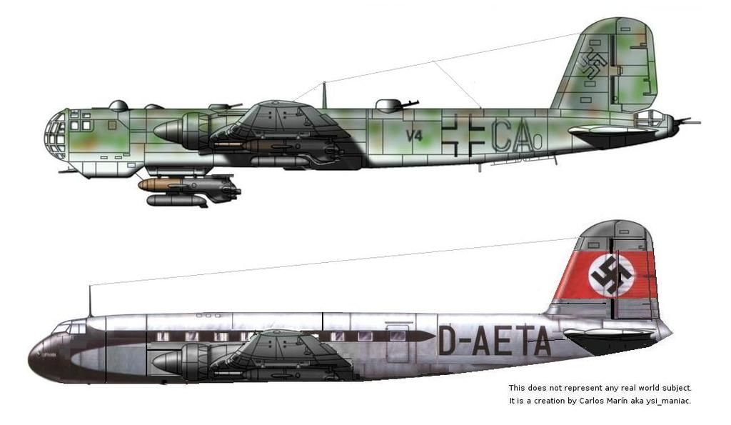

Airliner derivative of He-177along with her ancestor.

Schnelltransport, staff or cargo, extra tankage under cabin, based on He-177
#56
Variations on He-177 theme (first one is RW)
I like those Carlos  :thumbsup: , but then I've always liked the 177 and its derivatives.
