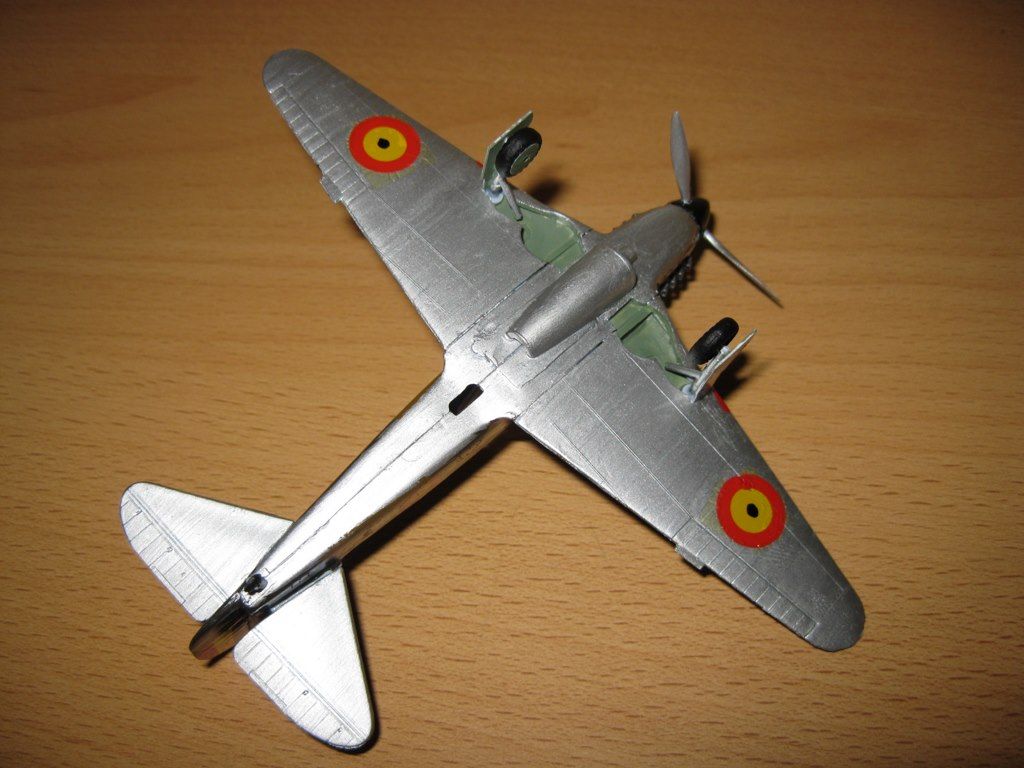

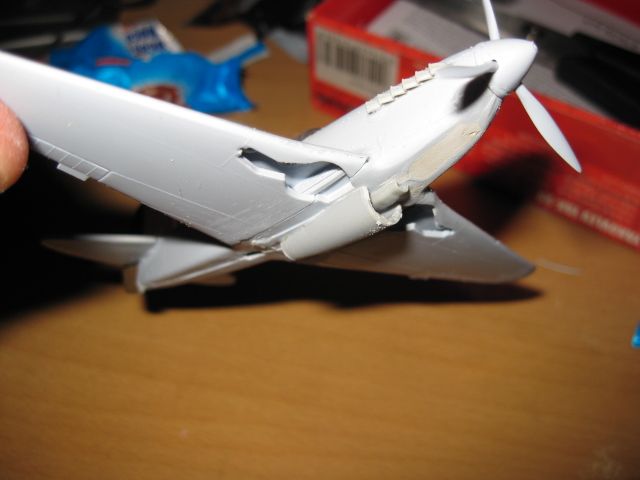

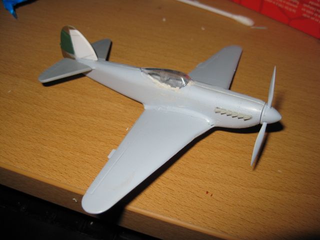

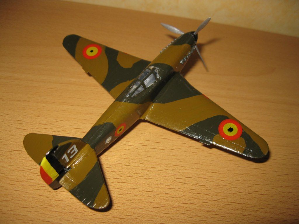

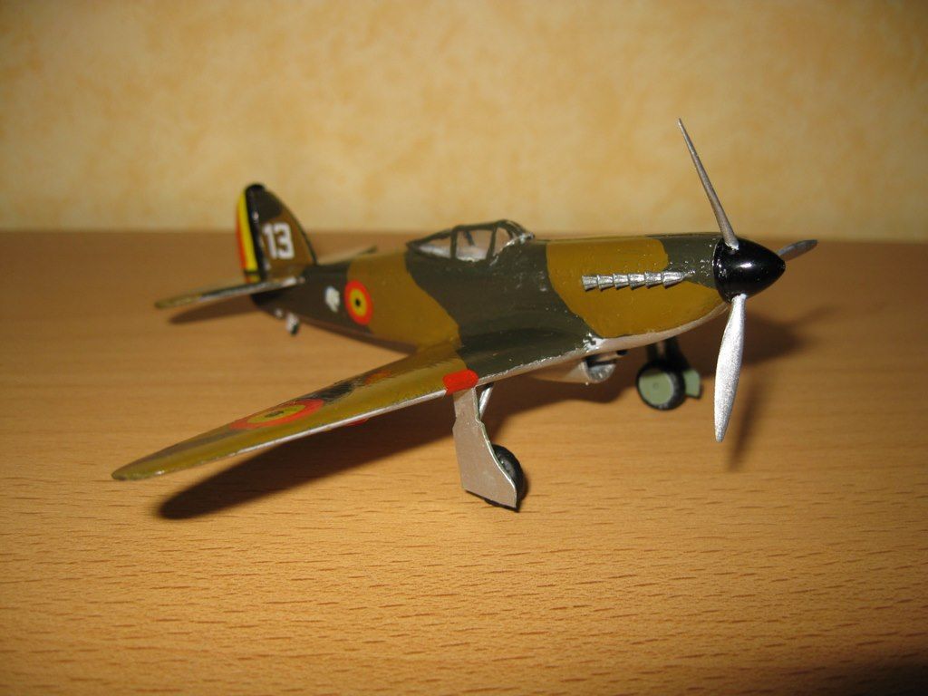

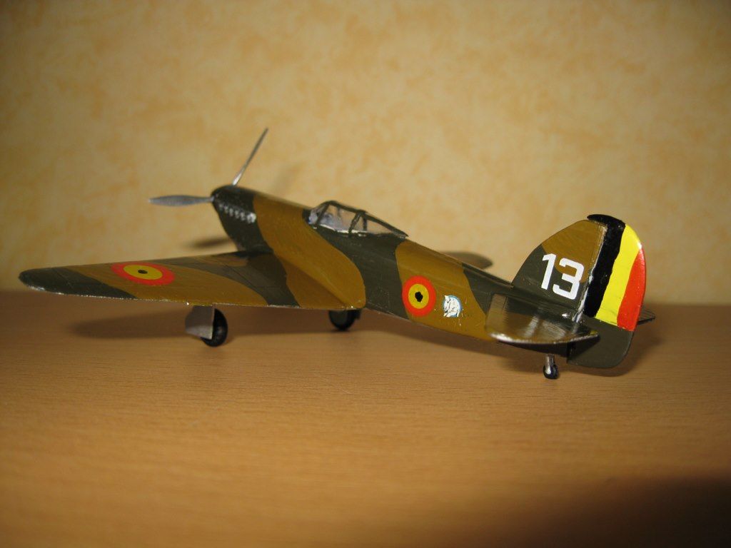

Model:
resin kits are to expensive and hard to work with for my taste, so i decided to make a conversion.
basekit for this build was the old Airfix Yakovlev Yak-9D, with the inlets under the fuselage and nose removed.
tail is scratchbuild, rudder from a Hawker Hurricane, horizontal tailplanes and canopy from Revell Mig-3, prop from an airfix Spitfire Mk.1 and scratchbuild supercharger under the fuselage (from spare droptank)
exhausts from an unknown kit (sparesbox).
A VERY smooth looking aircraft there Nils.  :thumbsup: :bow:
Very sleek looking bird Nils.. Looking forward to this build.
Looking forward to seeing this Nils. I've built a couple of Renard aircraft -the 38 and 40 if memory serves. Resin kits and quite a lot of work. Yours looks good  :thumbsup:
nighthunter
It looks simply amazing so far, I like the mix and match, recognized the Yak-9 body and canopy almost immediately.
Elegant! Looking forward to see this one in complete markings!
