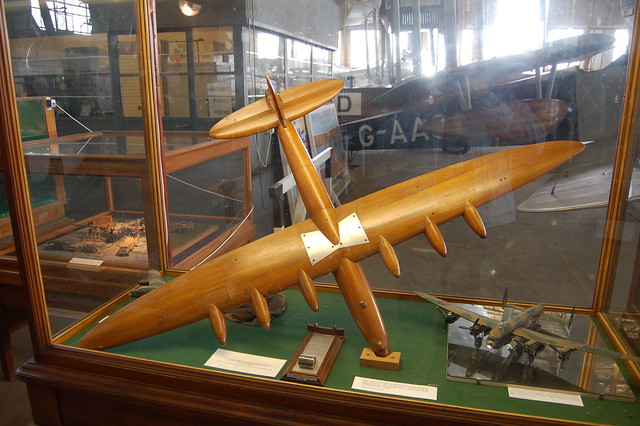

This is the wooden wind-tunnel model of the Victory bomber at the Brooklands museum.
Barnes Wallis' Victory Bomber.1939 by PappaDom, on Flickr

QuoteThis is the wooden wind-tunnel model of the Victory bomber at the Brooklands museum.
Actually that's the picture I've seen before.  However, from that angle it looks very teardrop and circular in cross section.  From the side though it's shape didn't look this way.
