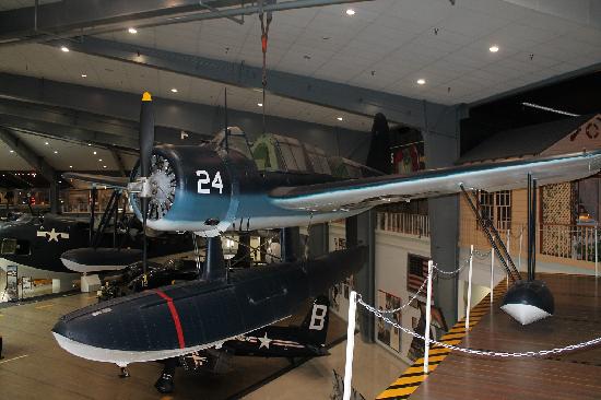

One of USS Pensacola's Kingfishers is on display at the US National Naval aviation Museum - I am sure that they will answer all your questions if you explain the reason for your request.
http://www.tripadvisor.in/LocationPhotoDirectLink-g34550-d258659-i40185615-National_Naval_Aviation_Museum-Pensacola_Florida.html
