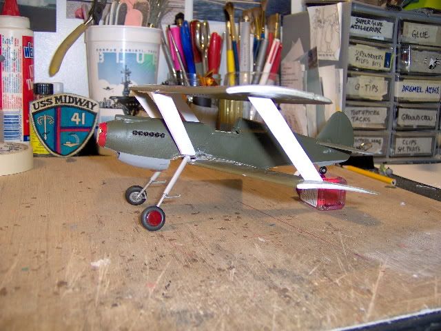

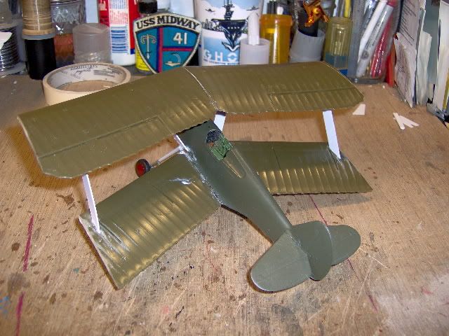

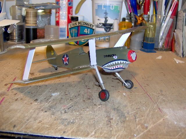

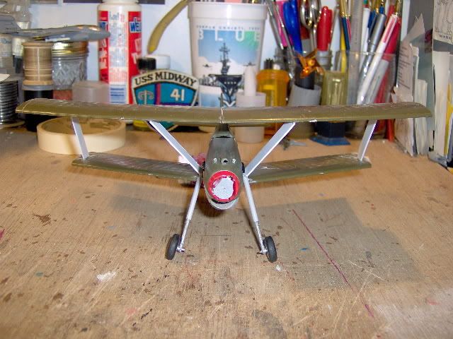

I know it's still pretty fuggly, but I thought I'd show my progress as it slowly takes shape. :)
   Eddie
