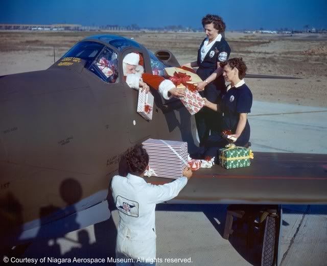

Bet you didn't know the P-39 was also Santa's replacement sled for the early '40s - powered by a special modified "Reindeer MkII" variant of the Allison:

In the pic below, look at the length of the main landing gear relative to the people standing by--maybe only a foot longer u/c?  If you look at the pic with "Santa", the guy in white's chest is even with the leading edge of the wing. In my pic here it would appear that if the people took a couple of steps back, the leading edge would hit them armpit high or possibly shoulder high--not a whole lot of difference. I think on the Shinden a person could walk under the wing without scraping it (note the probably very short woman walking right past the u/c under the wing).

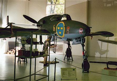

I think that picture is deceptive: the J21's wing is taller than head height, as per this pic (the pilot dummy is full-size):
Lots more pics here:
http://www.ipmsstockholm.org/magazine/2000/02/stuff_eng_detail_j21.htm
#57
Weaver:
>I think that picture is deceptive: the J21's wing is taller than head height, as per this pic (the pilot dummy is full-size):<
The color, closer-up pic of REAL PEOPLE by the Saab seem to me to indicate that if the guy facing the left turned around, he would smack his face into the lower crown of the roundel (at or slightly above wing level). It seems to me that although the caption says "full-size" for the dummy,  we don't know what his height is really? Or are the guys in the other photo very tall?
From the pictures of the Saab j-21 on the site you linked, it is clear to me that indeed the twin-boom pusher Airacobra as depicted in the photo-shopped picture would need some more elevation so that the prop cleared properly on take-off. That, or a truncated propeller (and any adjuvant oddities in RPM's or thrust that might cause).
It's not the dummy, he's the right size.  The J-21 in Weaves pic is on jacks!  :dalek: :dalek: :dalek:
Quote from: sequoiaranger on February 19, 2009, 06:30:25 PM
Well what we're doing is photo-interpreting here: I'm looking at the same picture, and my impression is that the same guy's hat would hit the bottom crown, rather than his face. My impression is also that the pilot guy could almost walk under the wing without stooping.  "Full-size" real people come in a range of heights from 5' to 7' with a large number of people between 5'4" and 6'4".
We coud argue it all day: the bottom line is that it has "very long" undercarriage for prop-clearance, which is the point I was trying to make.
