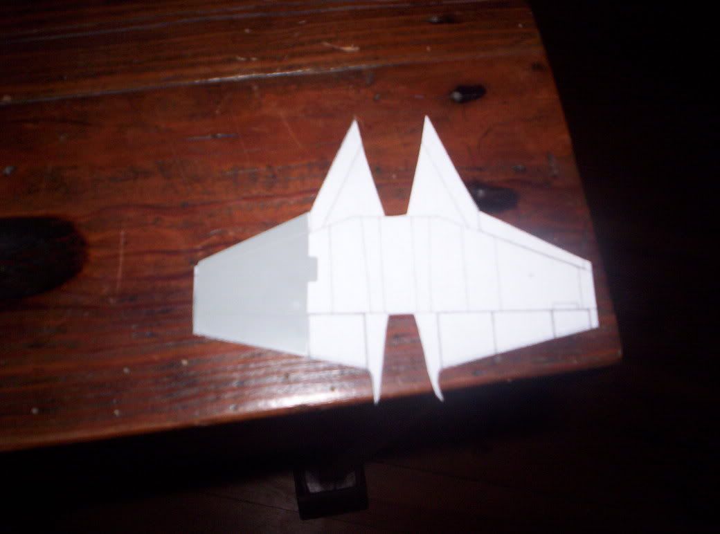

Here's the first step to the wings...
I looked at the span of the Lancer (8m) changed that to 1/72 scale (12 cm).
Then I took the 3-view above (in WORD) an enlarged it up to 12cm. After that, just print the result...and you have amodel of the future wing.
quite surprisingly, I compared this to the wing of an "ordinary" F-104 and find that Loockheed just added the LERX and 1.50m span to the F-104 wing!!!
Just look at this photo...

Archibald
No plastic my friend, CARDBOARD. Much easier to cut and curve...
In fact I glued the "paper" wing on a cardboard sheet. Then i cut the cardboard and obtained a CL-1200 wing. Next step was to glue that to the F-104 fuselage...
This sound complicated, but well it worked perfectly.
I even obtain the marked dihedral (or anhedral)  you can see on the 3-views...
Here's some photos of the plane near finished...
The lines were made (deeply, because of the paint to come) with a pen. That's the great advantage of working with cardboard and paper...
