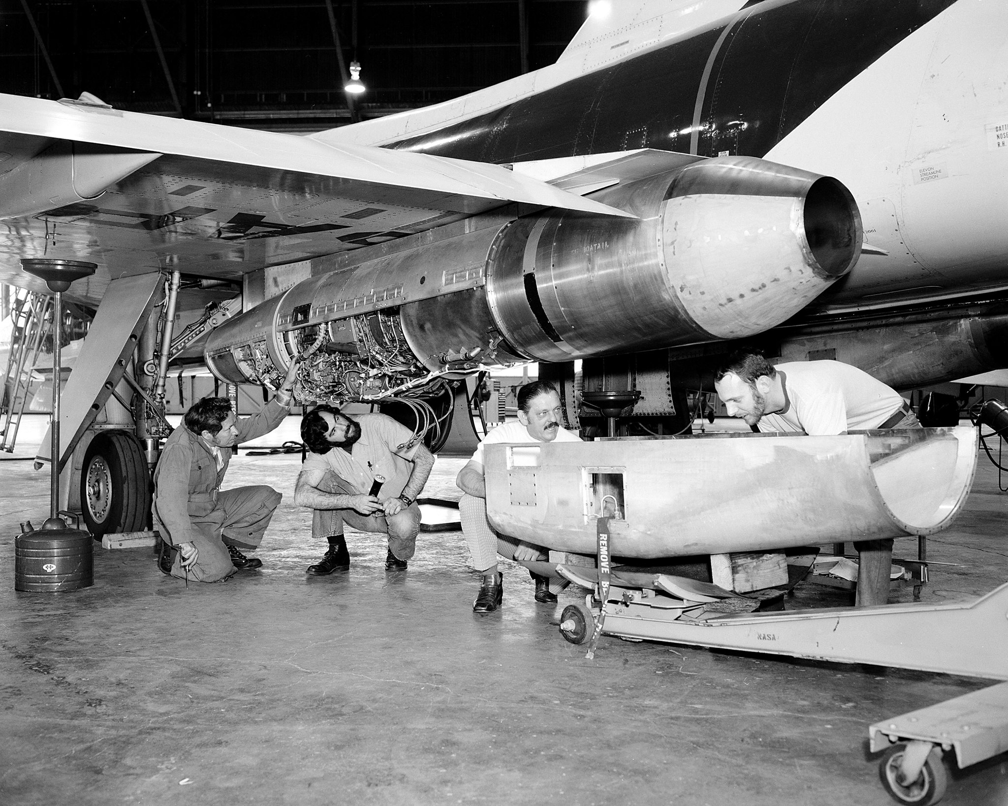

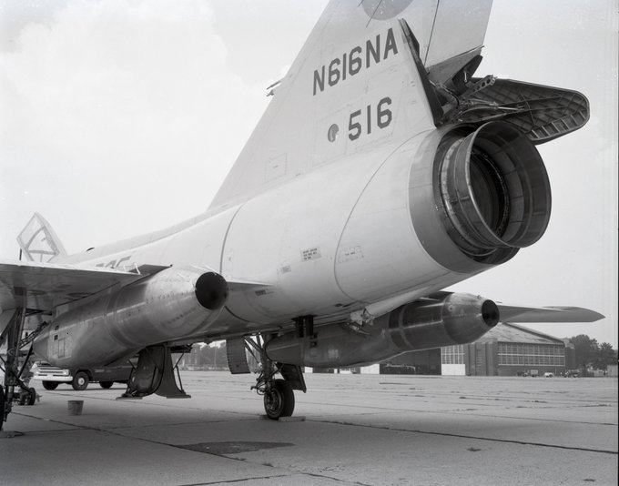

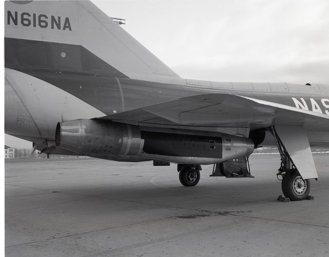

Ever wondered what happens when an F-106 and an F-5 love each other very much? No? Well NASA did... :wacko:
Here's a lot of pics of the F-106B that had two J85s in underwing pods, the point of the exercise being to test different supersonic nozzle geometries.
Posted on Twitter ("X" :rolleyes: ) by Jordan, and several repliers, here: https://x.com/taiwaneseprick/status/1881809591987769374
(The originals are MUCH bigger so if you want to download them, I recommend going to his post)

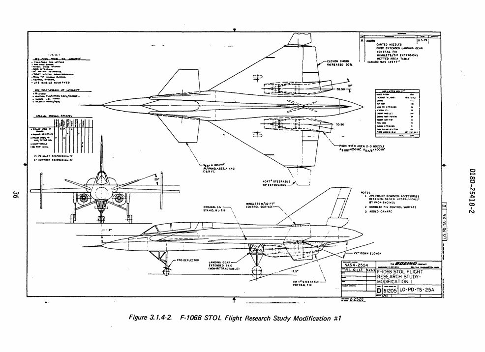

STOL F-106 anyone? :o  Proposals for such a thing posted on Twitter ("X" :rolleyes: ) by Atomic Coyote here: https://x.com/AtomicCoyote61/status/1865603666222440758
I especially like the all-moving tip controllers and wingtip fins seen on the second one, since that's an idea for solving some of the inherent problems of deltas that I've always been keen on.

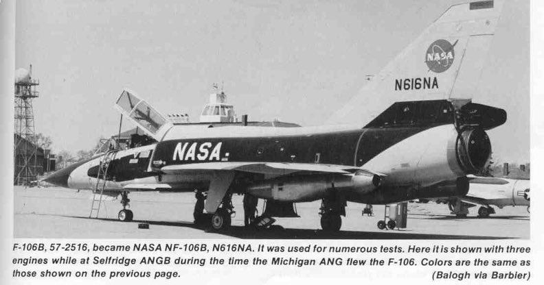

Interesting that the tri-jet 106 still has 'USAF' painted on each wing, even though it's civvie registered.
The JMNs would REALLY point that out if you made a model of it.  ;D

Probably the plan was to return the F-106B back to the USAF once testing was done. I don't know if that ever happened.
scooter
More photos of 57-2516 (N816NA) available here
https://f-106deltadart.com/piwigo/picture.php?/2558
A quick search of the FAA's N number registry indicates N816NA had its civilian registration canceled in April of 92.  My guess it went to either the boneyard, the recyclers, or the bottom of the Gulf as a target.

F-106B 57-2516 is still proudly on display in the Virgina Air and Space Center in Hampton, VA, USA.  She is suspended in the central gallery and still bears the scars of over 700 lightning strikes from when she was intentionally flown in lightning storms for tests.  This was after the J-85 trials.
https://f-106deltadart.com/piwigo/index.php?/category/381
