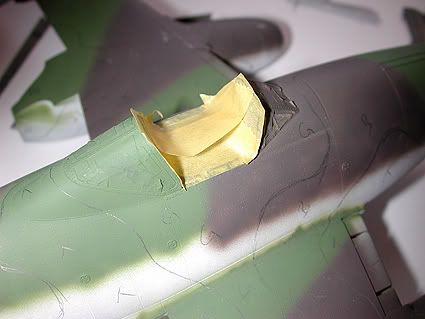

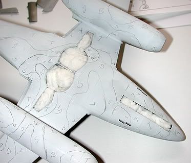

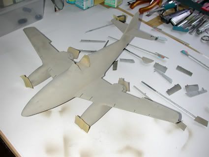

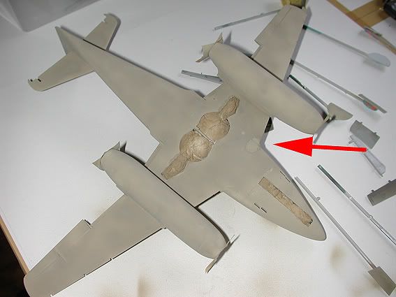

Moments after those shots were taken things got under way! The cockpit area was masked-off and the wheel wells were plugged with wet tissue paper.

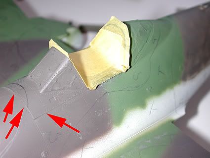

When building the Trumpeter kit be careful not to reproduce what I did here, the front canopy insert will need to be sanded down a little to prevent it sticking up like it now does on my kit!!!! :angry: I didn't realise how bad it was until after it was painted, then I couldn't get the ruddy thing off!!!! :(

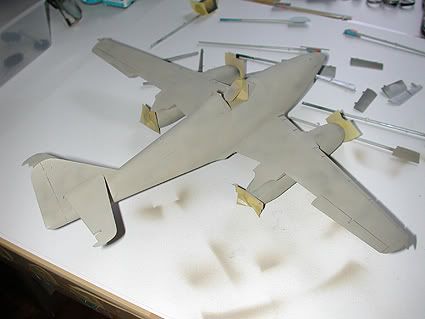

Using my ancient Paasche H airbrush to lay down the base colour of pale green/tan. I sprayed a thin overall coat. Because of the existing camouflage scheme on the model I wasn't too concerned about getting an overall consistent coat, as you can see there is some variation in tone, that is what I was after. Once the second and then third colours are applied, plus all the weathering that will be done on this model you won't notice the tonal variations in the pale green/tan anyway.

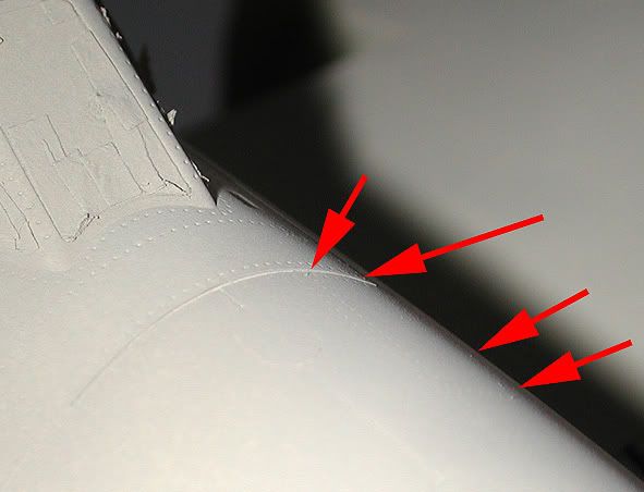

Notice I had a little build-up of thinned paint here. When this happens leave it! Let it dry thoroughly and go over it again the next day. :dum:

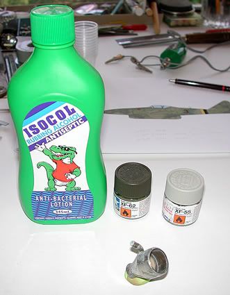

I use Isopropyl alcohol as a thinner for my Tamiya paints, main reason, its cheap! Later on, when I get to the fine feathered edge airbrushing I'll switch over to Tamiya thinner and use highly thinned paint. More on that later. B)
Notice that ridge! Also note the fine 'dust' and a few paint specks that have built-up on the surface. Again, leave these alone, you can always brush these off the next day.
For anybody interested the paint mix for this colour it was
XF-62 Olive Drab : 1 drop
XF-55 Deck Tan : 2 drops
Isopropyl alcohol : 4 drops

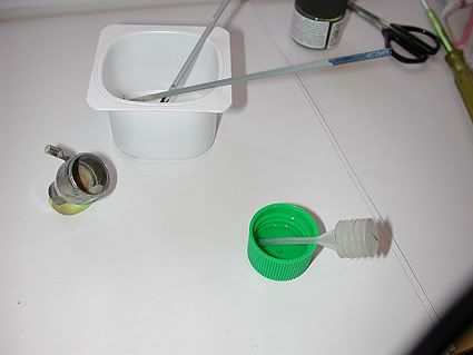

I use cut off sprue for paint droppers and Testors droppers for the thinner.

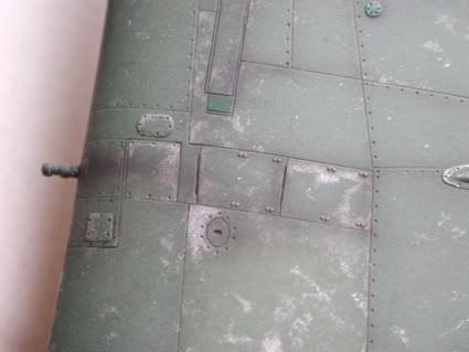

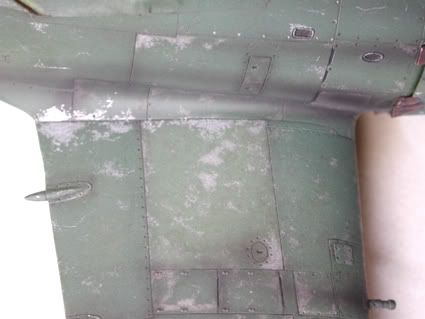

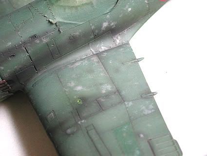

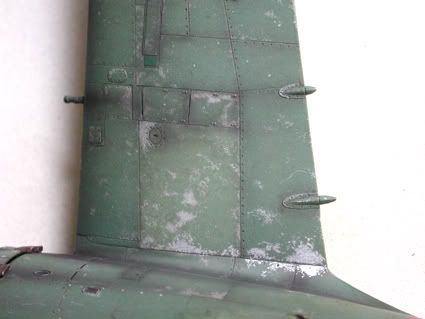

Here's some paint chipping, staining etc effects that I did on a "test" model a couple of years back.
Can't wait to get to the weathering stage with this 262. The reason I picked Africa as the environment it would be operating in is so I can 'go to town' with the weathering. It'll be a great canvass to work on! :P  :unsure:  B)

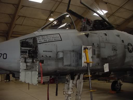

 As far as panel lines go, I was always convinced they were overdone, until I visited a friend in the Air Force, and saw an unwashed A-10:
#9
