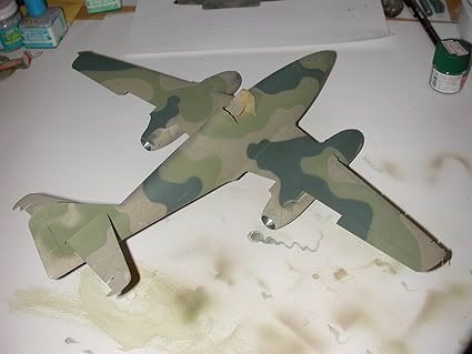

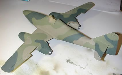

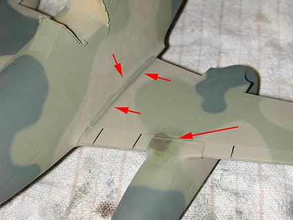

There was one thing I noticed though. On the underside, as shown with the arrows, there was some noticeable staining on the sandy coloured paint, but none on the lighter green? Reason? I have no idea. It may have something to do with the fact that I thinned the sandy colour with Isopropyl Alcohol and used Tamiya X-20A thinner on the green? I'm not sure. If I get time tomorrow I'll do some more experimenting and try and work out what happened.
That may be it, as was noted here recently I hate Tamiya paints and have never had any luck with them, while other people love them. The difference is I've only ever thinned mine with either Isopropyl or De-natured alcohol, while every one who loves them uses Tamiya thinner. I think it was Jennings who said that when he used alcohol he got mixed results too but when he uses Tamiya thinner he loves them.
Does the silly putty leave any oily residue? I've always been reticent to use it but unfortunately it's almost impossible to get Blu-Tac here in the States.
Hi Leigh,
after my experiments today I can assuredly say that when using Tamiya acrylic paint with Tamiya X-20A Thinner that the Silly Putty left NO staining what so ever, yipeeeee! :wub:  :P
Also, over the years (33 to be exact :o ) I've tried all sorts of different airbrushes, enamel and acrylic paint.
The best airbrush I've ever used is the Iwata Revolution. B)
The best paint / thinner combination for airbrushing is Tamiya paint with X-20A Tamiya thinner. This combination, for me anyway, has always been hassle free, simple and easy. :wub:
Richard.

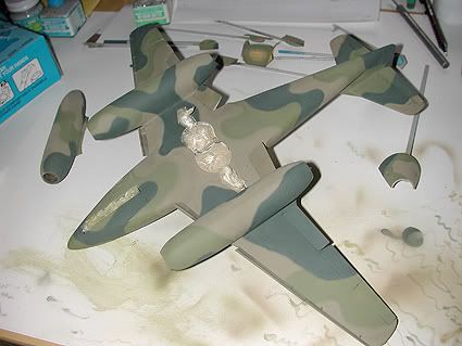

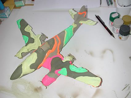

OK gents,
today was an interesting day, I began masking off the Pale Green areas with the Silly Putty, this took me about half an hour. (I began watching my new Doctor Who DVD 'The hand of fear' whilst doing so....ahhh Sarah Jane Smith, she's still got it even after all those years! :wub: .......)
Here it is looking like its ready for the Mardi Gras! :unsure:
Then I airbrushed the Pale Green areas. Slightly different mix this time as I wanted a slightly warmer green:
XF-5 Flat Green : 5 drops
XF-4 Yellow Green : 7 drops
XF-55 Deck Tan : 7 drops
XF-62 Olive Drab : 4 drops
X-20A Thinner : 30 drops
Once dry I tore off the Silly Putty masks. This came off easily and hassle free.
Next I mixed up a slightly different Pale Green /Tan:
XF-4 Yellow Green : 4 drops
XF-62 Olive Drab : 5 drops
XF-55 Deck Tan : 10 drops
X-20A Thinner : 20 drops
This I freehand airbrushed with the Iwata.

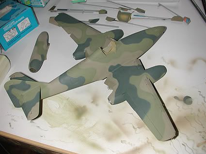

Next I began freehand airbrushing the Black Green:
XF-65 Feild Gray :6 drops

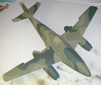

After about two hours of careful airbrushing today I managed to complete the front three quarters of the topside of the 262. So far so good.
I must report that after extensive testing with the Silly Putty on the Pale Green / Tan that I airbrushed today using Tamiya X-20A Thinner that there was NO staining of the paint experienced :P
Now, to cover the rest of the canvas!
Richard.

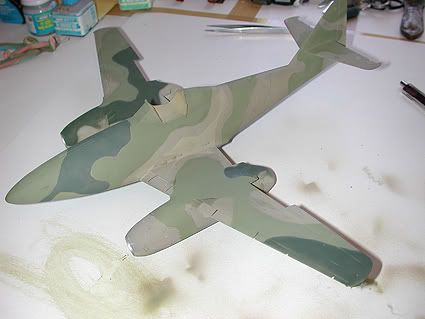

Not much to report today. Spent about 3 hours airbrushing the Black Green and getting it ready for the repair work of the Pale Green / Tan on the underside and touching up some of the Pale Green.
Once all that is done it is ready to begin the detailing and weathering! :P

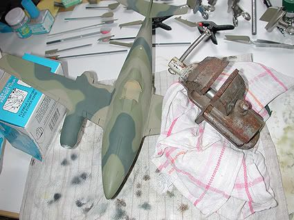

Hit a problem today. During all of the manhandling I've been doing with the model I formed a stress crack along the wing root on the port side. Only thing left to do was to try and re-glue it.
Here you see it with one wing resting on a box of latex gloves and the other being weighted down with a small metal vice to give some pressure to the freshly glued wing join area.
Also I managed to drop some of the Tamiya thin liquid glue of the wing surface! Anyway not to worry, I quickly sponged it off with a tissue and will wait till tomorrow to deal with it. hopefully not too much damage has been caused to the plastic. :wacko:
The wing root join looks OK now. Tomorrow I will give it a light sanding and a re-spray and it should be as good as new.
Richard.

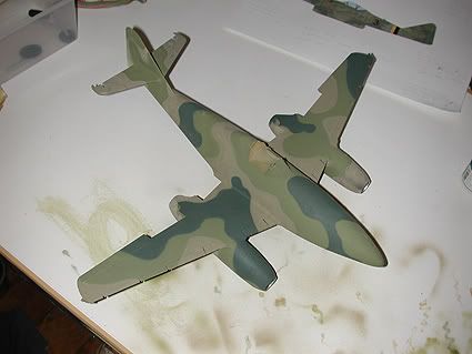

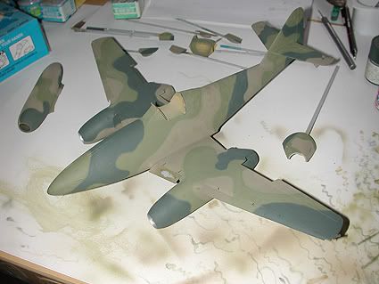

Hi guys,
I've had a few days break from this project, plus with three kids weekends are usually a chaotic event! :wacko:  :dum:
Things were getting a bit tedious with the airbrushing. A patch-up here, a touch-up there. The problem with a canvas this size (32nd scale) is that it inevitably takes a little longer to get the airbrushing done. I think this is day eight? and I've spent about two to three hours a day airbrushing this model. I know the end result will be worth it but I must admit that its usually around this point in modelling that I start looking elsewhere for the next project and the kit gets put on the shelf. But the thought of facing a third year at the local model comp with nothing to show may just spur me on. :unsure:
As you can see I've added all the 'wingy bits', all I have to do know is clean-up and glue marks etc. :angry:
I also took the time to assemble one of the clear engine nacelles and paint the spare gun cover panel so that I can do some weathering practise before I commit to the actual model.
Almost there. I'll do a few touch-ups tomorrow and then seal it with Future ready for the washes and weathering.
