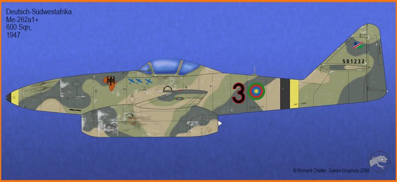

Hi guys,
did some digital work today. I wanted to re-do the side profile to better match how the airbrush job turned out, plus I wanted to try and weather it up as close as possible to how I see it ending up in my minds eye. Doing it this way gave me a better idea of what I needed to tackle and the order in which I need to do it.
With just over 800 views to this thread I realised that there are one or two people following this build so I thought I'd better get it right and do a good job! :o  :unsure:  :blink:  :wacko:  :dum:
For those interested in the 'kills'. There is one USN Venom, one RAAF Vampire and one RAF Shooting Star. :o  Hey, its "What if" OK :P  B)

The profile demands serious respect.
QuoteThe profile demands serious respect.
I wish to be associated with the comments of the previous speaker.

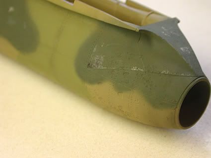

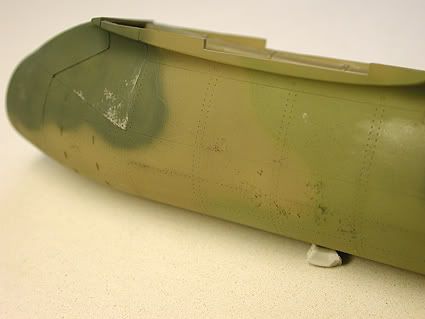

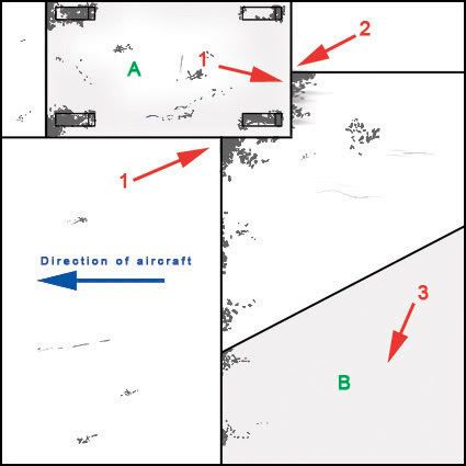

OK guys, here we go with the weathering. First off how do I tackle an issue like this? :wacko:
Well I try as best as I can to begin the chipping effect as "logical" as possible as I'll try to illustrate below.
1) Chipping in corners and along lines aft of the panel line of the airflow (hope you understand what I mean?) :unsure: Also note on panel "A" the chipping around the latches.
2) Don't do all and every corner. Vary the effect. Concentrate on areas where ground crew would be most active and or direct airflow, vibrations etc could effect the paint.
3) make sure to leave some areas plain and unaffected, this helps to break up the effect.
Note panels A and B are painted slightly darker. Its very subtle, and that's the point. You may have noticed this on my Ki-84 back a few pages?

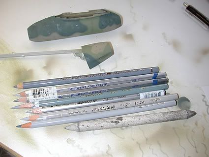

What do I use:
Well, here's a pic of the usual suspects :P
Here's a list of the pencils:
Faber Castel Polychromos 233 Cold gray IV
Faber-Castel No.57
Sanford Prismacolor PC1051 warm grey 20%
Sanford Prismacolor PC1063 cool grey 50%
Sanford Prismacolor PC949 metalic silver
Derwent Metalic Pewter 81
Derwent Metalic Silver 80
A word of warning too, I also purchased a Faber Castel Polychromos 251 silver. This pencil tended to flake when applied to the model and is therefore useless for the job of chipping. :(

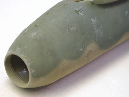

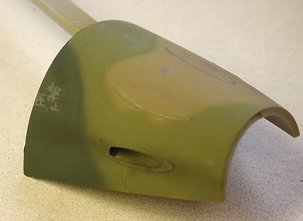

I decided to practise on the 'spares' before committing to the model. I started off with the Faber Castel Polychromos 233 Cold gray IV. This gives a nice grey chipped effect. I use it at this initial stage like an artist would do a pre-painting on the canvas just to get some colour / effect down and get a feel for where to go with it. Having a plan before you commit is always a good idea, but not essential. If, after reading / looking through all of this you are still not too sure all I can suggest is that you just simply "go for it", if you stuff it up don't worry too much, as long as you've learnt something you'll always improve next time. Which is what its all about really, having a go, making mistakes, learning from them and moving forward. :D
The brighter silver you can see further back on the engine pod is Sanford Prismacolor PC949 metalic silver. I put this on just to get an idea of the contrast between the grey and the actual silver. At this stage I'm still trying, checking, analysing. The technique I use is to lay down the colour using very small dots with a very sharp pencil tip. I never "colour-in" and area, I always make up the shape with dots. I also lay the pencil flat to highlight corners etc. I'll illustrate that effect later on when I'm doing the actual model.
The dark marks on the tan and light green was achieved with a sponge and some dark green paint. Not sure at this stage if I like the effect?
Most of the chipping done here was using the grey. I strongly suggest using a grey first and moving on to an actual silver pencil later. You don't want to make it too stark so be cautious at first 'till you get the idea of what your doing.
