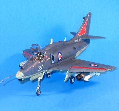

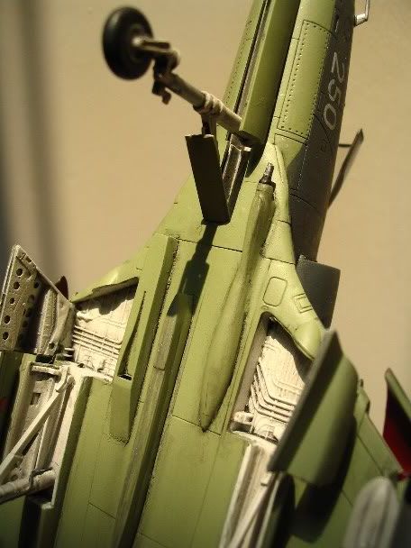

When I built my RN Skyhawk I put a single Aden cannon under the left fuselage in roughly the same spot as the Israeli DEFA cannon installation.  I scratchbuilt the gun out of half a tiny drop tank or bomb and the part of an F-100 refueling probe that glues to the wing.  I didn't have any good reference material for the DEFA installation at the time so I just winged it based on the one picture I could find.
I just picked up a Hobbycraft kit that has the DEFA guns, and while my Aden is larger, I'm happy with the result.
I also added a LRMTS (the laser seeker in the Harrier GR.3, Jaguar, and Tornado GR.1) under the nose, just made from an odd fairing sanded to fit the contour of the nose
Also, most UK hardware of the 70s had the Radar Warning Receiver up on the tail.  I made mine by gluing two strips of styrene  to the tail in the appropriate spot, then when dry I trimmed them to the right lenght and filled the space between them with more styrene, then finally smoothed it all over with Sqn Green putty.  I hope that description makes sense!  I think technicallt my RWR is only forward hemisphere, but with the A4 rudder it was hard to make the full 360 RWR that is on the Jaguar and UK Phantoms.  Instead the rear hemispere RWR is hidden (even from me) somewhere else around the tail.
I may have some 1/48 1 & 3 Sqn decals from Monogram and Airfix Harriers in the stash if you need them, just let me know.
Here are a couple of pics that may be useful for reference.
you can see the cannon under the old cannon installation, the LRMTS under the nose, and the RWR 3/4 of the way up the tail.
A closeup of the cannon.

Oooh me likes the sound of this development! But then again I love anything to do with A-4s!

Thanks again, you're all great!  And the Skyhawk looks fabulous.
Depends on Daryl's time scale - as a straight GR5 role, the RAF used the ARBS that was fitted to the AV-8B (and A-4M).
Similar for the RWR, fin tip and wing mounted bumps might be more appropriate.

If memory serves me right, the fincap thats on the stock OA-4 is a RWR, so you wouldn't need to do any further additions to the tail.

I could very easily be wrong, but the fintop antenna on the A-4M may be the IFF.
