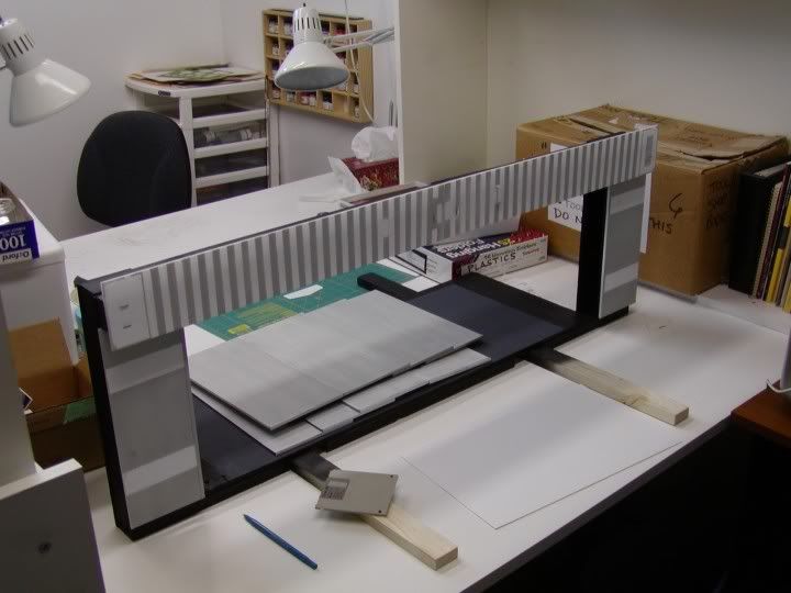

QuoteHere's a tip for finding sheet styrene: I'm told those "House for Sale", "Beware of Dog", etc. signs you see in home improvement stores are made of sheet styrene.
NON!  When building my giant hangar backdrop diorama a few years back, I found out that corrugated plastic is nearly always made out of polyethylene, not styrene.
You CAN get it in polystyrene but test it first.
All the stuff I built and painted with the stuff I had thought was styrene-based eventually fell apart by its own (light) weight!  While they can thermal-print signs on it very easily, you'll find paint and glue slips off it the way it does on a plastic food container lid.

Wow! That seems to be a very big scratchbuild!!  :P
