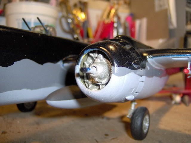

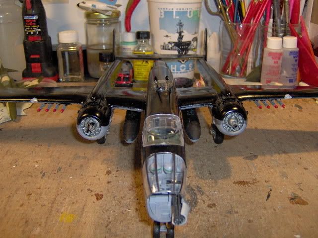

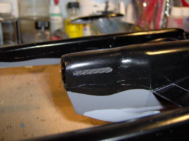

Small progress report for this evening. I've added a some underwing rockets and drop tanks. Also added the pipes for the Merlin. :party:
  Eddie
Oh wow....that head-on shot is imposing!
Rafael
Is like looking at Mr. Death Himself in the face!!!
Terryfying sight!!!
It keeps getting better
Rafa

Oh man that head-on shot makes me want to run and hide behind the sofa! Having that gat screaming down on you from above would certainly make you have an accident!
Another masterpiece in the making, Mr Miller!

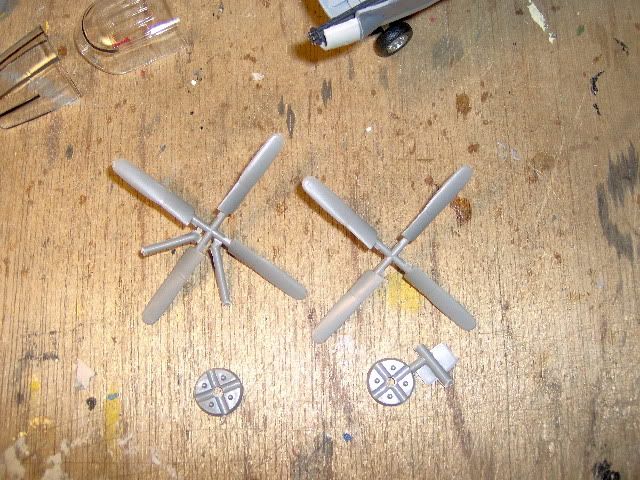

Thank you all very much! B) I just got a nice package from JHM. It's got some very sweet P-51 props. B)  B) Thank you very much Man Ho! ;)  :) Now, I want your opinion. The props have pins molded into the back of them. I already have the prop shafts installed on the Pusher. How would YOU install them on this bird? I'm very interested in seeing what y'all come up with. :)
   Eddie
Cut off shaft on engines & drill hole to take the props?  You could do the opposite, but there's more potential for disaster.
Or you could remove the shaft from the props & leave a small stub on the engines & simply butt-join them.  Might be a little weak, but you could reinforce them by drilling tiny holes for a wire support.
elmayerle
It depends on how sturdy I want things and how much effort I want to put in.  The quick approach of a butt joint could be reinforced with a pin, or equivalent, down the center.  I really solid joint would require some fancy trimming to do a splice of the two shafts - not for the faint of heart or clumsy of blade.  Another alternative would be to drill out the prop and use the existing shaft.
As I said, what exact approach I'd use depends on the time and effort I wanted to expend on it.
--Jane Wagner and Lily Tomlin
Glad to hear they got there alright.  Decals usable, too?
Technique? I'd keep the shafts on the model's engines and remove the props' shafts.  Once drilled out to match the shaft from the engines, I think the shallow insertion of the engine shaft into the backing plate's own hole will be enough of a joint.
Cut each indivudual prop off , and then glue each one to the backing plate, which already has a hole in it, and are nicely dished out to accept the seperate blades. Then you can cover the whole caboodle with the spinner.
She's looking great, btw, Eddie ! Keep up the great work !
frank2056
I would glue the props to the backplate, making sure that the blade shafts were fully glued to the backplate. Then when dry, flip the backplate over and drill an engine shaft-sized hole through the backplate's center hole, taking out the center of the now glued blades.
