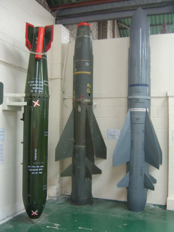

Here's a pic of WE.177, Martel & Sea Eagle I took at the Yorkshire Air Museum:
The WE.177 doesn't have any banding in common with Gengriz's reservations about Nuclear weapons not being banded, although the canister at the top is orange, but I don't know what it is & it's relevance to the bomb.  It's marked 'Training', so I guess it should be blue rather than orange anyway.
The Martel has a yellow band forward & a brown band (hard to make out, just above the brace) behind.  So I guess this was a live round at one time, hope it isn't any more cos there were a few kids playing about on the Canberra noses just to the right of this pic!
The Sea Eagle has a dark blue band forward with a white band behind marked 'Instrumentation'.  Anyone know what the white band was for?
AeroplaneDriver
Mossie-
I took almost that exact shot at the YAM in August!
I am very likely wrong, but I seem to recall reading that the orange canister on the WE177 contains the umbilicals which attach to the aircraft.  The WE177 at the North East Air Museum at Sunderland has the same canister.

The orange markings for nuclear weapons certainly existed - somewhere I have a photo of a live WE177 with orange bands
