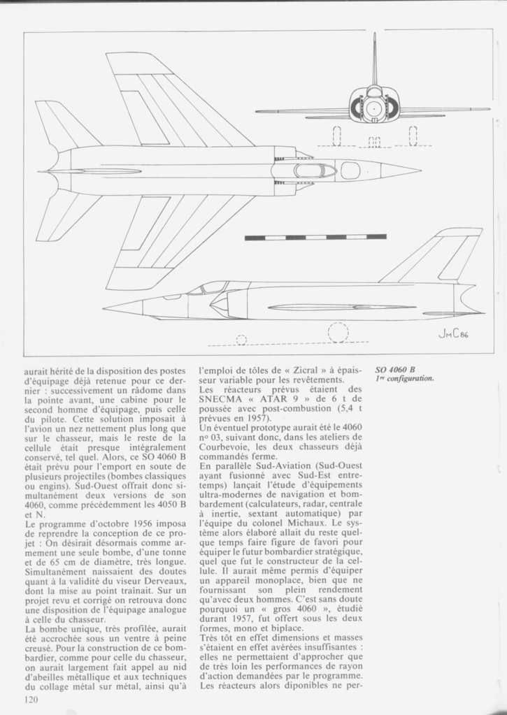

This was the follow-on to the Vautour, and competitor to the Mirage IV in various competitions (naval heavy fighter, all-weather interceptor, and light bomber in the end).
A prototype was started in 1956 (all weather fighter) but stopped after budget cuts in 1957.
here's a pic ( from Jean Cuny, les avions de combats francais 1945-1960)

Have you dimensions for the SO-4060 as i might have an idea for a a better source kit to use as a basis after looking at the drawing.

Dimensions of the model are for the 4060B Ie the second column

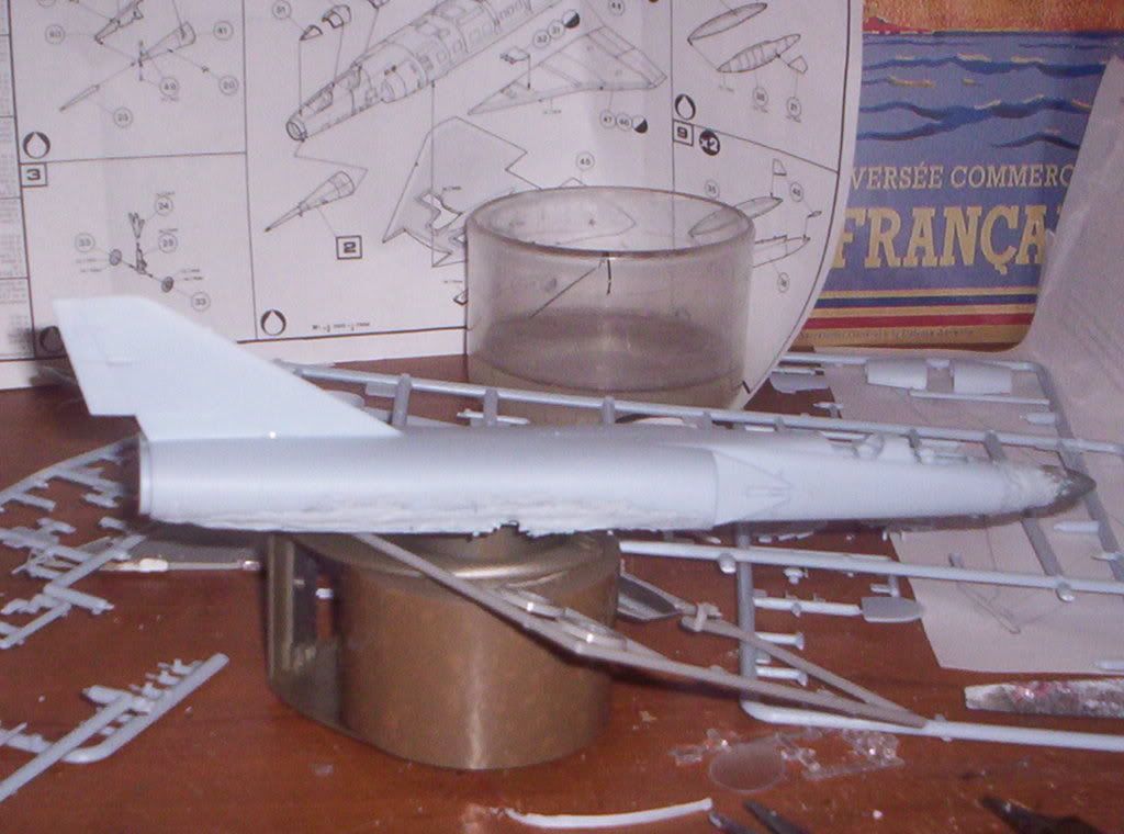

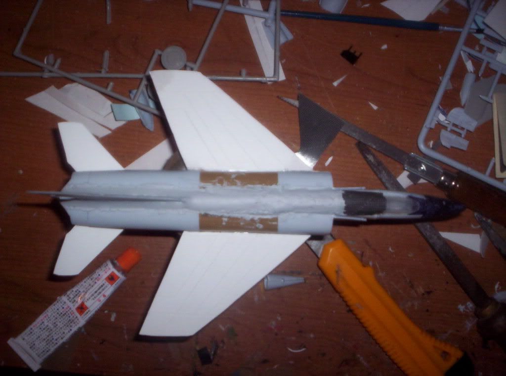

I agree, it has to be shortened (from 23 m to 19 m or so.... 4 meters mean (1/72 scale) 5.5 cm... not too difficult, cut will occure in the middle of the fuselage, at constant diameter.
I erased the delta wings roots, and filled the gap with putty (what's the difference between putty and milliput ?  :wacko: )
It actually dry... wings made from styren sheets, horizontal tail from the MiG-25 (it fit well). Most difficult thing is what Le Fana de l'Aviation call "Mitres" (Bishop's cap). You now, the pointed rear-end of the aircraft, around the engines... this also existed on the Grognard strike aircraft of 1950...

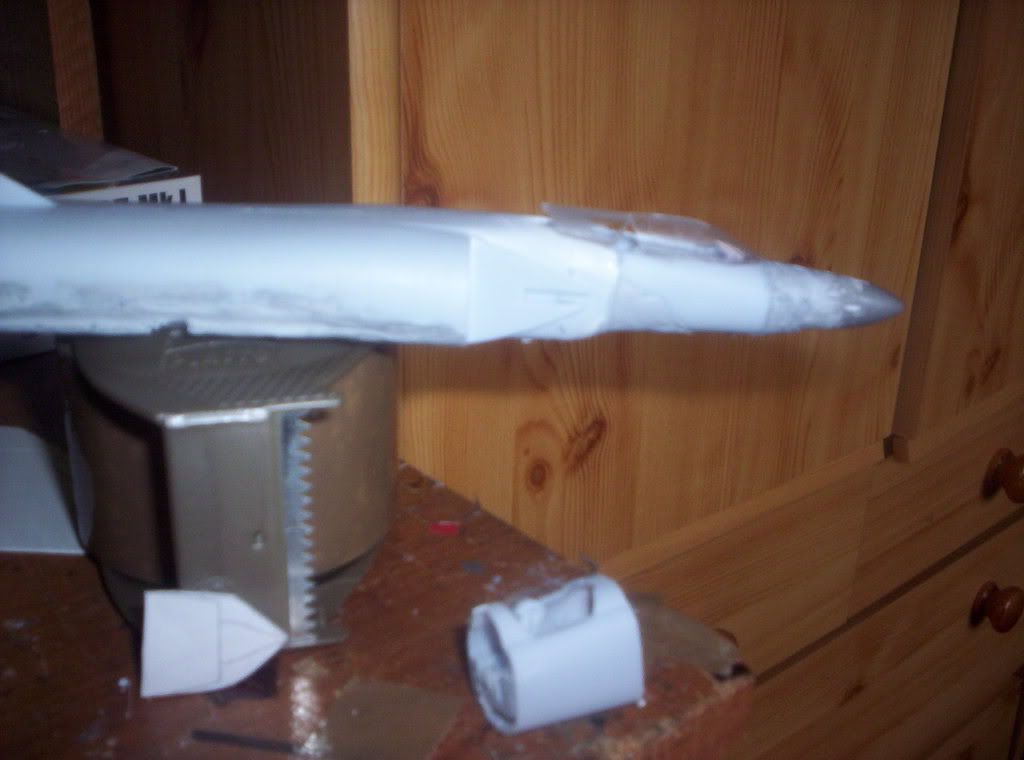

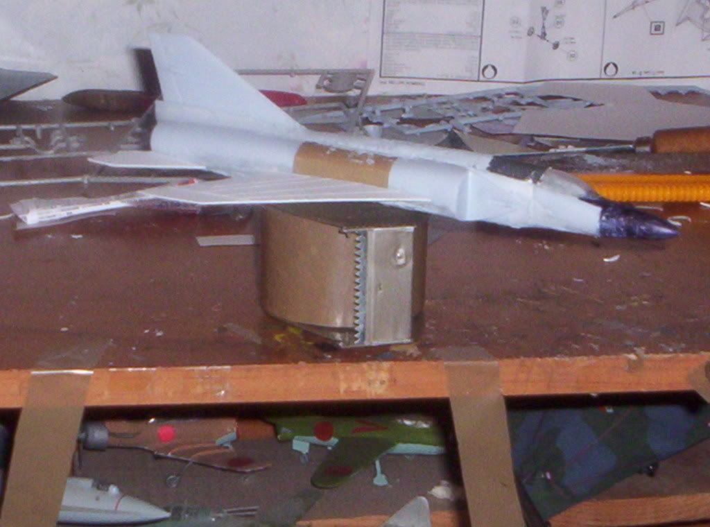

Heavy surgery this morning: I have to cut the rear cockpit of the Mirage IV and glue the forward cockpit in the air-intakes area. As JHM send me a small saw (much more efficient than the monster I had before) it was quick and neat.
Main problem: the MiG-25 canopy I plan to use need a dorsal spine behind it... I know how create one. I'll use the  windshield of the -deleted- rear cockpit to make a U- shaped tube of paper. Then this will be glued to the canopy and on the back (on the rear).
Other problem : the forward cockpit had a smaller diameter than the fuselage at the level of the intakes. I "adapted" the fuselage, and filled the gap with putty...
There's also the air intakes : in the Mirage IV, the "lips" nearly mask the  shock wave cone (Souris or mouse). If you look well the pic, in the SO-4060 you can see the "souris" nearly enterely. the "wall" separing the intake of the fuselage also have a different form : in this case, it is larger than the intake itself.
But with styren sheets, all can be corrected :)
Here's the whole thing in just one photo... (better than a long page of typo :rolleyes: )
Rear cockpit, air intake "form", canopies and model!

To obtain various forms (wings, air intakes) I needed this picture.
first, I copied it in a WORD file.
Then, I calculated the dimensions of the aircraft in 1/72 scale.
After that, I enlarged the picture up to these dimensions.
I printed it, and obtained a model of the wing (in paper).
After that, I cut this paper model, glued it to a styren sheet and cut the plastic (including the panel lines).
Et voila!
