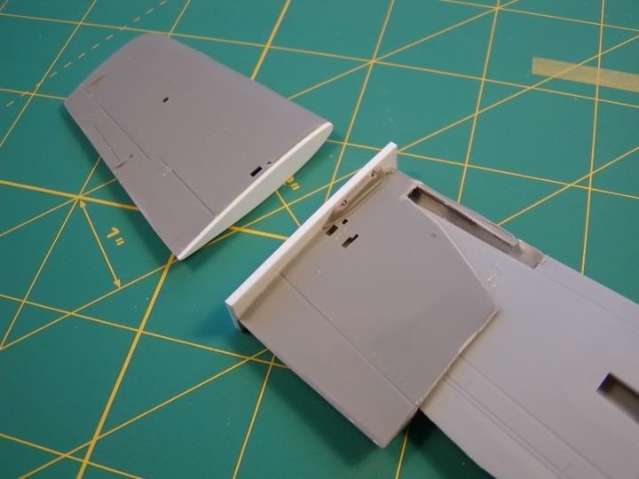

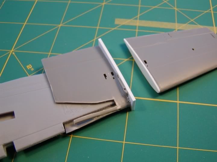

Wings have been cut and capped off with sheet styrene which will be shaped to allow the required wingtip dihedral when re-attached.

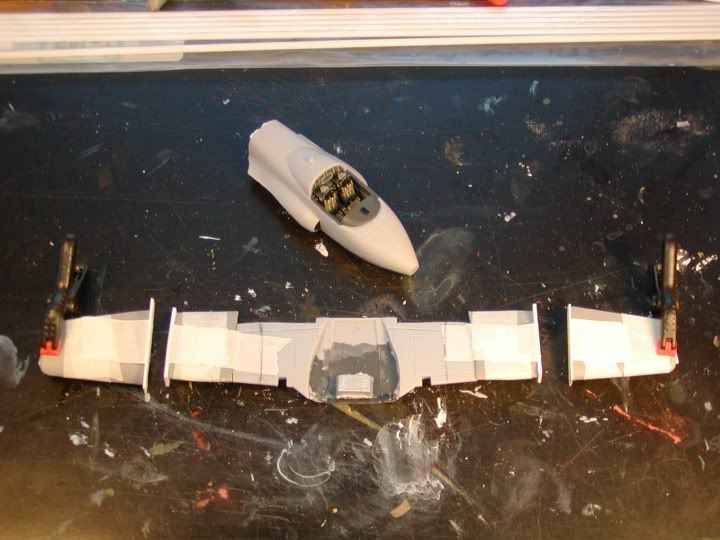

And some fun yet to come with the aft fuselage section:

Now, for the tough parts: wing clean-up.  You can see the voids left behind from modifications made to the Mustang wings.  Yikes.

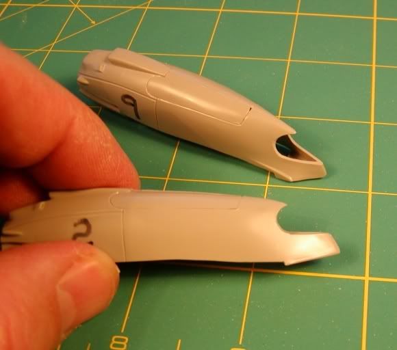

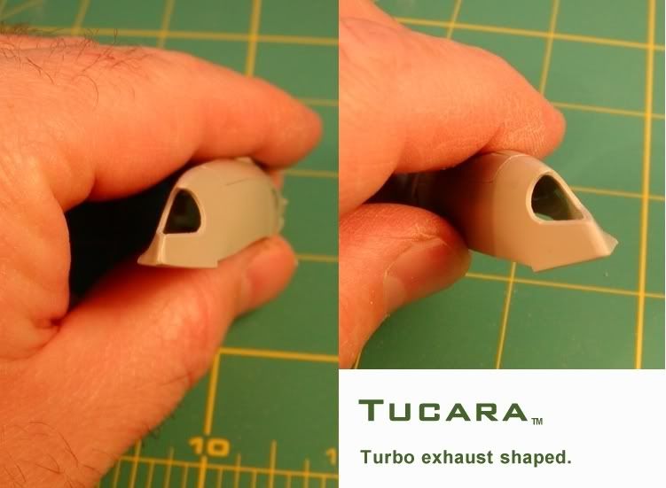

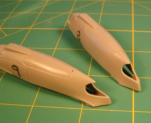

Had to cut out and shape some turbo exhausts from the back of the Mossie nacelles.  Little nerve-wracking at this point because any slip with a drill or file would have truly sucked as I have no back-up Matchbox kit for the parts.
But both nacelles turned out okay.

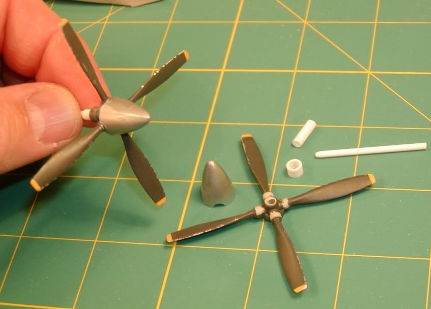

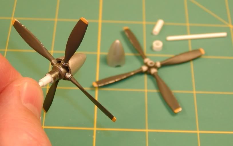

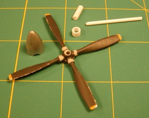

Prop parts.  Blades are modified from a Tamiya 1:48 Raiden.  Spinner cone was cut and shaped from an F-84F fueltank, including half-round notches to fit prop blades.  Other styrene bits in white are the parts needed to make a rotating shaft assembly (took 20 minutes just to bore out that darned middle sized tube, too!).
This way you can see the parts along with a finished product:
