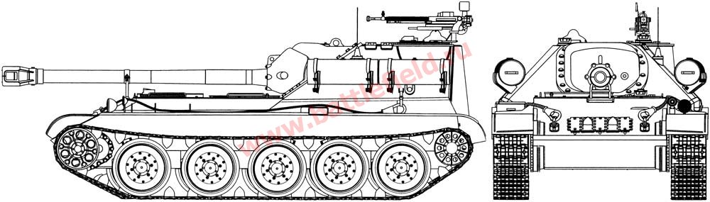

Hey hey hey, what says we do it like the VK4502(P)?  ;D
Of course up-armouring the glacis would still be complicated by the hatch, but would this weight distribution at least have been just a tiny bit better?
To-do list here
Logan Hartke
Damn, but hat assault gun in the first pic looks great!  :wacko:

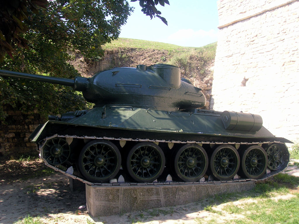

on-one's mentioned the "Teski Tenk Volzilo A" (Heavy Tank Type A) -- a 1949 Yugoslav mod. of the T-34/85, it had a new upper hull & turret.
The hull was wedge shaped in plan with front facets for better ballistic protection, the turret was cast in a potato shape.  It's arguable that the new turret was ballistically better due to the two side-protruding crew cupolas.  It used the same gun with a new muzzel-brake, a new local diesel engine and auxiliary fuel was carried in "D" shaped containers based on the Russian cylindrical ones.
Overall it had less internal volume than the standard version, was only marginally better than the standard T-34 and only seven were built as T-54's were made available.  Two remain as museum pieces, one in the "fort" in Belgrade.
It would be interesting to see a what-if on these facing Soviet T-34 / 44's in an uprising for independence.
Mmm, those cylindrical cupola housings are actually worse ballistically than the enclosed ones and would invariably be thinner armoured as well as presenting shot traps (as does the overhanging turret/mantlet).
Logan Hartke
Indeed.  Pretty does not mean usually better in the world of tank design.  If it looks sleek, it usually means shot traps on tanks.  That having been said, it was the best-looking T-34 made.
