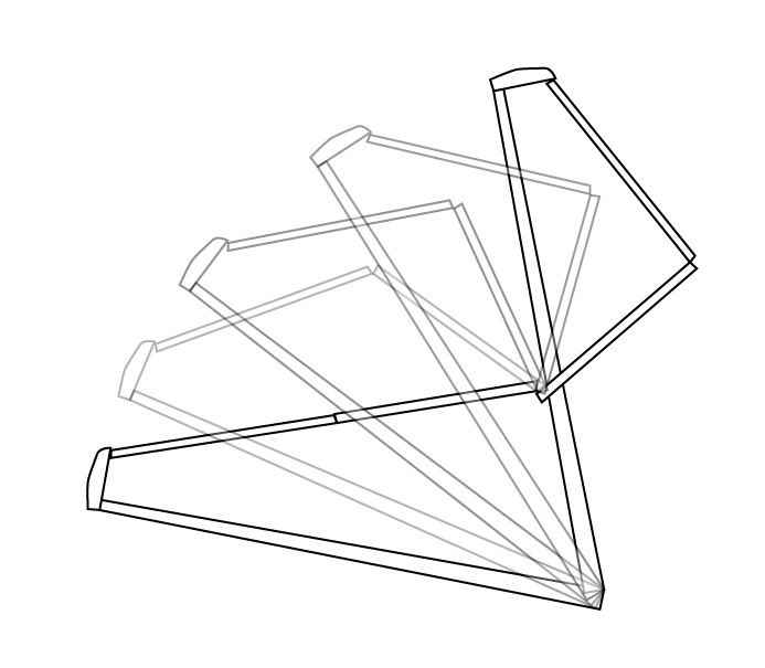

Kitflubber, are you able to do animations of your model? If we animated the wing fold we could see what's possible and what isn't.

How would you handle folding the wing at the root?  I better buy more Bondo.

Here's a kind of fake animation with a progression of superimposed images in Illustrator. I think the upper hinge and the pivot for the all moving surface should not coincide. Maybe move the folding hinge into the wing root a bit.
kitflubber
It looks like when it reaches the top of its fold, it would make sense of the outermost hinge to latch again, securing the wing in the upright position! Slick!

Planeman -- Irealize I did not get the positions of the wings right -- the hind wing sits outboard of the forewing. Should not affect the viability of the design.

Clearly it'd need four hinge points per side, so eight in all. that's a lot of extra weight.
