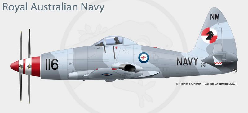

Anyway I began the model on the 14th of March and have until the 4th of April to get it done. I've decided to build the Trumpeter 72nd scale Wyvern and will be finishing it in this scheme.

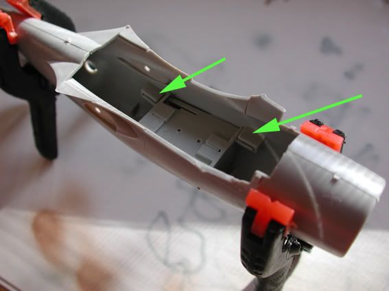

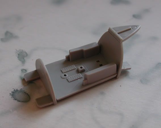

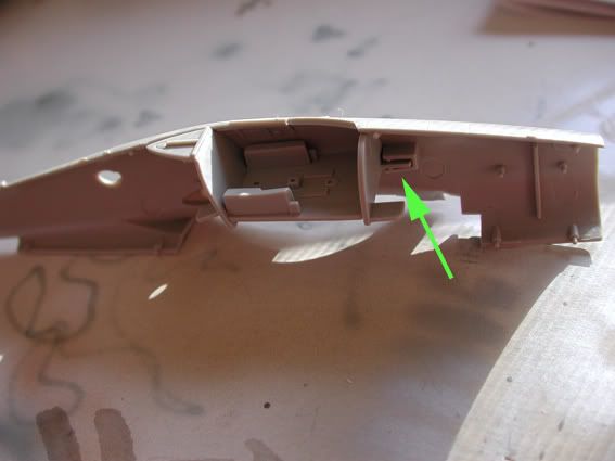

With the basics of the cockpit glued
I inserted (not glued!) the cockpit into the fuselage side
and clamped (but not glued!) the two fuselage sides together to make sure the cockpit set with everything aligning properly
Now the cockpit is set and I can add the rest of the parts to it and paint it.

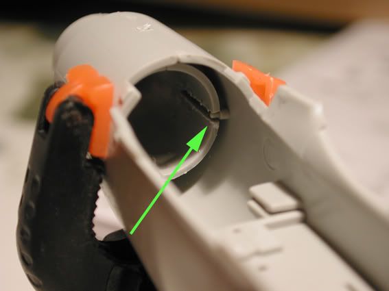

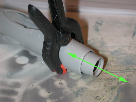

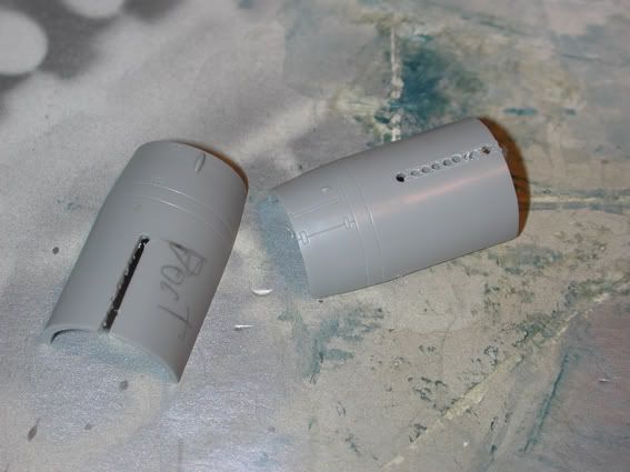

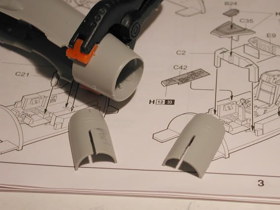

The next thing I wondered about was if I could somehow make it so that I could insert the propeller assembly at a later date in order to make painting and clean-up a little easier
So I marked out and drilled out a slot in parts A3 and A2 so that once the fuselage was assembled I could easily slot the propeller assembly into the nose.
It didn't need to look "pretty" because it wouldn't be visible once the fuselage was together. ;)

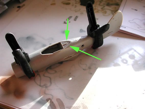

Are you blanking the camera windows as per your profile, or have not decided yet?

Yes David I'll be blanking the camera windows, well, painting over the clear parts in this case.

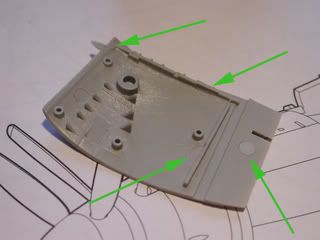

Here we see the underside of the top of the inner wing section, parts B11 & B14. As you can see there is a major ejector pin mark to fill. I used Mr Surfacer 500. Also there are some other ejector pin marks that will need to be shaved off.

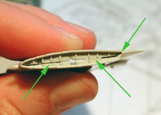

Here you see the resulting gap/fit problems caused by the offending ejector pin marks.

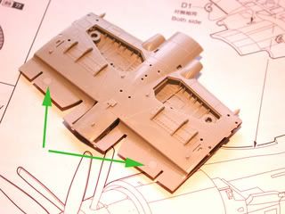

Here all is taken care of. Fit was very good. Don't forget to fill those ejector pin marks!

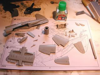

Here's where I'm at as of today 20th of March. Next I can begin to paint!
