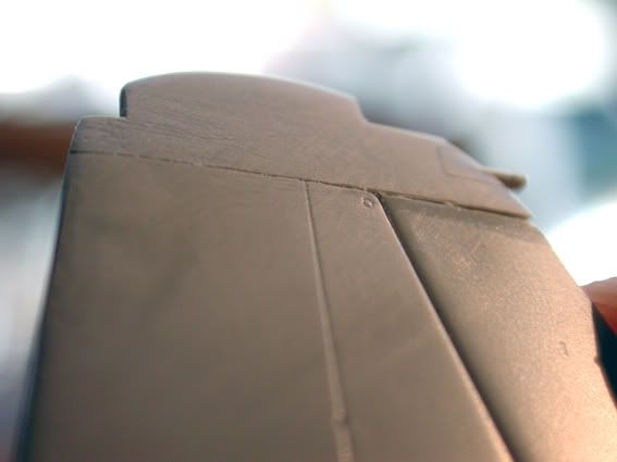

Applying the wing tips is a little tricky! What I did was ensure a good fit on the top of the wing, which left a step on the underside.
Here we see the step has been shaved and sanded off, only took a couple of minutes. Still a little more sanding and a bit of polishing needed.

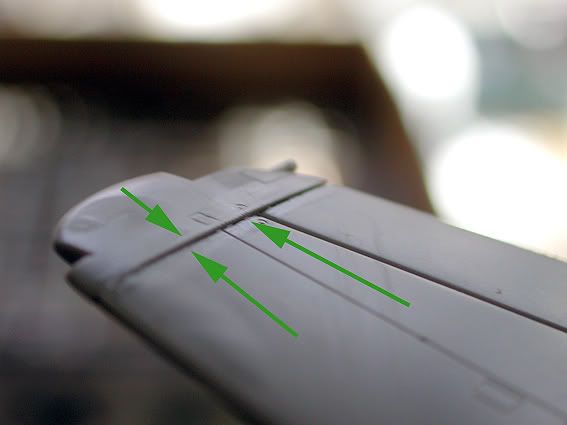

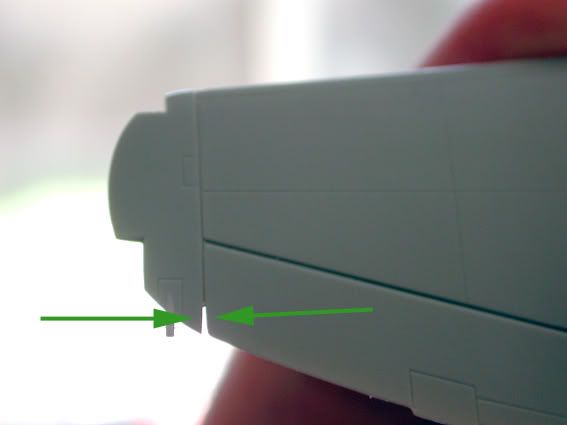

As you can see there is a little gap between the wing tip and the aileron, this could have been reduced by spending a little more time checking the fit, so learn from my haste! :dum:

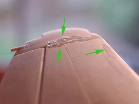

Here we see super glue added to the underside gap. It will be sanded and polished and re-scribed, also note the scribing slip that will need to be dealt with! :wacko:

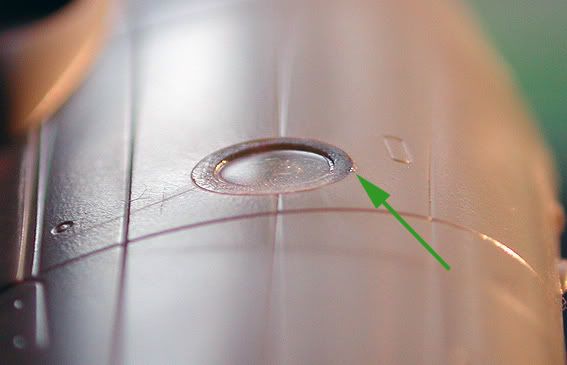

Here we see one of the camera ports glued in place, no problems except that tiny little bubble at the bottom. Keep in mind just how magnified these images are, after all its only a 72nd scale model.

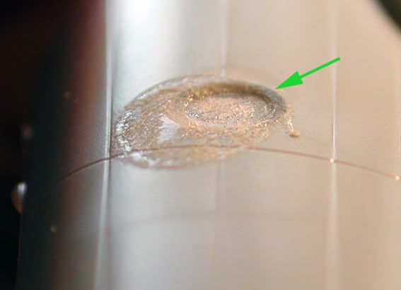

Disaster! :angry: Being a bit too hasty with the liquid glue! :dum: This will take me a while to repair, so again, learn from my error and don't be too rushed and take your time. :P

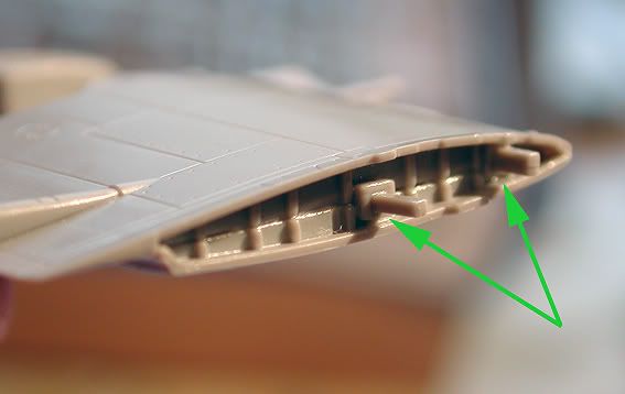

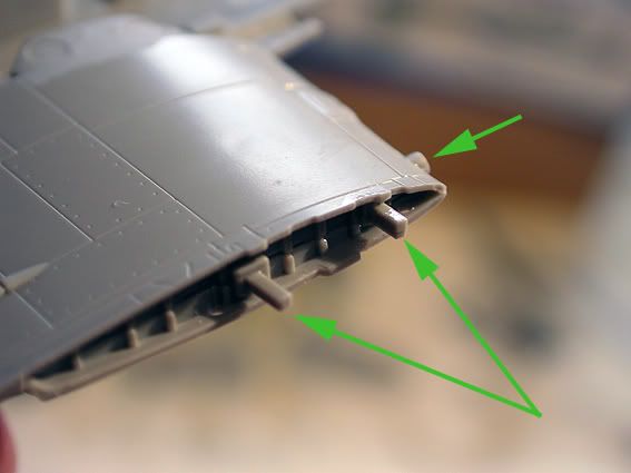

Here we see the 'posts' that help with gluing and aligning the wings. Test fitting has shown the fit of the two wing pieces is very good.
Take note of the angles of these 'posts'.

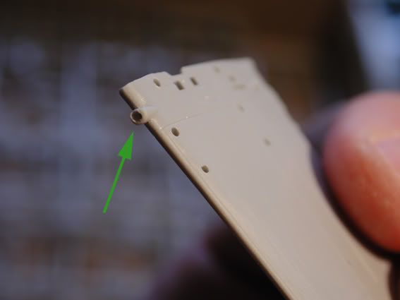

Here we see the end of the gun stub cut off to receive a barrel later on.

On using the superglue, how long before you start sanding the stuff?
I really wouldn't worry too much about that Richard.  We tend to forget that real life aircraft don't always "fit".  I'll never forget the horrendous gaps on the Me262 me and NARSES saw at the RAF museum!

QuoteOn using the superglue, how long before you start sanding the stuff?
Allan, I usually leave super glue for a couple of hours before I start sanding it.
One thing I learnt the hard way though is not to leave it for a couple of weeks because it goes rock hard and is impossible to sand without destroying the much softer plastic around it. So definitely don't leave it for too long before sanding it.
That particular wing tip was left for a day and a half before I got back to it and it sanded fine.
Also only ever work on small areas at a time.

QuoteI really wouldn't worry too much about that Richard.  We tend to forget that real life aircraft don't always "fit".  I'll never forget the horrendous gaps on the Me262 me and NARSES saw at the RAF museum!
Ah yes Nev, but when your a recovering anal retentive things like this can make your heart skip a beat! :lol:  :lol:

As for the "anal retentive" bit......when pushing a Spitfire into its parking space a few years back, after it'd flown into Coventry airport, I noticed that the gap at the wing joint was huge, definitely at least half an inch in places......
