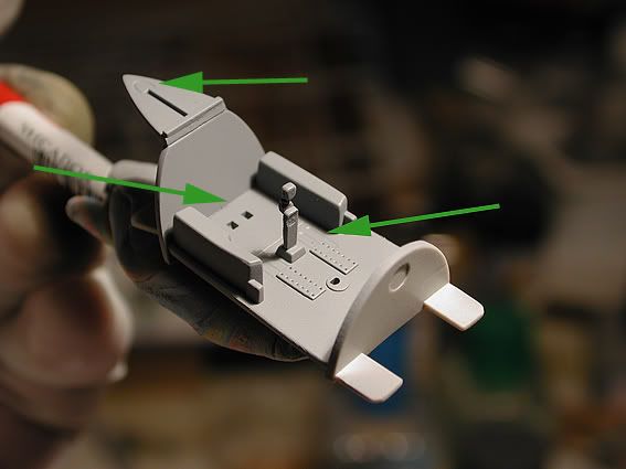

First airbrushing was carried out today. I tried a little experiment by adding 50% Future into the Tamiya paint / Tamiya Thinners mix to see if it would airbrush OK and leave me with a suitably glossy finish for adding a wash to. I think it worked out fine, but will be able to report better tomorrow when I apply the wash. The green arrows show the reason for the experiment as they highlight the areas I want the wash to go.

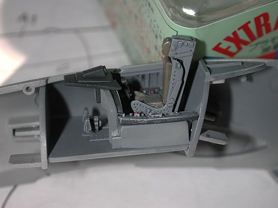

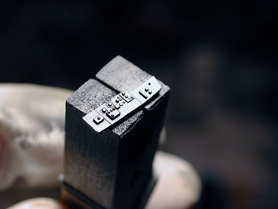

I drilled out the instrument bezel depressions and painted the panel with NATO Black. I will drop Tamiya Clear into them later, once the instrument dials have been added to the back, and the panel has been dry brushed.
Here's the seat painted, now awaiting a wash, some dry brushing and the cushions added. Should the seat be all black?

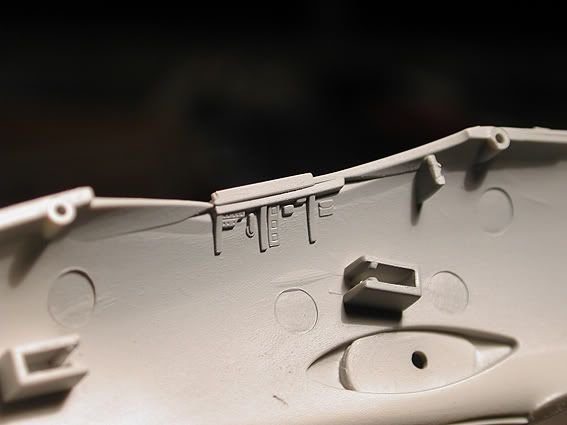

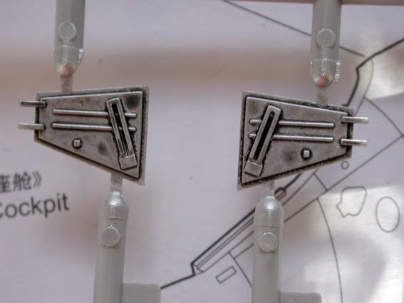

Port and starboard cockpit sidewall detail as provided in the kit. Sprayed with the 'Future mix' it will be ready, "theoretically" tomorrow for the washing process.
I also sprayed the NATO Black with a little Future too. I used NATO Black as it still leaves a little "tonal room" for shadows with Black during the washing process. B)

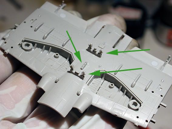

Here the torpedo mounts have been added.

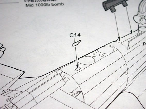

Ah, yes good old part C14! Just as I was holding it in the tweezers and thinking to myself that it was a very difficult part to hold whilst trying to scrape and sand, it disappeared into the Twilight Zone, never to be seen again! It disappeared so quickly that I couldn't even tell you which direction it went in :rolleyes:

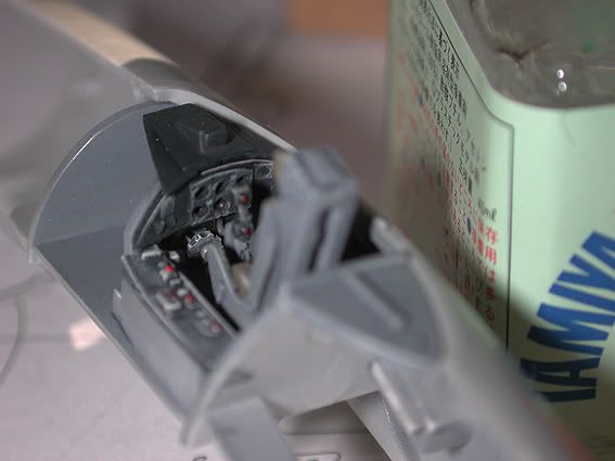

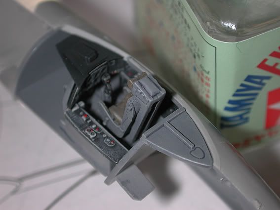

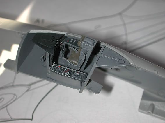

Completed cockpit installed.
Don't bother with the instrument panel details. Once the fuselage is closed up you won't be able to see too much of it anyway.

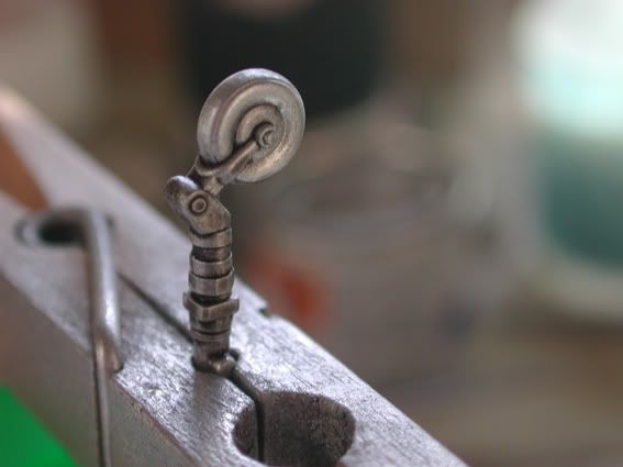

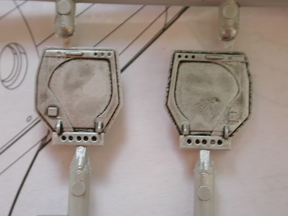

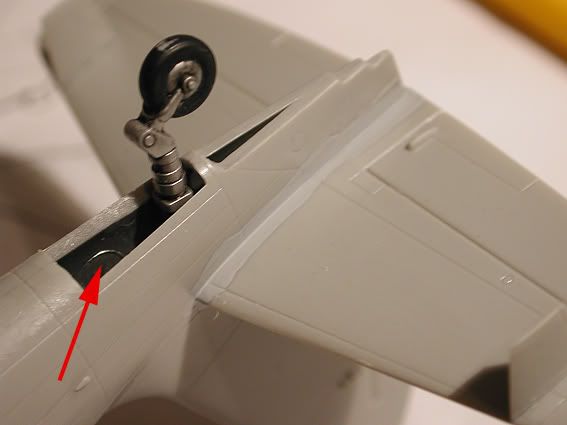

Tailwheel and main undercarriage doors with their initial wash of oil paint thinned with White Spirit. The silver enamel is Humbrol Metal cote 27002. A coat of Future was brush painted on to seal the silver before the wash was applied.

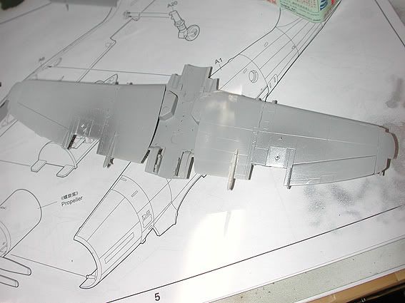

Wings glued together. I was quite pleased with the fit. I haven't applied any Mr Surfacer yet, I'll put a light coat of paint on first to see if the small gaps are acceptable or not.

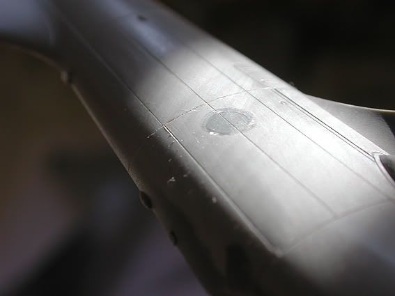

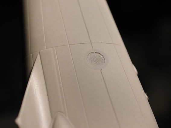

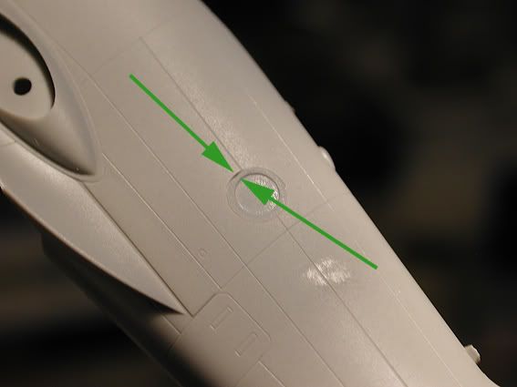

Here's one of the camera ports filled-in with super glue and sanded flat and rescribed.

Radish
QuoteShould the seat be all black?
IIRC the entire cockpit should be black  B)

Gekko_1
Ah well, maybe the RAN went for a more modern look! :lol:  :wacko:

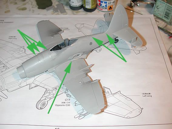

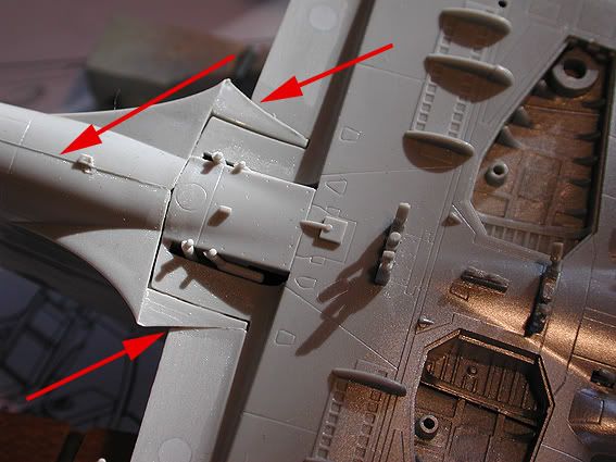

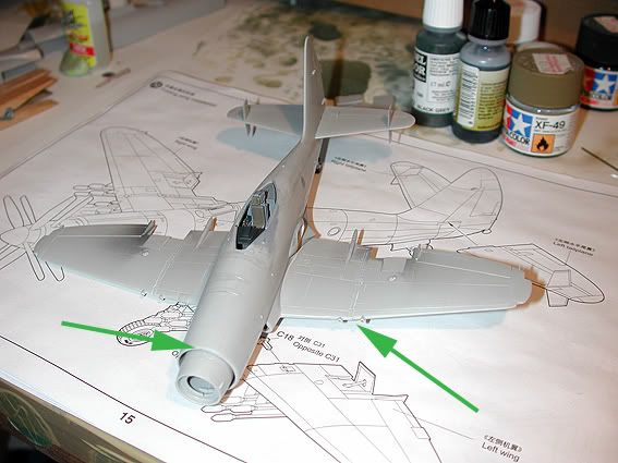

Again, remember this is a 72nd scale model, so in reality the gaps and fit problems don't look quite so bad in reality. I tried to align the fuselage a bit better on the rear of the underside, but it just would not stay in position without pushing the top out of alignment, so I opted the keep the top aligned and scrape and sand the bottom once dry. The other arrows point to areas to keep an eye on when gluing, they also can move out of alignment easily.
It looks like a lot of work to clean this area up, but it actually wasn't that bad.
Here's the underside of the nose, again, there's problems, but nothing too drastic.

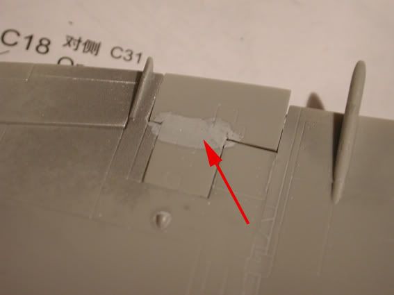

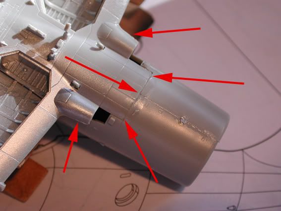

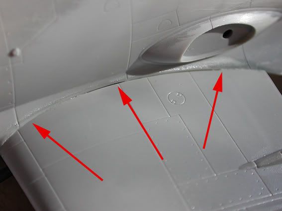

The wing to fuselage join had some gaps on both sides. An application of Mr Surfacer 500 filled the gap well; once dry a cotton bud wetted with metholated spirit was rubbed along the area to clean up the join. It worked well and didn't take very long at all.
Ahhhh, staring to look like a Wyvern now! The single arrow shows the wing join after the application of Mr Surfacer 500. The other arrows show where I had to do some re-scribing. After I was happy with the scribing I ran some Tamiya glue over the newly engraved lines.

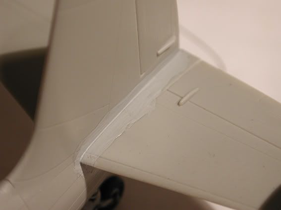

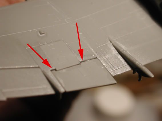

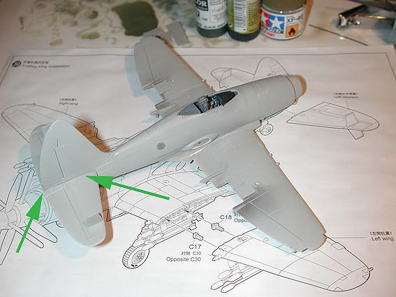

After carefully aligning the tailplanes I noticed gaps on both sides, top and bottom. Nothing too drastic, they'll get the Mr Surfacer/ Metho treatment tomorrow. Check the alignment at the back too!
If you look very carefully you'll see two small pin holes, these will be filled with super glue tomorrow. :ph34r:

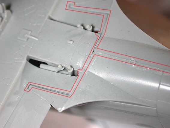

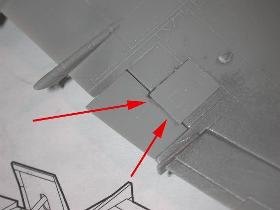

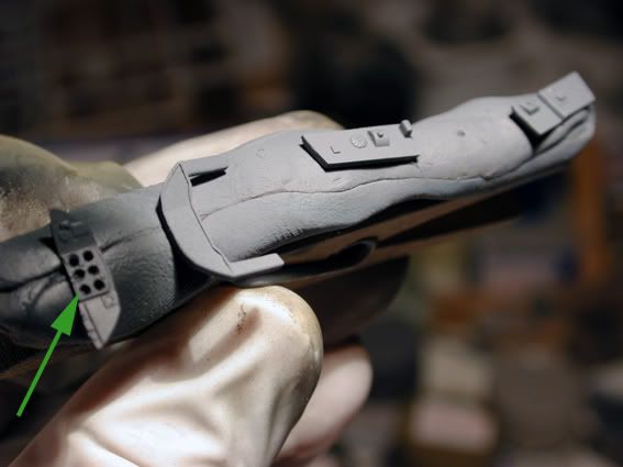

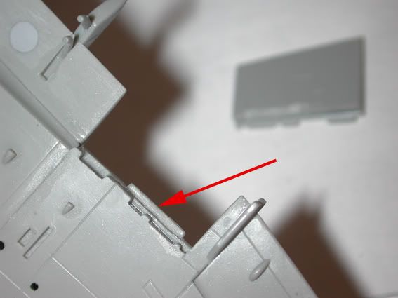

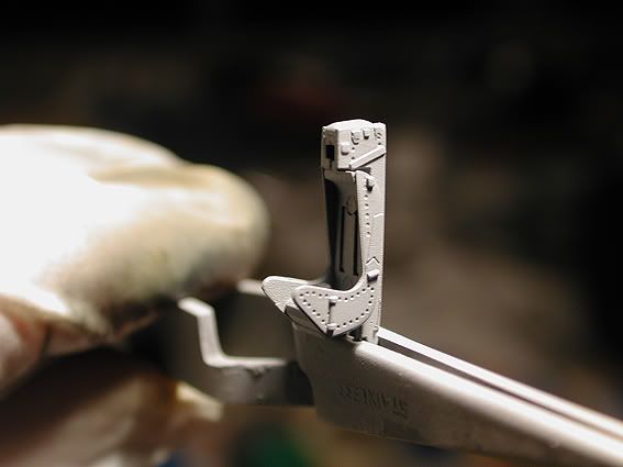

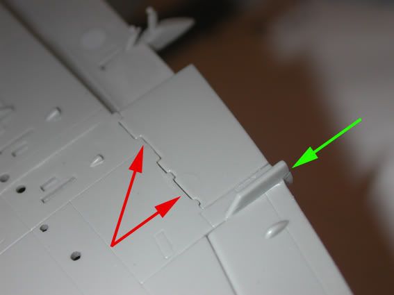

This little tab is the underside of part of the airbrake. I wanted to show the airbrakes "in" as every Wyvern I've seen shows them deployed, and I like to be different!  B) I should have thinned it down a little as it caused me problems, as you'll see!
Here you can see the area gouged out to improve the fit. It worked, but will require more work to tidy up. :dum:
At least the underside looks good :)  The green arrow shows something I may have missed! Amazing what these macro photos show up! :o
Although this shot shows what looks like big gaps, keep in mind this is shown at great magnification, after all its a 72nd scale kit, so this gap is actually less than half a millimetre and after filling, a smoothing over with the Mr Surfacer 500 and Metho treatment it will virtually disappear.

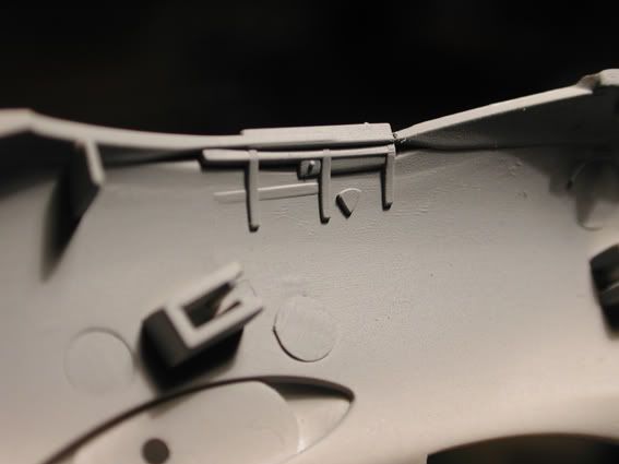

If an ejector pin mark like this will stop you from sleeping at night, make sure you get to it before closing up the fuselage. I'll sleep soundly :wacko:
