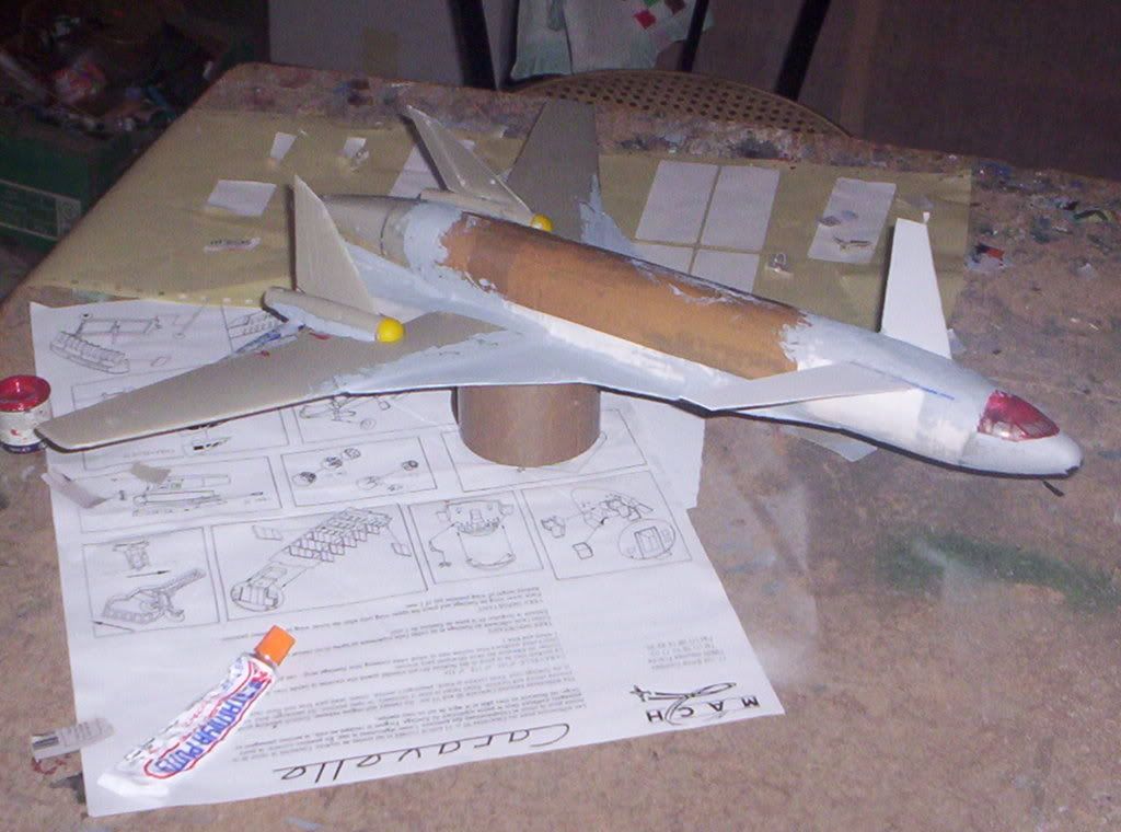

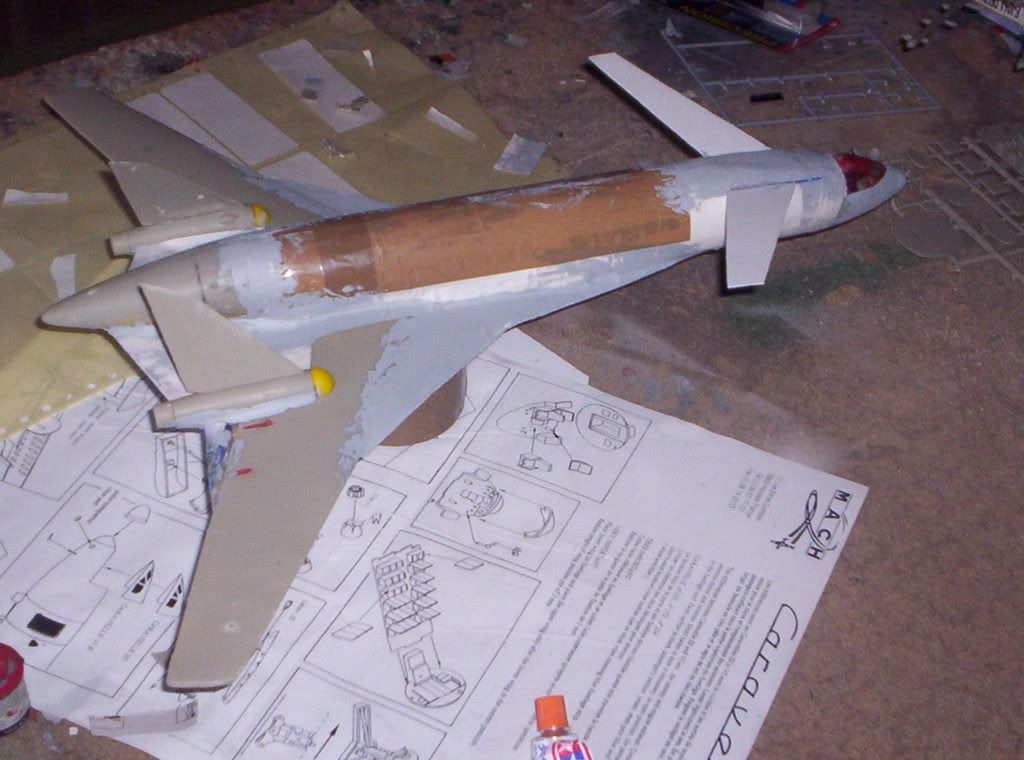

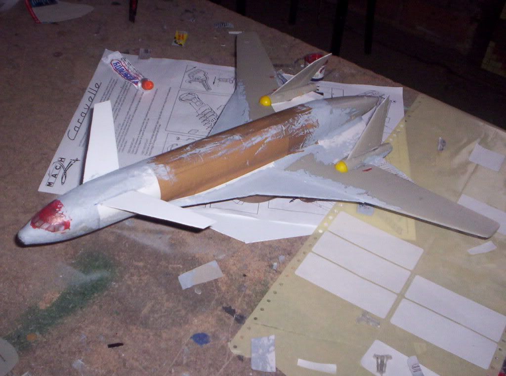

Archi, what a great shape! I like what you have done so far and look forward to seeing more :)

I've spread putty on the "LERX", to gave them volume (they were flat, because I've build them from  a styren sheet).
This cost me a whole tube of Tamyia putty  :wacko:  :blink:
I've bought strong glue this morning, so undercarriage is now on the way  :wub:
Thanks for all the cheers comments!
I've elected Mach 2 Caravelle as basis for two reasons.
First reason is,  its one of the rare -in my humble knowledge- 1/72 scale airliners (with Heller Boeing 707/ C-135FR/ AWACS).
I've also noticed that Caravelle cockpit is rather similar to the Sonic Cruiser in the sense that it is "blended" in the fuselage (no nose radome as in modern airliners).

Archi, if you're using styrene or cardboard (Cardboard, Yum!!!) to build airfoils, try this simple approach:
- cut two shapes (upper and lower) of the wing
- Laminate: at the leading edges, glue a narrow strip (or as many as you need) of material all along the wing span, root to wingtip
- sandwich the laminate with the corresponding top/bottom wing shape
- now you have a perfectly square leading edge, from the front, wich you can easily sand to shape.
- If the wing has a cambered/concave profile,  carefully bend it by hand
- Voilá, mon cherí amí, you have a wing without wasting putty!!!
