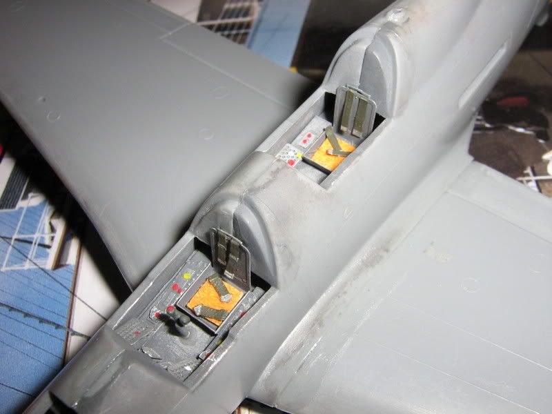

Hi fellows,

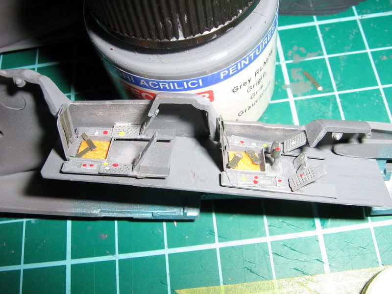

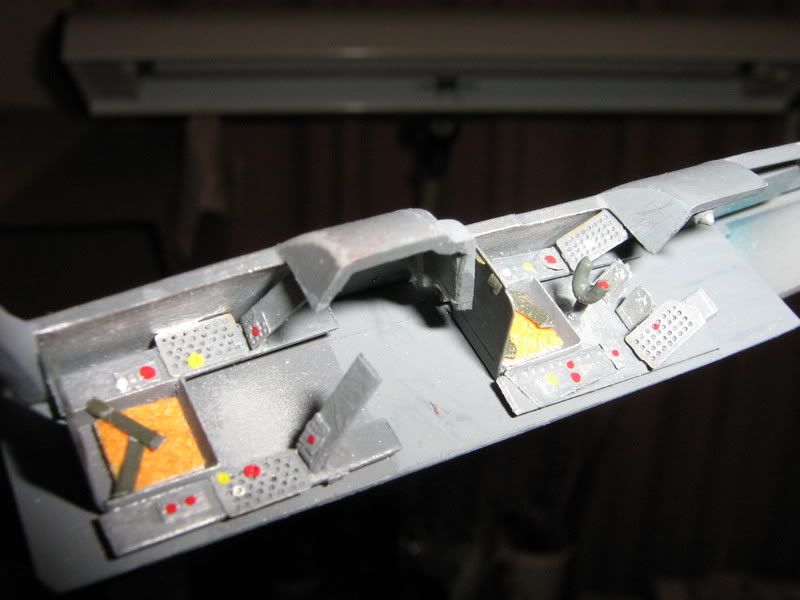

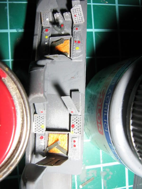

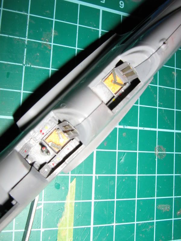

Some more photos of the two cockpits, now with a control column made of sprue and a bent guitar string, top E I believe. Seat belts made of tape and PE.

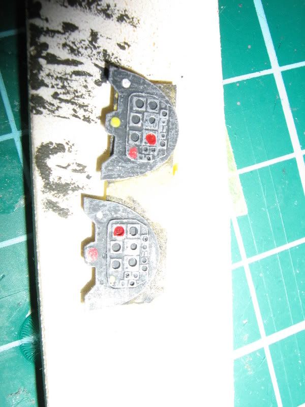

Alert readers of this threat may notice that I have added some pieces of PE from a Mustang fret and reduced in size the dabs of red, yellow and white on the consoles and instrument panels. They looked a little too cartoonish before. Even now they look grotesquely huge in the photos, but in reality are quite small.
The cockpits were weathered with a silver pencil and then drybrushed with silver and light grey.
Well now, I think I'm ready to close up the two fuselage halves. Hopefully the rest will be plain sailing.

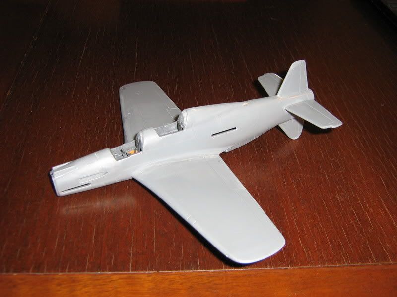

Hi fellows,

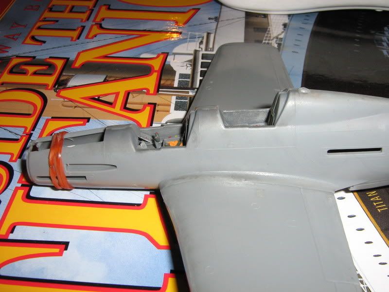

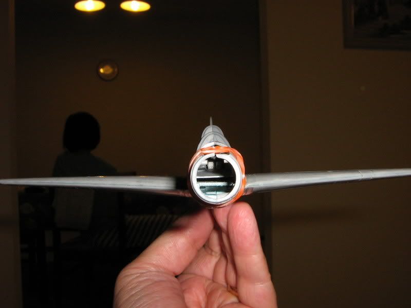

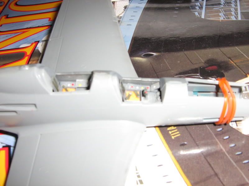

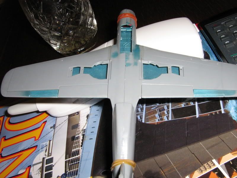

Here she is all buttoned up and with the wings on courtesy of Revell glue, Tenax and superglue.
First I've got to put a little weight in the nose and cement the nose guns.
Next comes the filler, sand, filler, sand dance.
Allan in Canberra

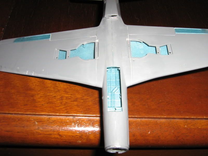

Looking good, Allan! I'm particuarly impressed by that Japanese wheel well color you used. It certainly looks striking on a Do-335. It's realistic details like that which turn heads.
Allan
Thanks Brian,
It's WEM Aotake, the blue-green paint that supposedly goes onto Japanese wheelwells. Actually there is a Japanese plane of some description in the Australian War Memorial here in Canberra which clearly has this paint on it.

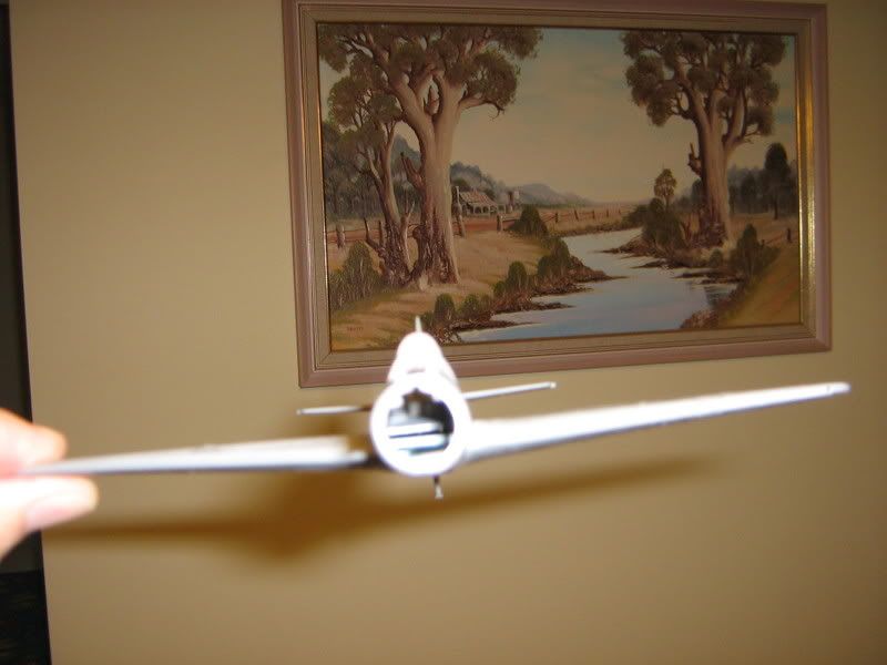

I'm not 100% sure but I tend to think that my Dornier should have a little more dihedral, but on the whole I'm satisfied with the way things have turned out so far.
It's the sanding routine that I'm not looking forward to.

Looking very good so far. You are correct about the dihedral, the Do 335 did have some, maybe a little than your model has.

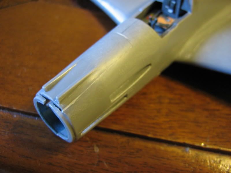

have done lots of sanding with three grades of sandpaper and will present more photos soon
Allan

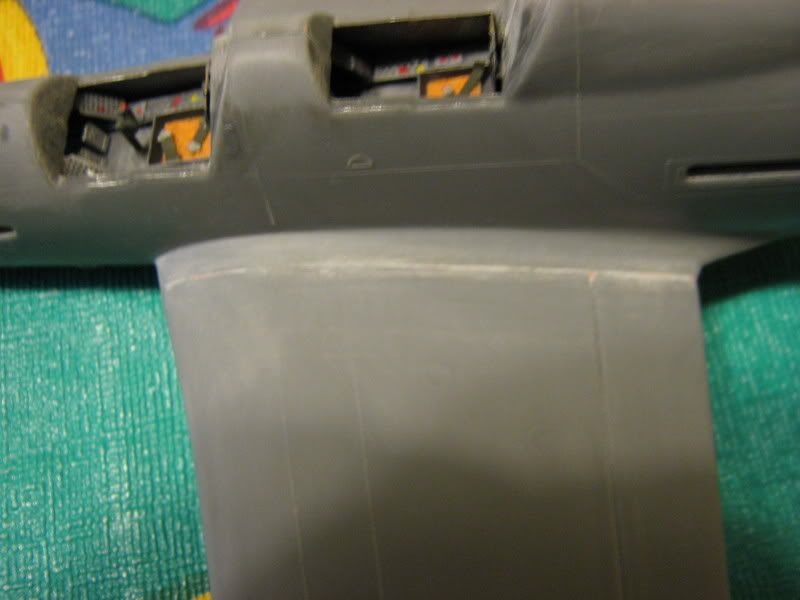

Hi fellows

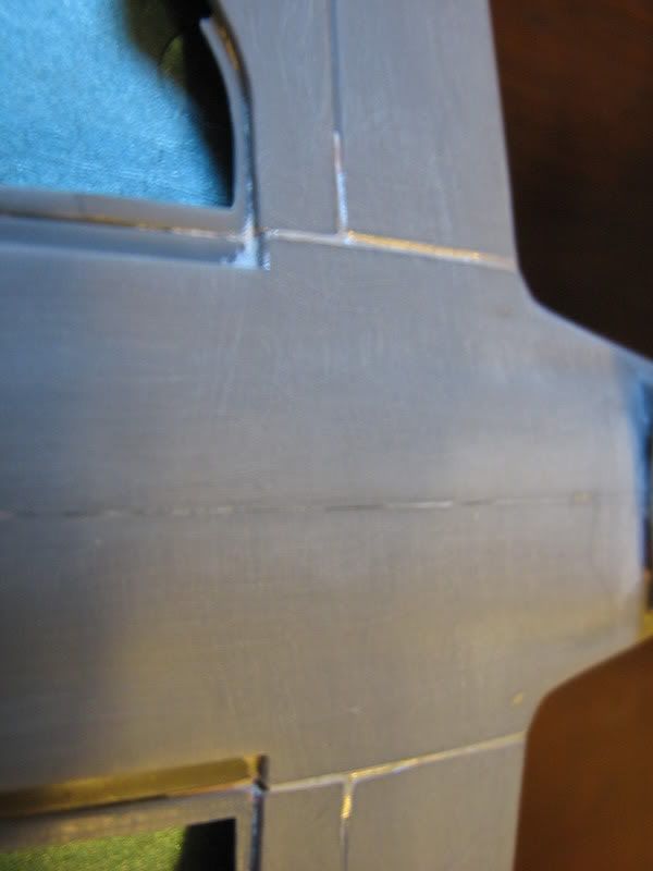

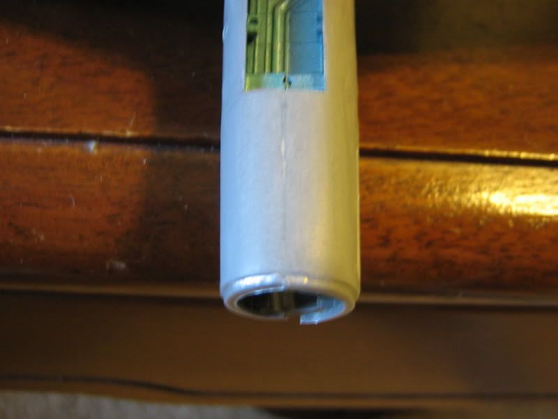

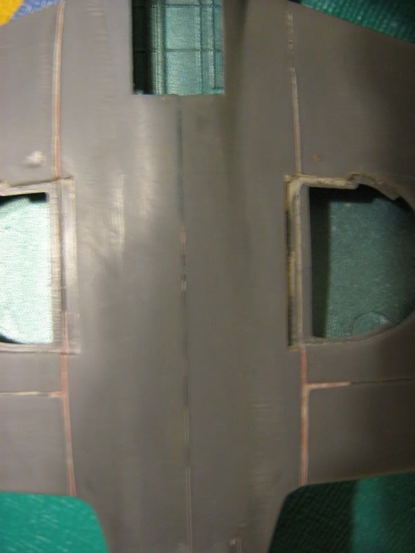

Here are some more pics of my Dornier in sanded and unsanded state.
We will have our club's annual comp this Sat and Sun and I have entered three of my Whiffs. I'll take some shots of the proceedings and post them next week. Also I will look for some sort of torpedo to put on my Dornier, but it'll have to be a short one. Also some good Japanese hinomarus and squadron emblems.

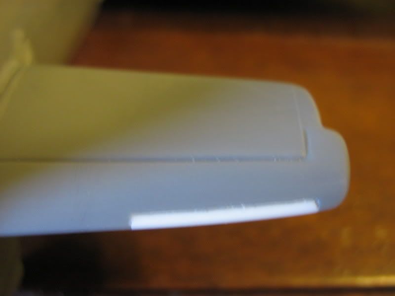

On one of the tailplanes there was a small section of deformed plastic, so I cut it away and replaced it with white plastic card. The addition will be quite unnoticable once the paint has been applied. Still have a little sanding to do around the fuselage to horizontal stabilizer joints.
I think I used 400, 1200 and 1600 grade sandpaper in between dabs of silver paint. I also used Mr Surfacer 500 and found that if I let it dry only about 10-11 hours it was unbelievably easy to sand away.
Allan in Canberra

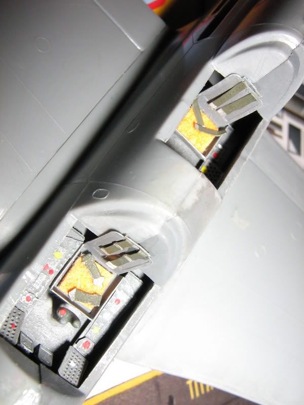

Do you see the area behind the seats with the very visible seam?   I think I might cut some plastic card into shape and position it behind the seats to disguise the seam
Allan in Canberra
