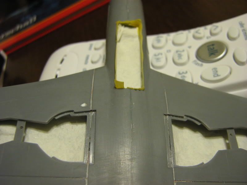

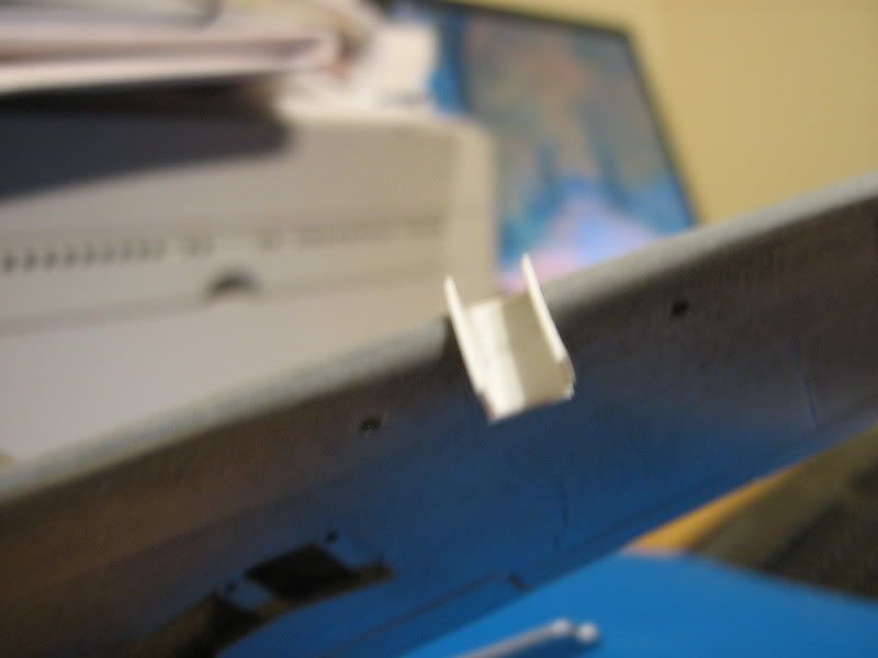

Wow that's some great progress there Allan! You could go the plastic card route on that seam or just use a little dab of putty. I'm really impressed how you fixed that tailplane. That's some very professional looking work! Thanks for keeping us updated on this cool project!
Coming along well, Allan !  If you have a small fingernail file, the metal kind, you could smear some filler back there, use the round end of the file to smooth it out, and then sand it once dry...it might be easier than having to cut card, and then fill and sand the edges of the card.

That seam should not be that hard to fill. Greg pretty well summed up what I was going to say anyway.

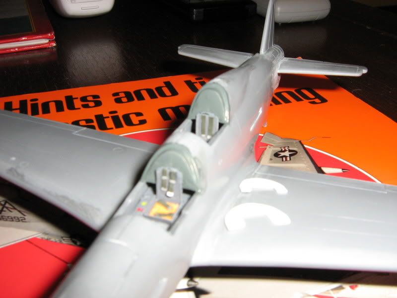

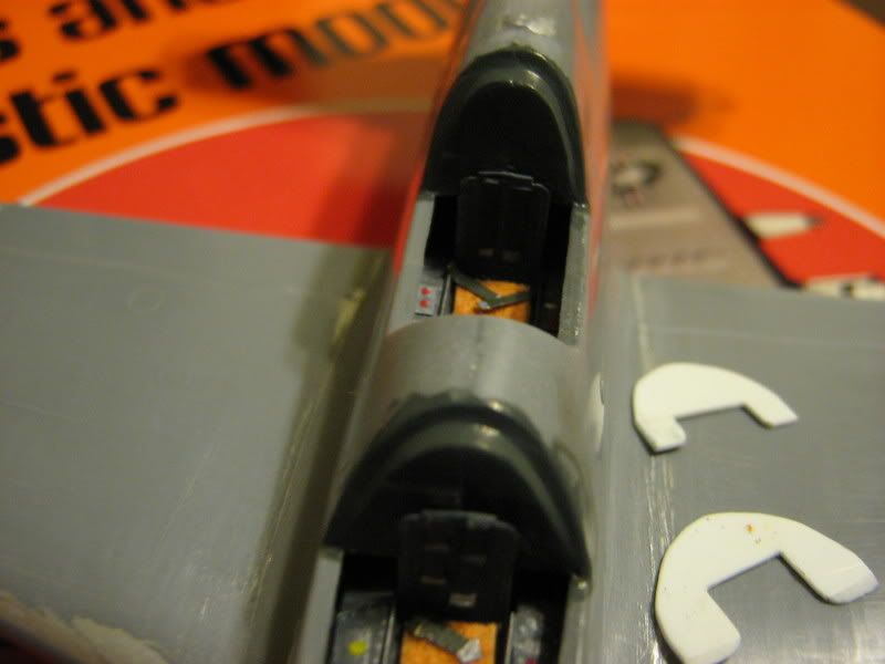

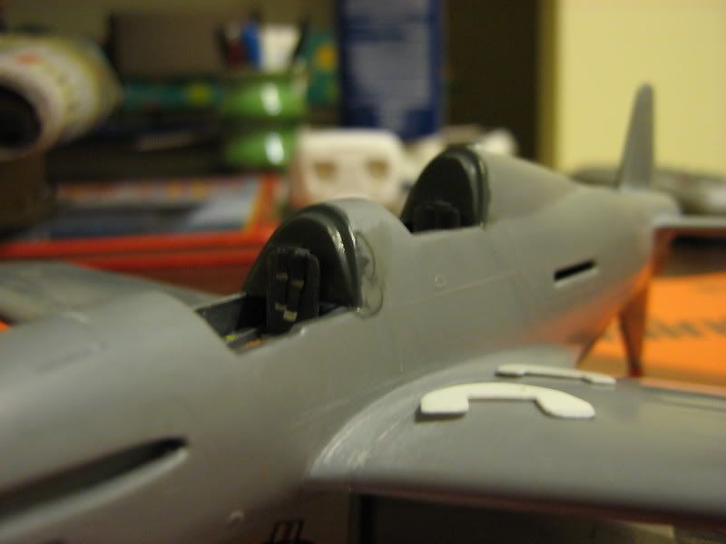

Thank you for your kind comments. I've painted the area behind the seats dark gray and have fashioned two pieces of plastic card to place over the seam line. I had to make a cutout for the seatback otherwise the thickness of the card would have pushed the seat forward. I'm still not 100% if I will actually use these pieces of card. We'll see. I would really like to make up some sort of headrest using thin strips of card.

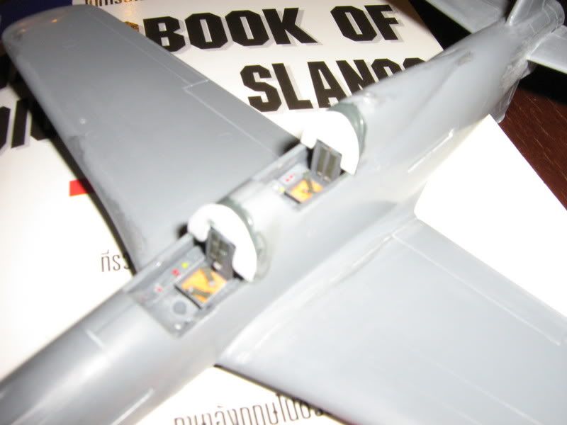

Here's my Dornier with the pieces of plastic car attached firmly with lots of Revell glue. Have to sand them into shape next.

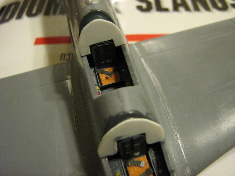

plastic card more or less sanded into shape

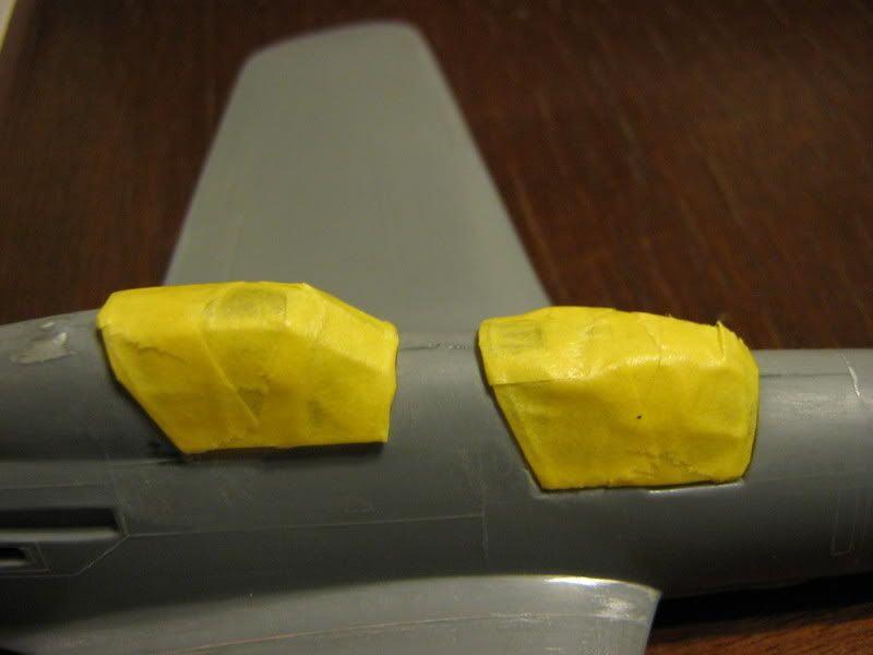

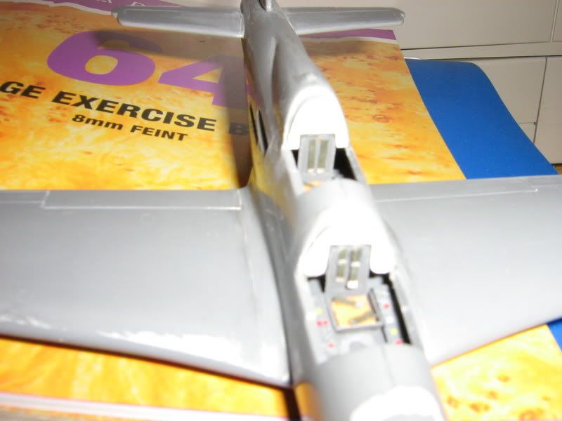

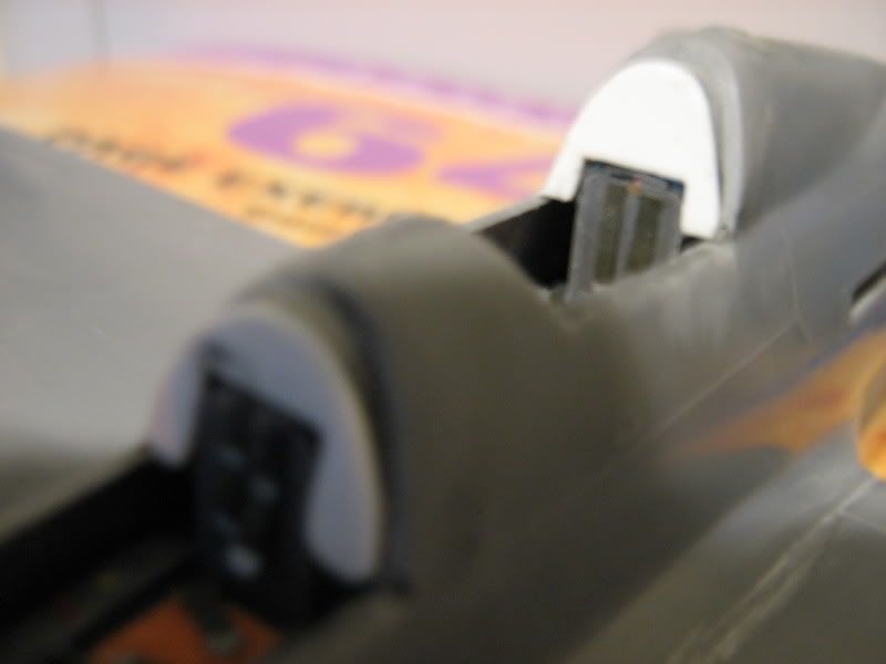

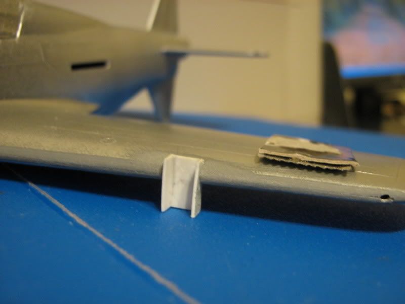

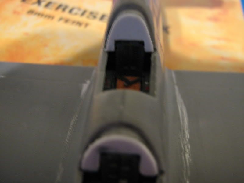

thanks Brian and here are some more shots prior to undercoating in silver, which I hope to do today
later on I'll remove the tape from the canopies, mask them, white glue them to the fuselage dnd then final paint it

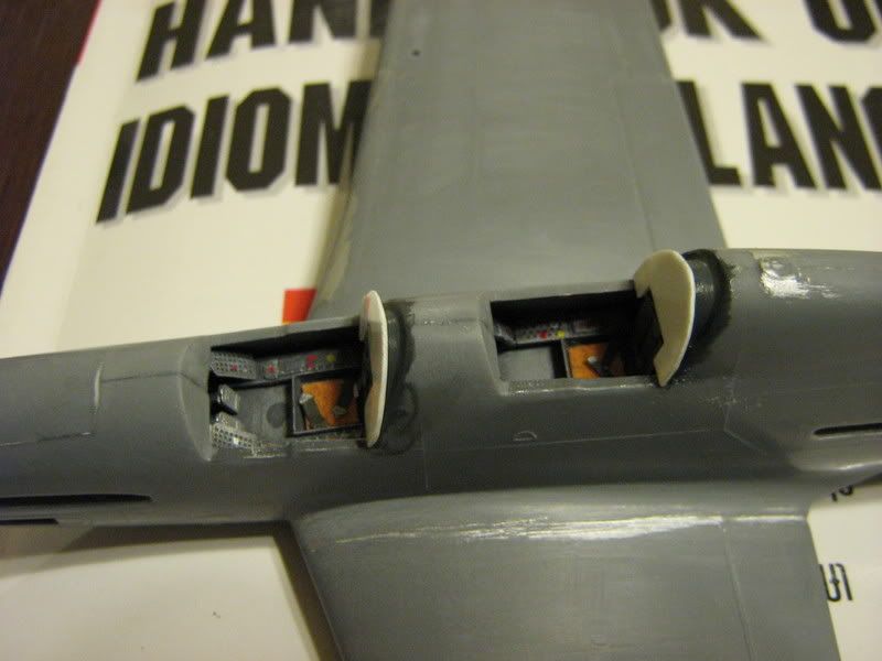

Allan
Hi fellows

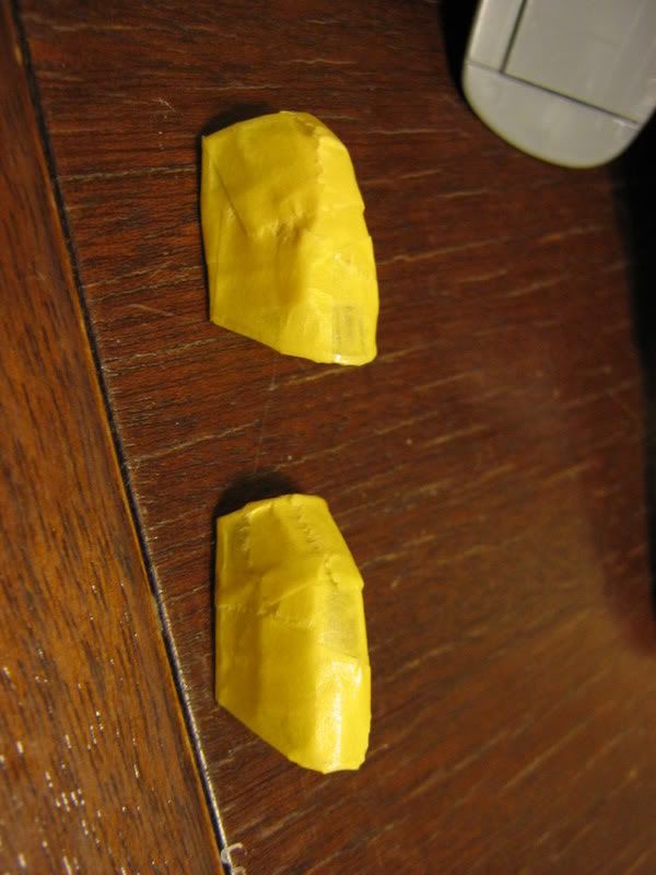

I've put some silver on the plane as sort of undercoat, but am uncertain whether I will attempt this color on the final plane. If I do, it might be better to rattlecan it silver as I don't seem to be able to apply the silver paint with my crappy airbrush too well. I might abandon silver and go with green upper and grey lower.
We'll see.

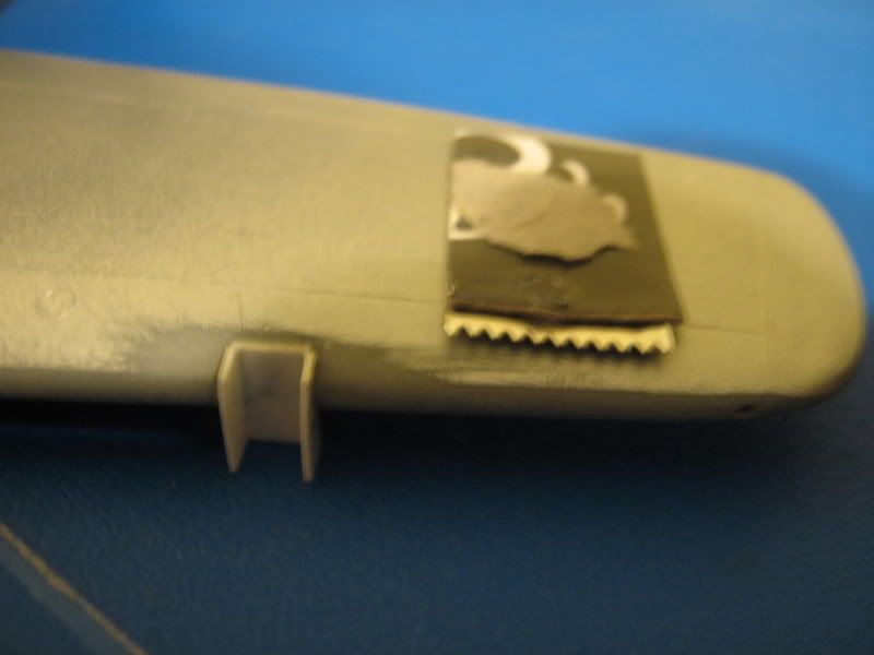

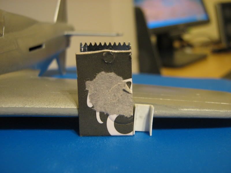

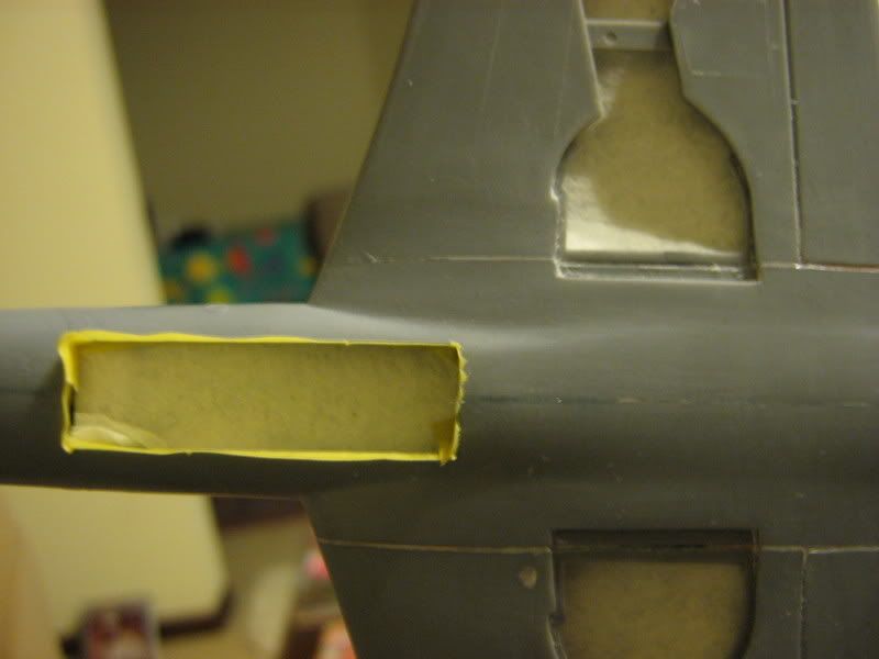

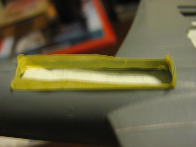

As you know, the Arrow came with a wing leading edge light, so I've cut and sawn one out and lined the resulting hole with plastic card. Later I'll sand/cut it into shape and use Surfacer 500 to smooth things out. I think the head of a pin might past muster as the actual light, but I'm in need of suggestions on how to cover the hole with something transparent. Sticky tape perhaps?
The saw I used was cut from a box of aluminium foil and it proved to be very useful.
Allan in Canberra

HOG
Hi Allan
For the leading edge/landing light how about a piece of clear sprue. A slightly drilled hole in the back can represent the bulb.
Paint the back silver and fix with clear glue and when set sand to leading edge shape and polish to regain transparency
Regards Gary[8-]
