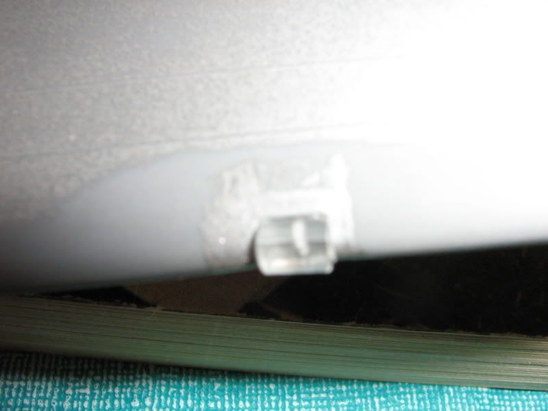

Wow Allan this project is coming along very nicely indeed! I second the suggestion about using clear sprue. Best method I can think of to scratch landing lights.
HOG
Hi Allan,
Just to add that you may need to shape the back of the sprue before you fix it in place as the 335 had a `square` shaped light. Below is a pic of mine in 1:48, For the bulbs in this I used 2 small ball bearings but in 1:72 a drill hole will prob` be easier.
It`s not very clear but hopefuly it will convey the method

Allan
thanks fellows
Apres sanding, although if truth be told I have since added a tiny drop or two of 500 to help smooth things out.

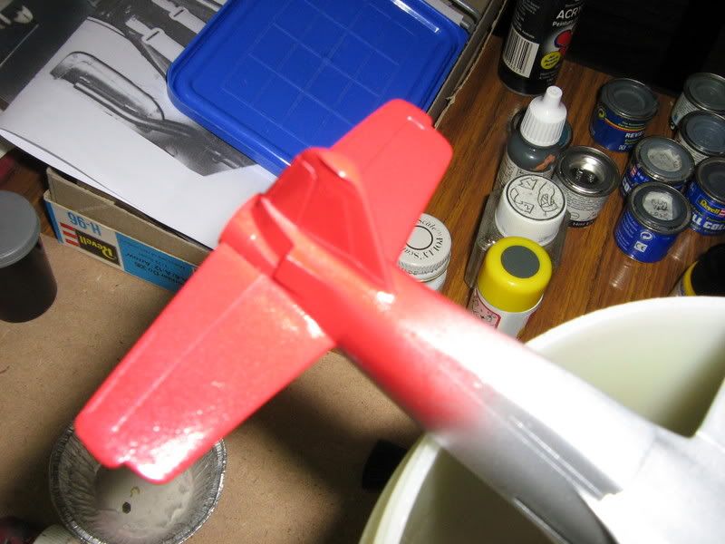

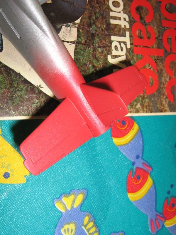

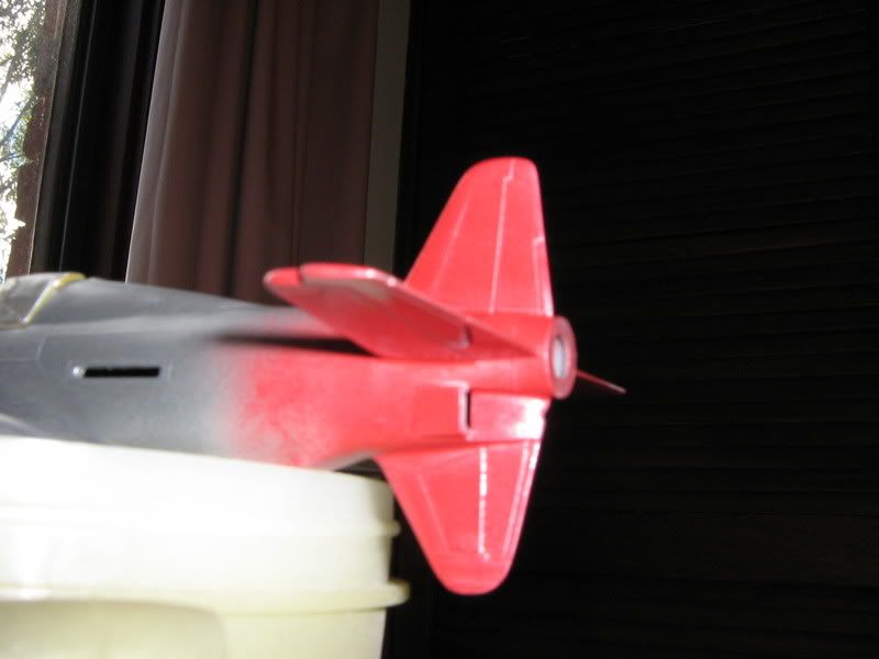

Allan
first coat of red on the tailplanes
it's Humbrol 19 gloss, which I don't really like as I don't like gloss paint...give me matt any day, but gloss is all I had
mixed the paint a little thin so will have to put on another coat in a few days
Allan in Canberra
Allan, you may not be too fond of the gloss but the red tail looks pretty cool, you could always hit it with some dull coad after you get all your decals on.

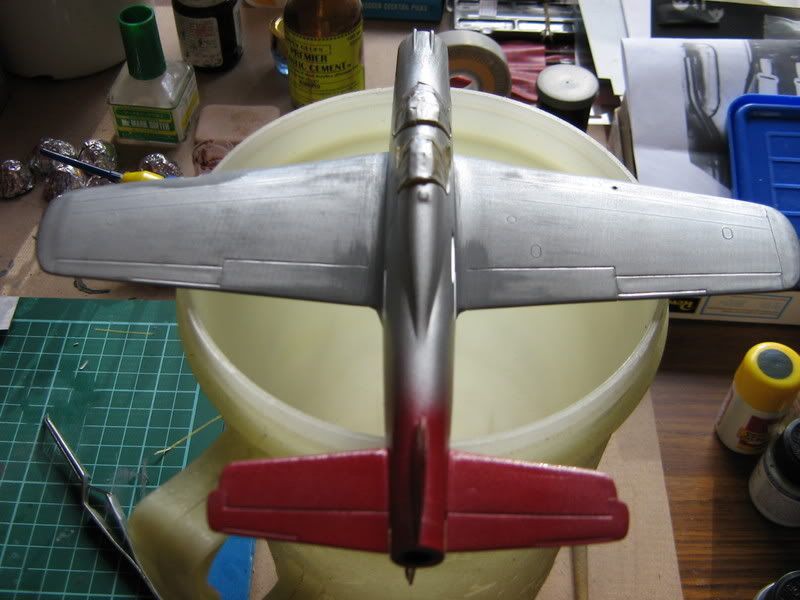

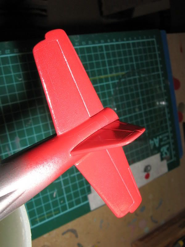

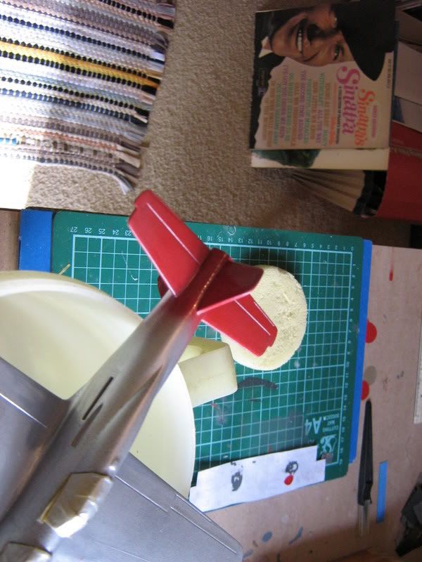

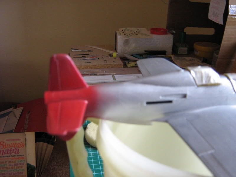

Allan
second coat of red applied the other night
then some Testor's Dullcote the next morning (this morning), but no photos of that just yet
so here's the second coat of red, still glossy
it went on pretty well and dried a lot faster than using a brush
next I'll mask off the tailplanes and then apply some flat grey primer
white backgrounds for the rising suns, fus and wings, next followed by yellow for the wings' leading edges
then silver from a rattle can, I think

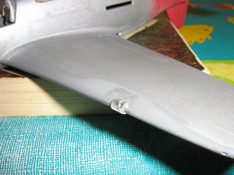

Hi Allan,

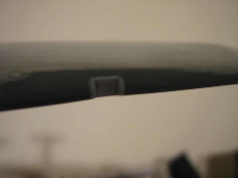

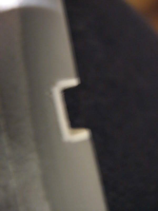

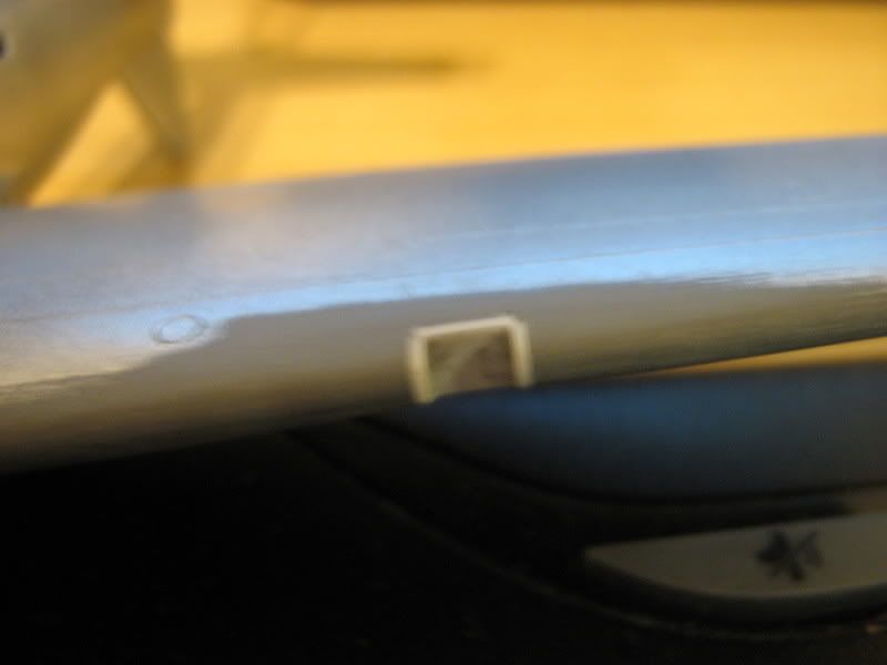

I see now you`ve got to the painting stage, and I hope I`m not interferring but it might be easier to fit that wing light soon as it may need sanding to the shape of the wing and polishing to return it to transparent state.
Looking good so far and keep the pics coming
regards Gary[8-]
(Ralph Waldo Emerson )
Allan
thanks for the tip Garry...much appreciated
and what do you suggest I polish it with apres sanding?
Allan in Canberra
HOG
Hi Again Allan,
Normally I keep on using higher and higher grades of wet n dry used wet up to around 2000 grade. Some times a final polish with a piece of denim or similar material helps or another old favorite of mine was Flixigrit. Similar to wet n dry paper but had a plastic backing paper and went up to seriously high grade no`s for polishing but DON`T use a dremel or similar. These I find tend to burr the surface even when used at the slowest speeds.
regards Gary[8-]
oh just remembered Johnsons klear brushed on as a final coat helps as it fills any small gaps between the surround and the clear piece.
Allan
thanks Garry   great tips and I'll get onto it pretty quickly

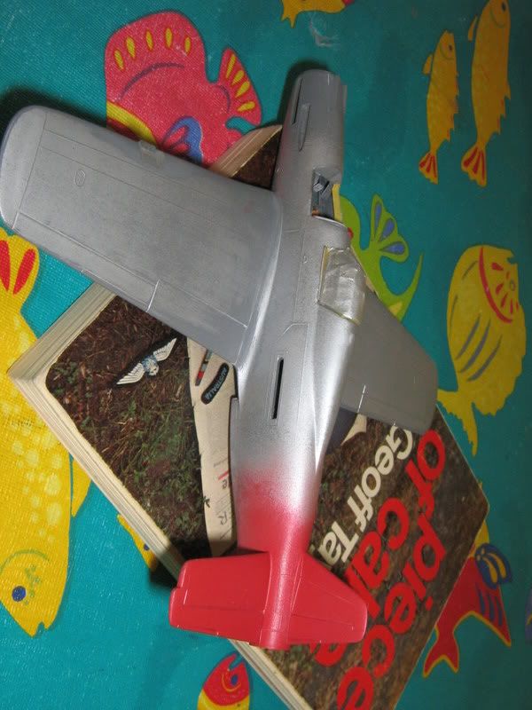

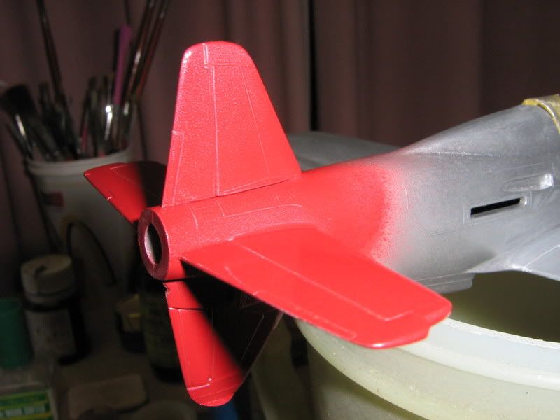

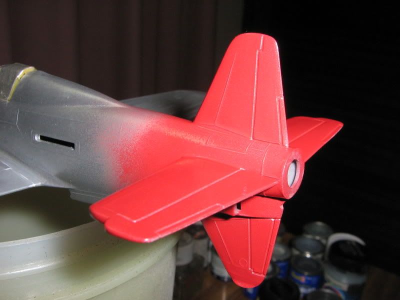

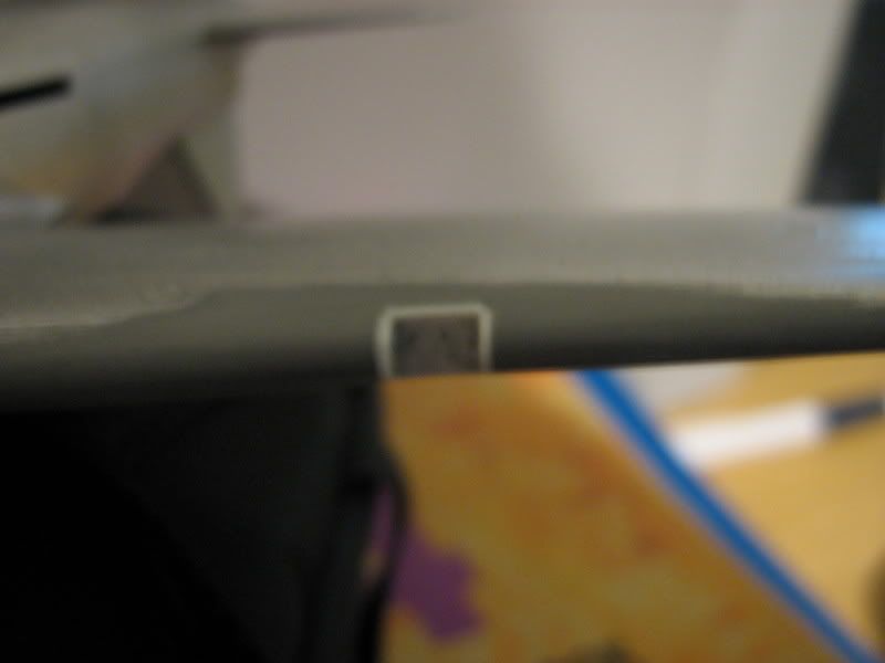

Allan
a few more photos of the Dornier with red tail and wing light ready for sanding
