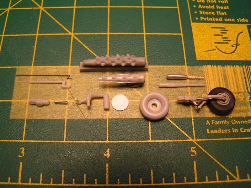

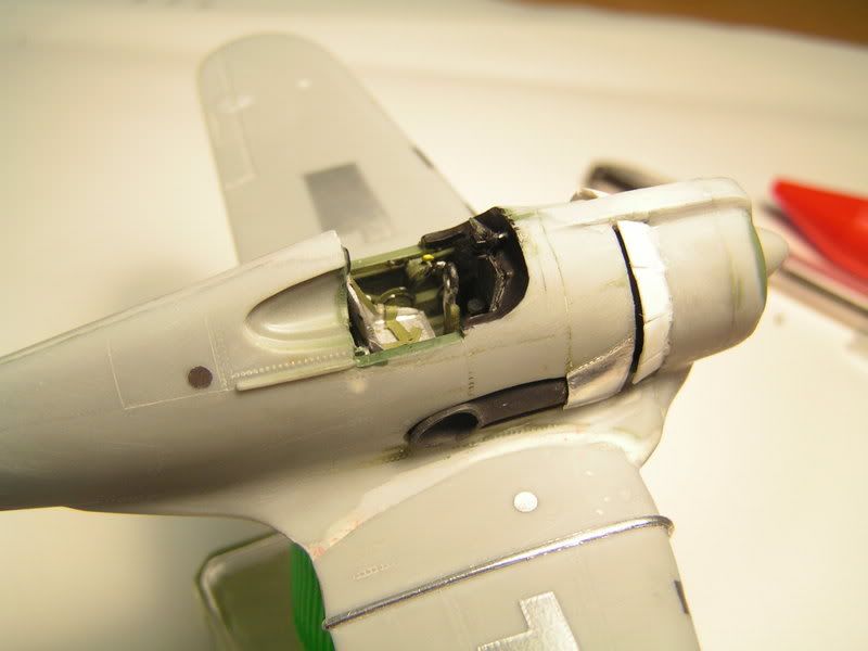

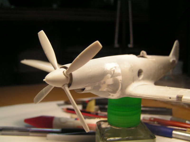

Hi all, well i have managed to get a little further with the Boomerang and turbo Frank [Frankenplane?] ..I still dont know about the frank,can't figure out if the new profile i have created is to my liking or not; it looked good as a hand drawn sketch, but in 3D it is another thing..still it is growing on me and once a bit of paint is slopped about i;m sure it will be o.k.
Once the main engine was aligned strips of 10 thou sheet were used wine barrel style to form the new forward panels then LOTS of sanding,prime ,sand and so on,thanks to Captain Canadas suggestion ,a large bottle of Green Ginger wine and a Butt Hole Surfers c.d. made this the most plesant of tasks. :cheers:
The boomer too has been a ton of fun,the cooling gills looked pretty daunting at first but turned out to be fairly straight forward, i put a strip of 10thou plastic card on the inside of the cowling to act as a bench and after the individual peices had been rolled to shape they were glued in place.
the under carriage is vastly improved by replacing the oleo slider with a peice of stainless steel tube as found in the revell type glue aplicator bottles,this is realy easy to do,just drill out either end of the u/c units as deep as possable and allow plenty of length on the tube, the pitot tube was made from an old mandolin string and a scrap of photo etch, the cannon barrels and tubes were built fron a length of aluminiun tube turned down in a drill and spare resin barrels from the Special Hobby Firefly kit, also for comparison is the Highplanes resin Hedgehog exhaust wth the Airfix offering.
Next time i should have some paint on something. till then thanks for looking and as allways comments and critiques most welcome.

Now the Boomerang, on the other hand.........uhhhhhhh....Mmmmmm....... :wub:  :wub: I might need both hands for that one ! Awesome job on the details. pretty amazing for that small scale ! What did you do with the wing ? What is that silver thing ?
