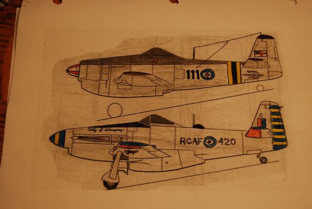

Yes.....my Sea Boomerang is all but done. But I didn't paint it too much tonite, as I was busy daydreaming. To relieve the stress of the Stanley Cup Final ( you guys have no idea what it's like to be a CDN hockey fan this time of year..... ;) ) I decided to do a little colouring. Yes, it's a photo from a download from the site of a scan, so the quality is poor....but you get the idea. Once again, Bluntman...thanks !

WOAH !!CAPTAIN !! SCHWEEET!!,those are just crying out to be built :cheers:

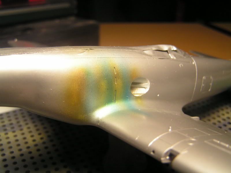

anyway,just a couple of quick shots, i got the first coat of Tamiya x11 on and as expected found a couple of nasties here and there ,so sorted those out and got a nice clean silver finnish to work on,i had allready sprayed and masked the black anti glare panel,but still had no real firm direction to take on the cammo. i wanted to have a go at the 'vegemite experiment' so i could to get a typical Japanese random demarcation line,also i felt i needed to do something about the exhaust to make it blend in a bit better,time for another experiment, i sprayed a couple of bands of clear blue,clear orange and Tamiya smoke thus,

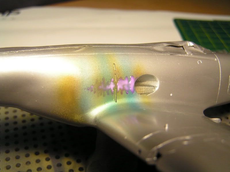

then some Maskol like so,

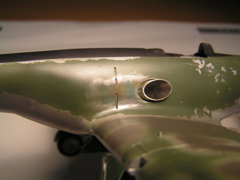

to try and get the effect of a hot turbine exhaust like this,

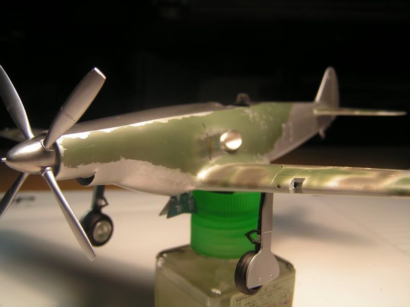

The rest of the airframe was masked with tape and vegemite,which i found great for making worn paint and scratches, and sprayed MM Japanese army green

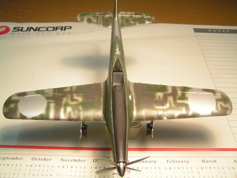

On the upper surfaces i drempt up a roughly geometric design with maybe 20% of the natural metal showing,again Japanese army green and u.s. helo drab,

That top view is plain evil!
