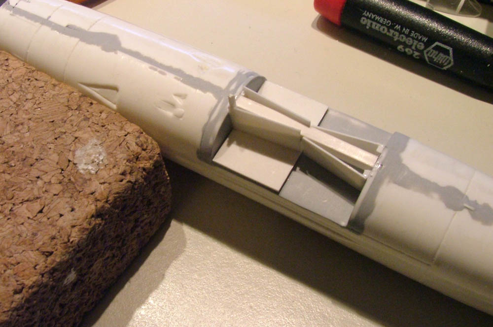

Why build the excellent Freightdog kit when you can build the old Maintrack vacform instead?  :dum:

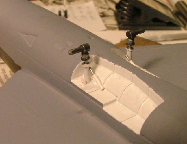

Don't like the wheel wells, so I'll remove them and build new ones:

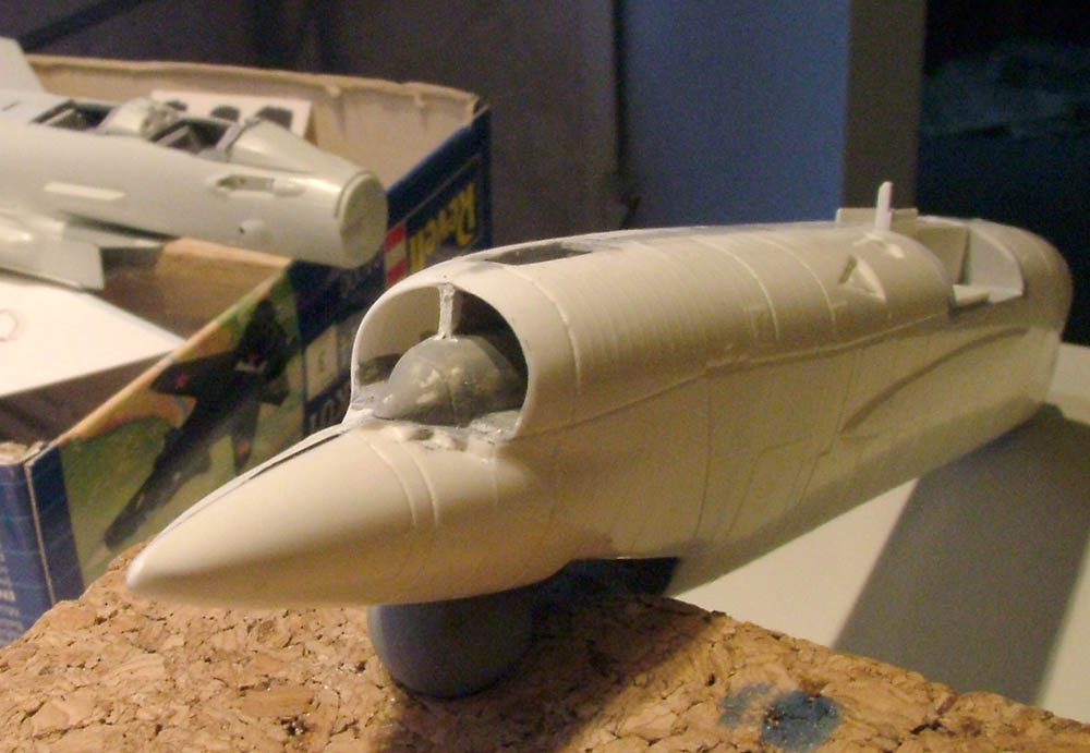

Front is missing the (vertical) intake splitter:
The rear end has rounded edges that should have been sharp:
Still, I'm enjoying the engineering challenge. I'll think twice before starting on another kit that needs this much work, though...

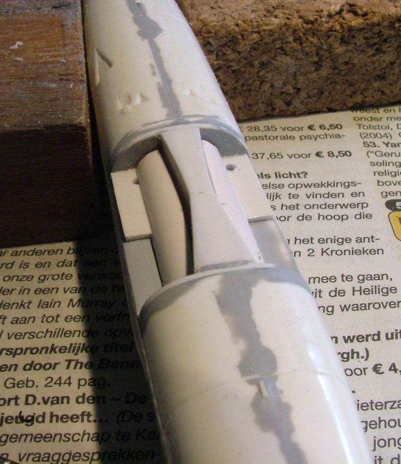

Studied the drawings again, and noticed that my earlier idea was off a bit:
The area around the rocket exhaust also needs changing, but I don't know yet which drawing is correct...

The vacform itself wasn't as difficult as I expected. I built the airframe in a few days. You just need to spend a bit more time test fitting than with an injection-moulded kit.
It's the modifications and added detail that complicate things.

How the heck did you do that?!   :blink:
The last pic, you mean? That's a section of styrene tube I cut into four parts (giving me 90-degree arcs). File them down a bit, and they fit the existing structure.

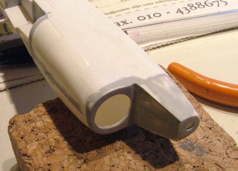

Changing the rear end so the rocket exhaust is flush with the body:

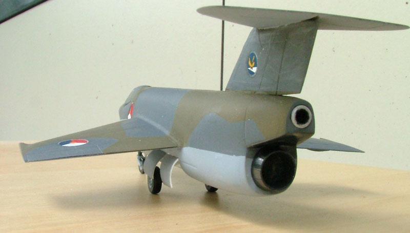

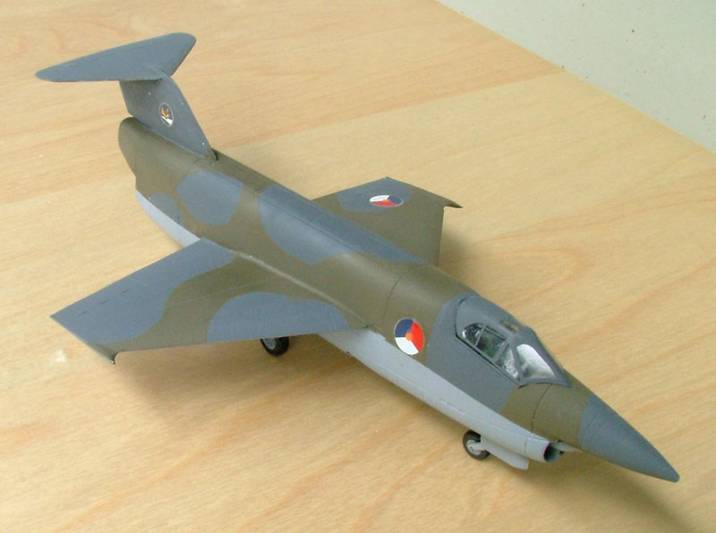

:dum: I just realised I never posted pics of the finished model. My excuse was that I still haven't found decals to create the serial numbers, etc. But I've decided to declare victory and move on, so here it is:
