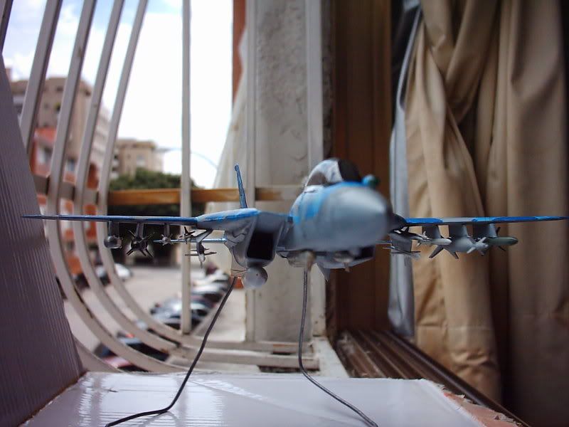

Warload: (Centerline rear-2 SurfBoard Hypersonic Missiles)

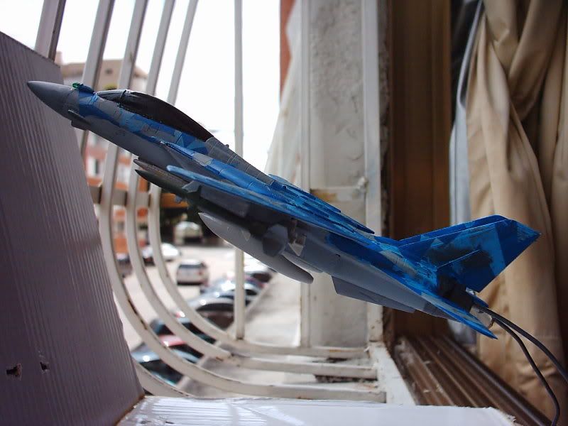

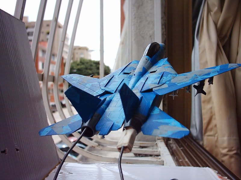

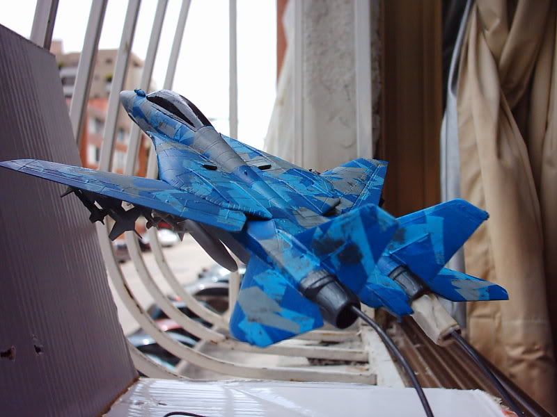

I'm not an accomplished painter, so this build was something of a practice. The splinter is THE scheme I like the most, but I have never had the nerve to try it. Mainly because I only paint with brush.
This time, I took the leap of faith and painted the 'Cat's undersides with Terstors' light Ghost Grey and the Upper Surfaces in Dark Ghost Gray, both Enamel.
Then, with 3M tape in hand I started the first layer of masking. I Used a trick: Everything under the tape is Grey.
Then I applied the first layer of blue (Acrylic Vallejo Deep Sky Blue) to all the surface, skirting with the paint the taped areas.
Then, let dry, and taped again, everything under the tape is clear blue or grey, and then applied the last coat (Vallejo acryllic Medium Blue)
For weathering, I didn't want to apply a wash, so I took graphite and with a cotton piece, smeared the dust all around, but OH!, the finish is blackish, but shines under the light.
So I took Acryllic Dark grey and diluted it to form something like a wash and applied it generously, washing all the excess gaphite off and pouring more of the solution on top. And let dry in front of an electric fan.
Simple huh!  :huh:  :banghead:  :thumbsup:

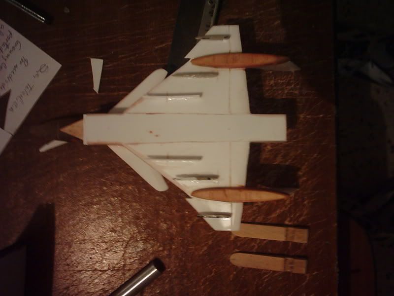

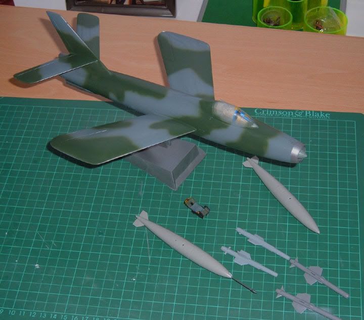

Mav, those SurfBoard Missiles are The handles of a wooden clothespin, sanded to shape and drilled to make intake and exhaust. The wings are two little pieces of plastic card.
I made them for my SnakeBat, see at the bottom of the image:
Beautiful, Eh?! :wub:
