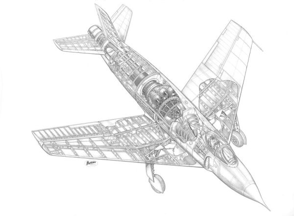

And a draggy fuselage that was a hangover from the bulky centrifugal engine used by the Attacker, one that was also double skinned and vastly over-engineered = heavy, as opposed to the Hunter which was intended for the slimmer Avon from the start.

The engine is mounted so far back in the fuselage that a Pegasus mounting is
questionable.
Pegasus
Type: Twin-spool turbofan
Length: 137 in (3.480 m)
Diameter: 48 in (1.219 m)
Dry weight: 3,960 lb (1,796 kg)
Avon
Type: Turbojet
Length: 126 in (3,200 mm)
Diameter: 35.7 in (907 mm)
Dry weight: 2,890 lb (1,310 kg)
Perhaps a low-bypass version of the Avon?
This is WhiffWorld, just move it forward............  ;D ;D
