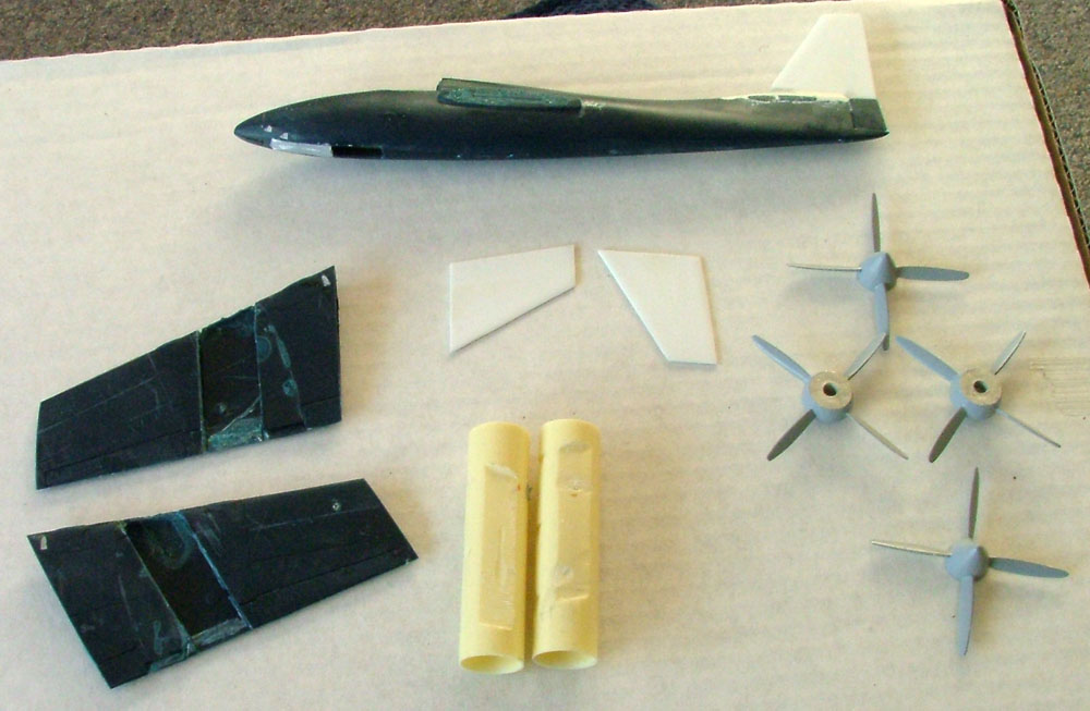

For this build, I've decided to mangle one of the aircraft on my rubbish pile:
It'll get new engines, a swept wing and assorted other goodies. I built the Tigercat when I was 10 or so, hence the curious paint scheme. I'm going to try and strip the paint, we'll see how that goes.

To my surprise, the paint is coming off like a charm. I'd expected 30 year-old Revell and Humbrol enamels to be pretty much indestructible, but it comes right off when sprayed with oven cleaner.

All the ingredients are present, and I'm almost ready to assemble the plane:
